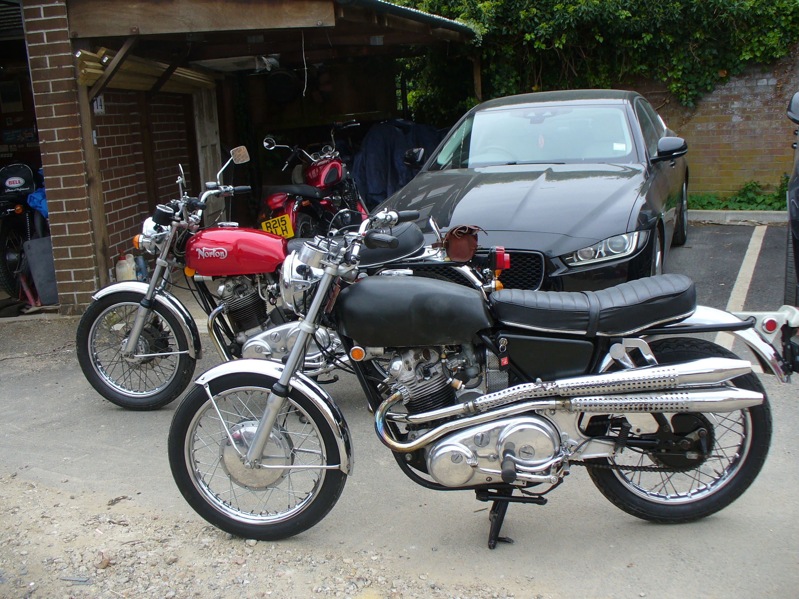

Image of what it is and what it should look like.
I am assuming S code/Roadster bases are interchangeable

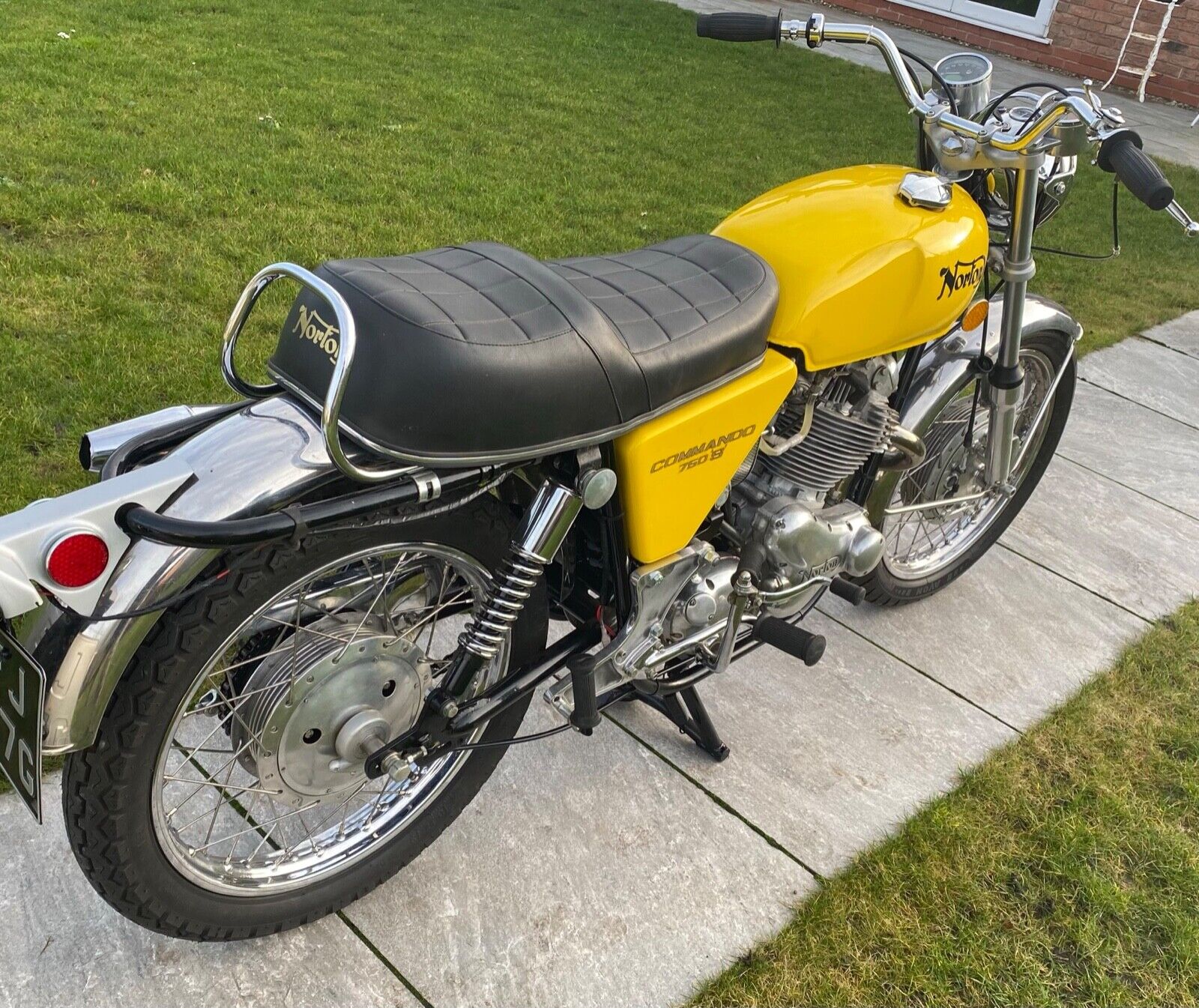

The later Roadsters have side panels that have a flat top, the seat base may have changed at that point as the front part of the base could then be flatter too. If the yellow bike is of your new seat I would keep it, at high speeds and high acceleration those high bars put a lot of wind pressure on your chest and the stepped seat will mean less need to pull hard on the bars to stop you slipping backwards. I have several seats for different tanks and ride requirements so no harm in having a new genuine seat as well.

Thanks John. I just love that early thin banana shape for the seat. A 2nd seat could be a good idea rather than swapping the cover and foam.

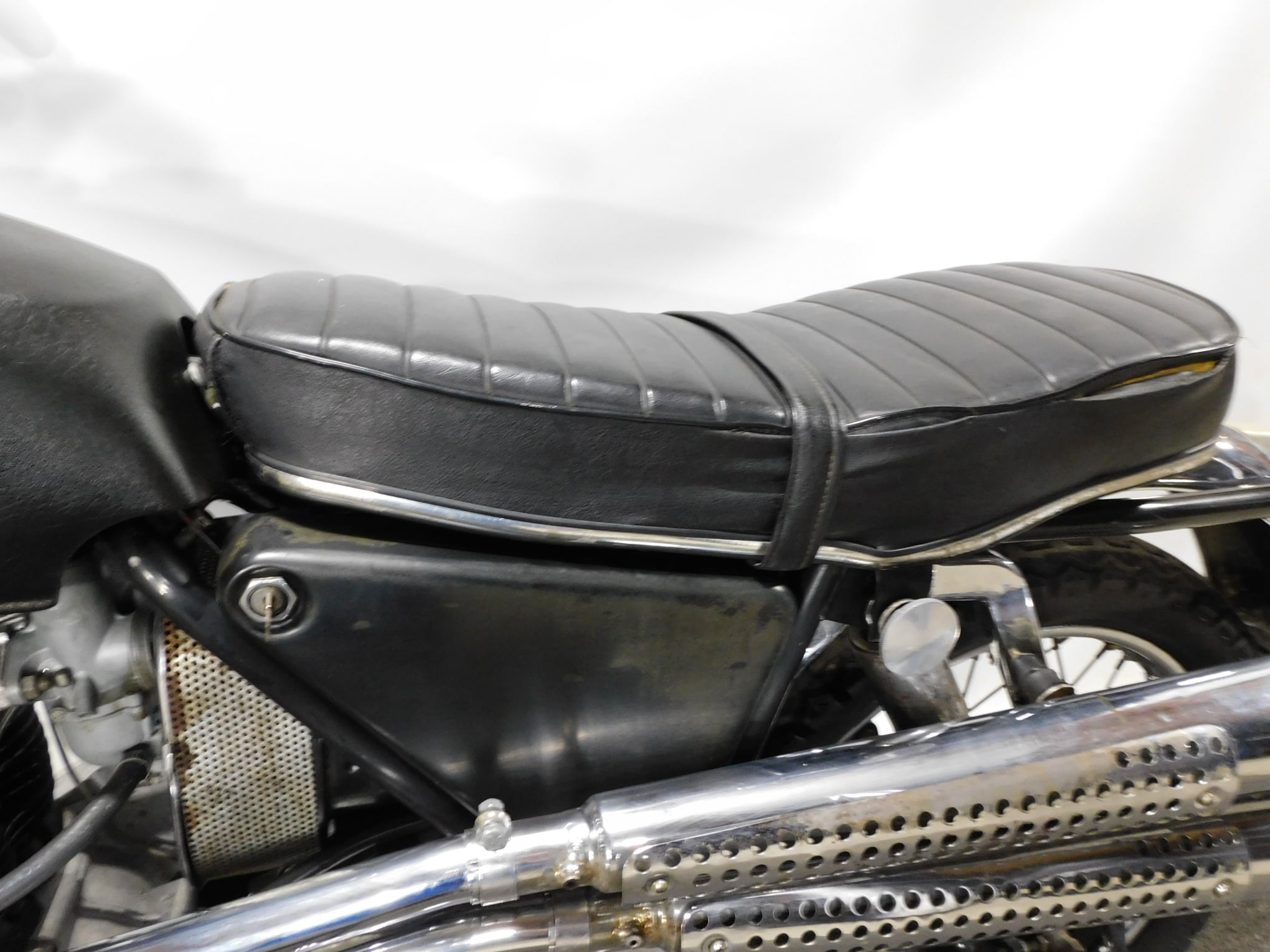

The one on the 2nd image is from my 69 and has a steel base. It is a December 69 build date though.

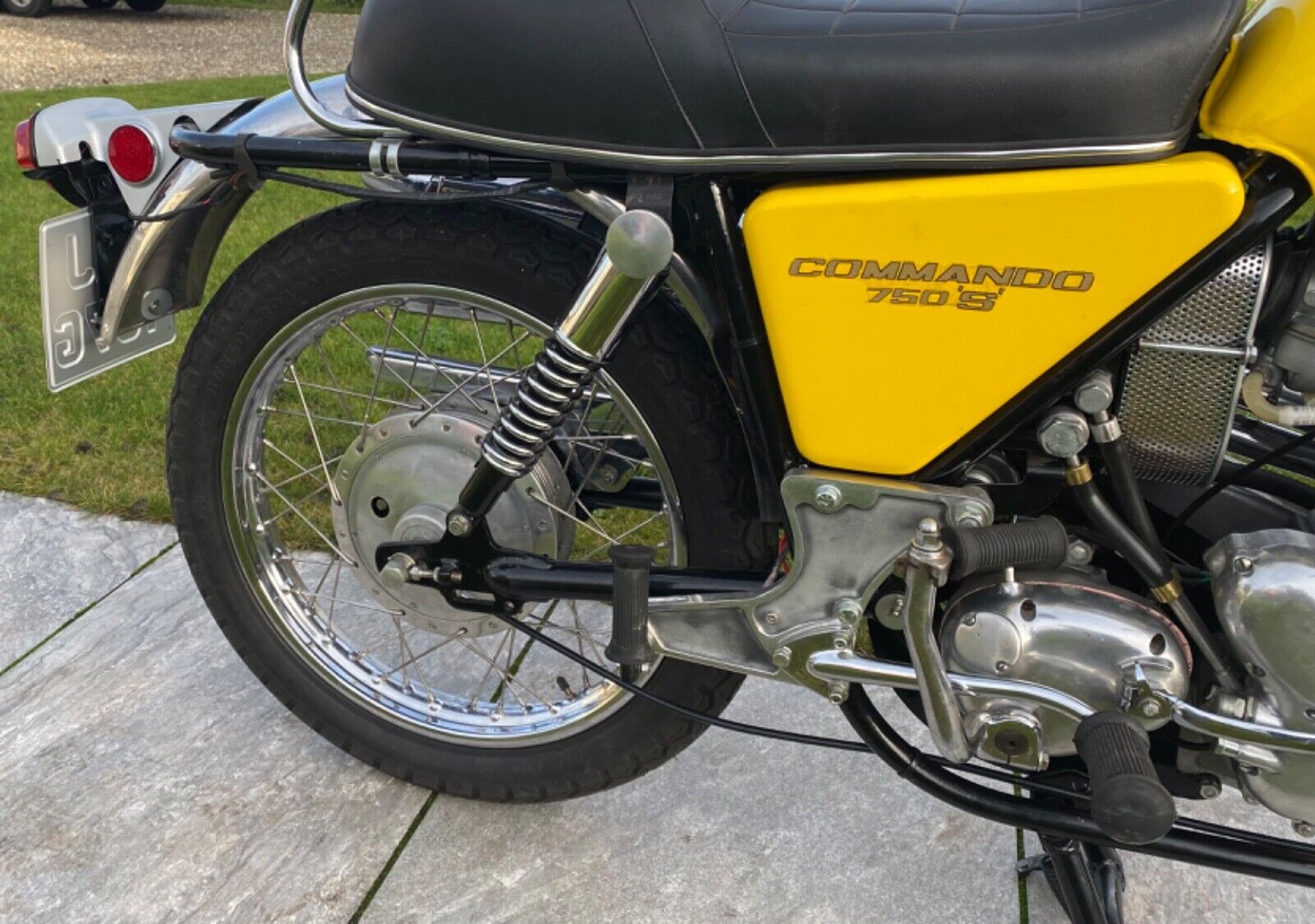

Here you can see the difference between a correct and a later seat for the 69/70 Commando:
At first I only had a later seat (71 onwards), the front curve of the seat does not follow the upward swept side panel Part No: 06-1766
wrong seat
Later I got an original 69 seat with the correct shape. It follows the upper line of the side panel and has a distinctive " hip swing". Part No.: 06-1168
Ok , the seat cushion is a bit sagged.
right seat
Thanks Ulrich. Just exactly the info I needed and confirming Johns reply.

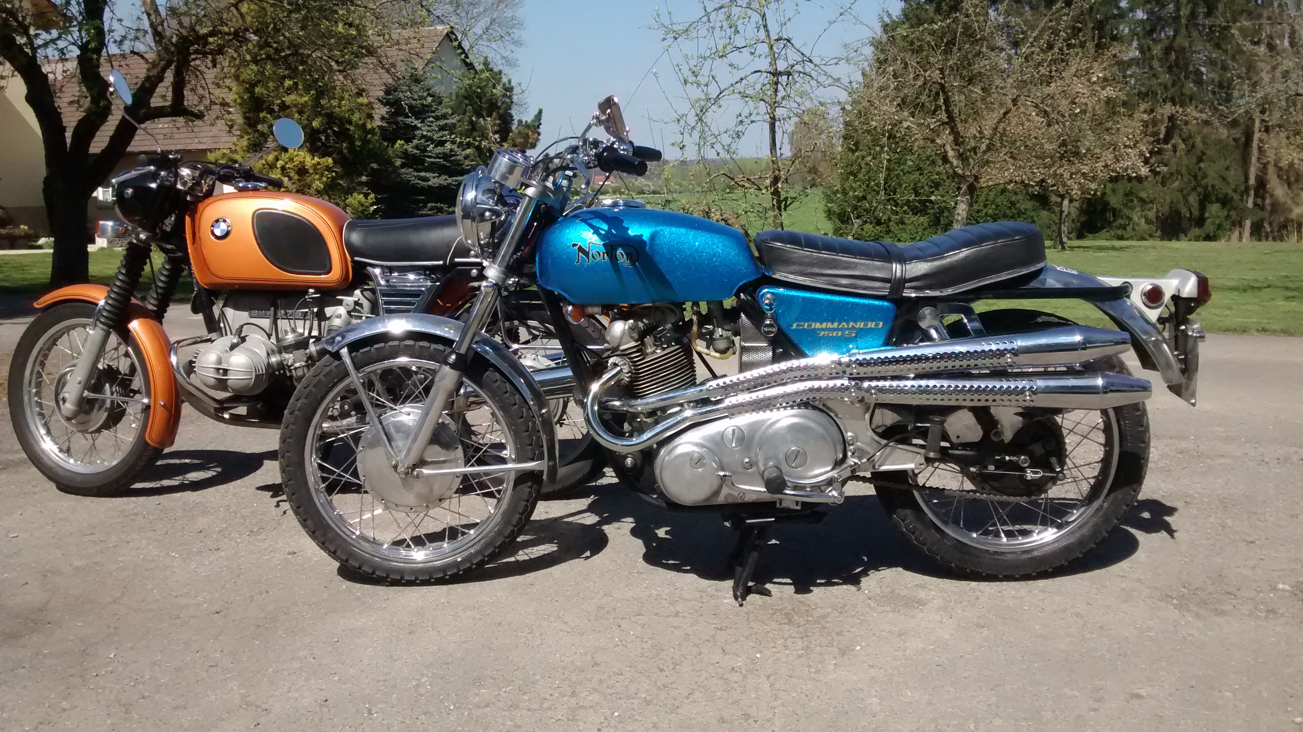

Blue metalflake. My favourite colour. The black 69 is blue under there somewhere.
Eddie
Hello Eddie,
my 1970 Commando was delivered to Gus Kuhn im May 1970 as a black roadster accodring to the dispatch records. I also found blue matalflake under the black paint on the original plastic tank. I guess they repainted those tanks and side panels for the European market.
I see, you have a key fob on your key for your S Type. I removed mine because the fob is dangling around in the wind , ruins the paint job and also the ignition switch while driving.
