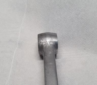

Look at those conrods

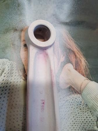

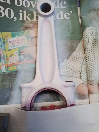

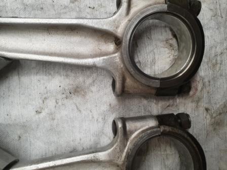

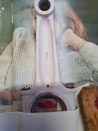

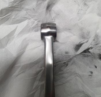

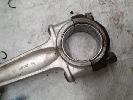

To all,
Thanks for the advice but I bought an 850cc engine. Took it apart with a friend and we found a lot of mess inside the crankcases. Look at the pictures of the conrods. Two different ones and a lot of scratches. I polished them and did a dye penetrant test. One is maybe fine but the other I don't trust.
That's the reason I look for other conrods.
