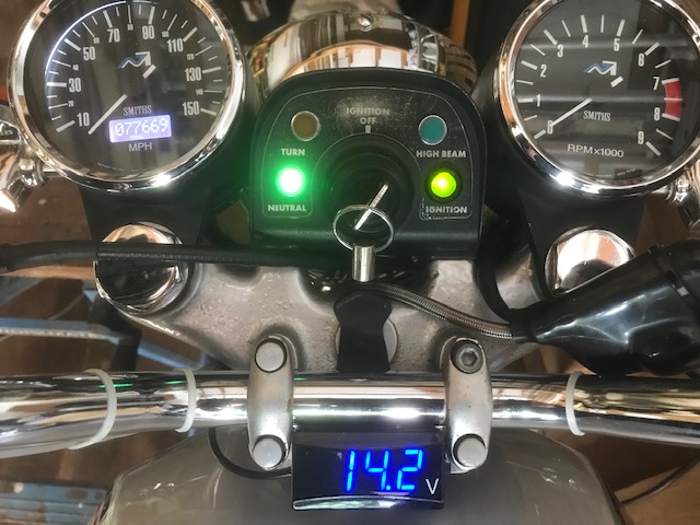

Hi,
I have electronic speedo and tacho on my MkIII:-
https://www.smiths-instruments.co.uk/motorcycles
And they look good. tidy up the front end. No long droopy cables. Not cheap but worth it.
Just need some way to get rid of the throttle cable !
