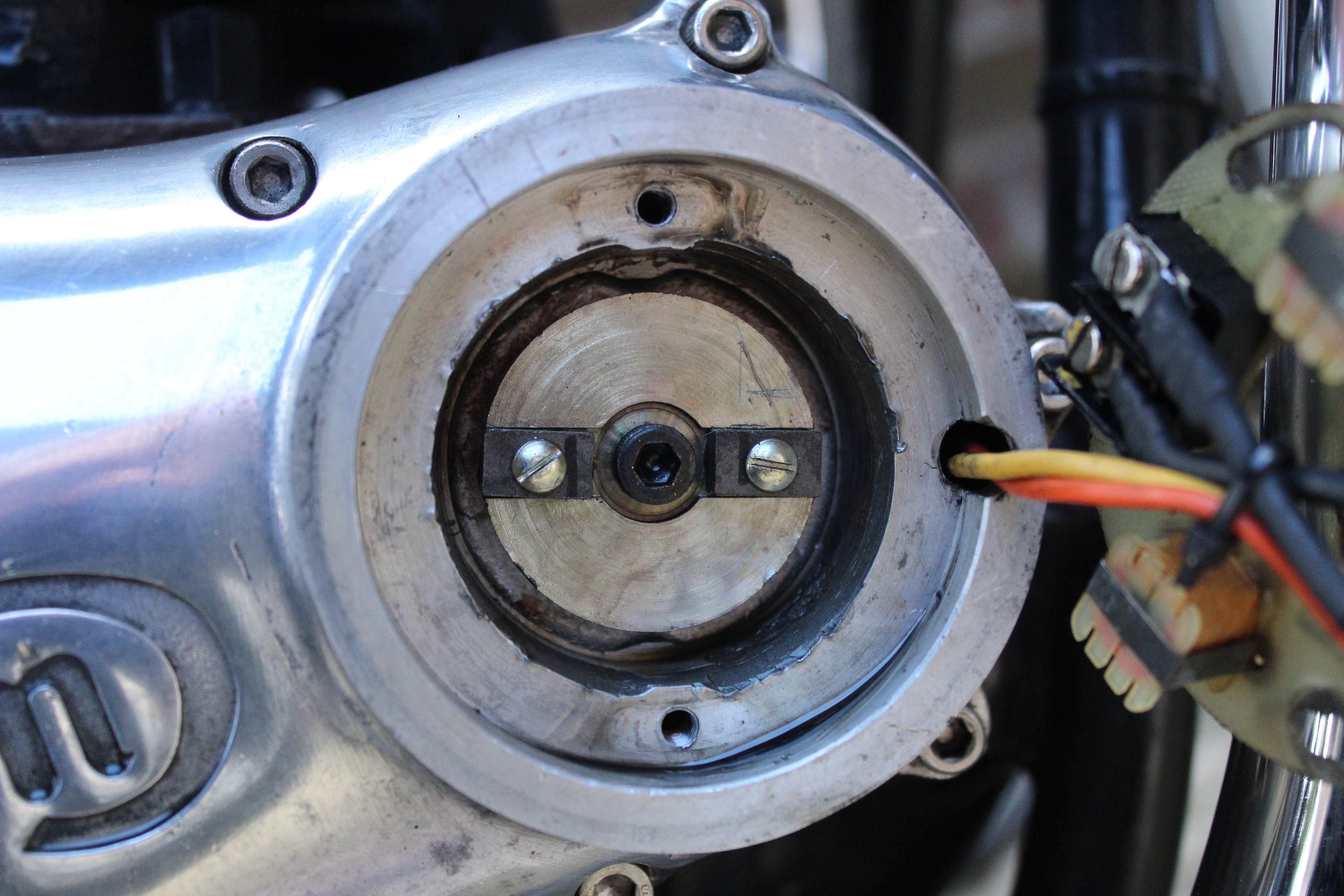

I have an oil leak from points cover so assuming the seal behind here is shot.
i have an unknown make electronic ignition fitted. How do i remove the pick up? do i need a puller of some type and where would i get it? could be a problem not knowing make of unit or the thread on it ,does anyone recognise. (if photos work?)
I haven't really tried to get it off yet and dont want to break anything trying! So any help and advise greatfully recievedelectronic ignition
ignition pick up
That looks like a Boyer unit, you should be able to just remove the centre bolt and then the inside will be threaded.
As per the standard commando manual to remove the contact breaker cam:-
Using service tool 060934 as shown in Fig C20, screw the tool home through the contact breaker cam until the cam is lifted off the camshaft taper.
If you don't have one then  the rotor bore is threaded internally to accept a 5/16" UNF bolt, that should be screwed into the rotor a few turns then tap the bolt head up-down-left-right a few times and the rotor will drop off its taper.

I did wonder if was a Boyer(the black box is stuck down to rear mudguard so no writing visable to identify)
Thats good to know that thread is likely the same as standard,looks like Andover Norton sell a slide hammer for this so think i will get that.

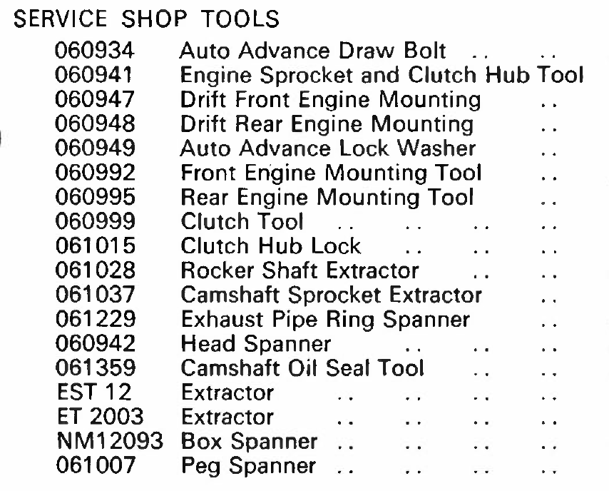

On special tools, it will with luck be a while before you need to delve deeper into your bike, but do study the list of special tools in the workshop manual (page 6, I think)
Special tools list
No fewer than 18 …
Some of these can be worked round if not present and the job is urgent (pullers, transmission locking — a stout rag jammed between sprocket and chain will do), while others are indispensable (e.g. for compressing the clutch spring).
The only one of these that (imho) you can definitely do without is the 061229 Exhaust Pipe Ring Spanner — provided that the finish on the finned nuts is not important to you, a large Stillson is much more effective.
