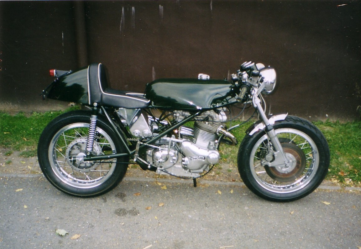

Are you using the Seeley frame?
Definitely needs a flame paint job & a Peel fairing lol. E mail me Sussex Branch Sec
