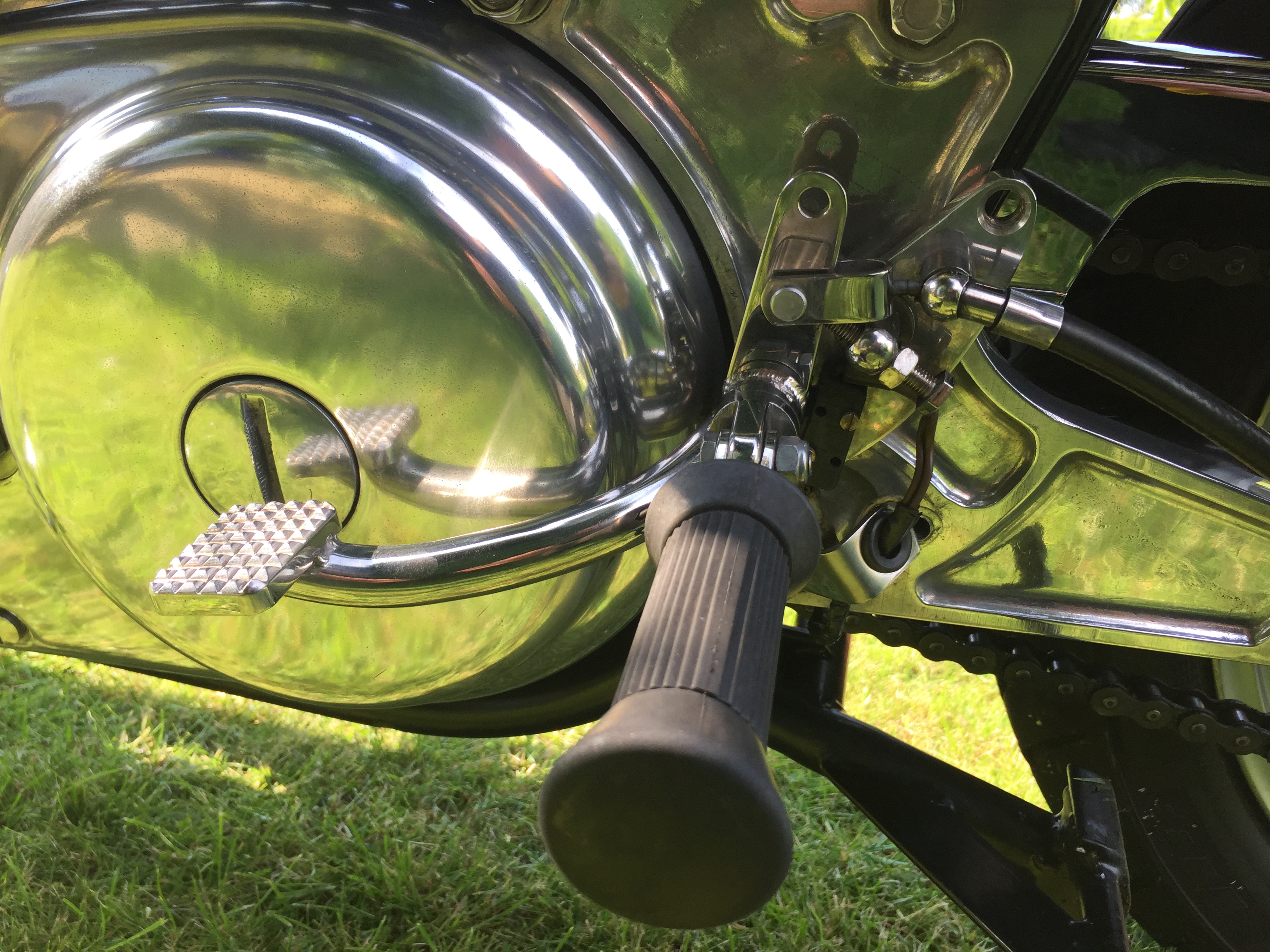

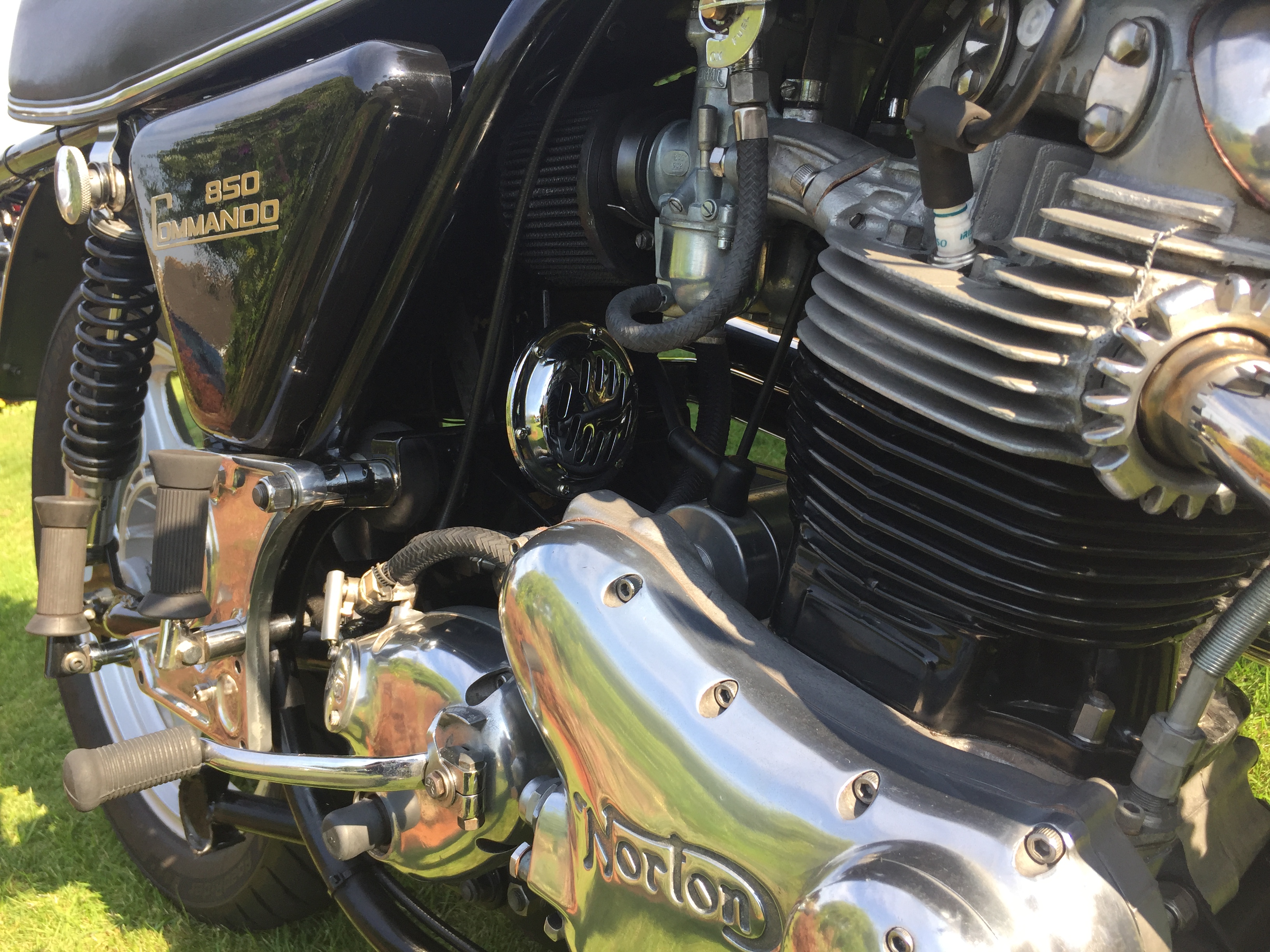

Hi Roy,
I made up some rearsets with reversed gearlever years ago for my first Commando as I had Triumphs before that and kept changing the wrong way, with embarrassing consequences! I utilised pillion pegs so they fold up, keeping the bike narrow when squeezed into my garage with all my other junk. The gearlever had to be bent out a bit to suit but I kept them for my next bike which I still have. A lot of people find the standard pegs are too far forward for them.
Regards, Al.
