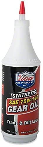

hello  all you need is Lucas primary chaincase oil  made for H-D big twins  just try it and see  yours  anna j
I use Lucas products on my shaft Drive Kawasaki's; Helps Quieten Noisy Gears Oil Sae 75W/140 Manual Transmission Lubricant Additive
