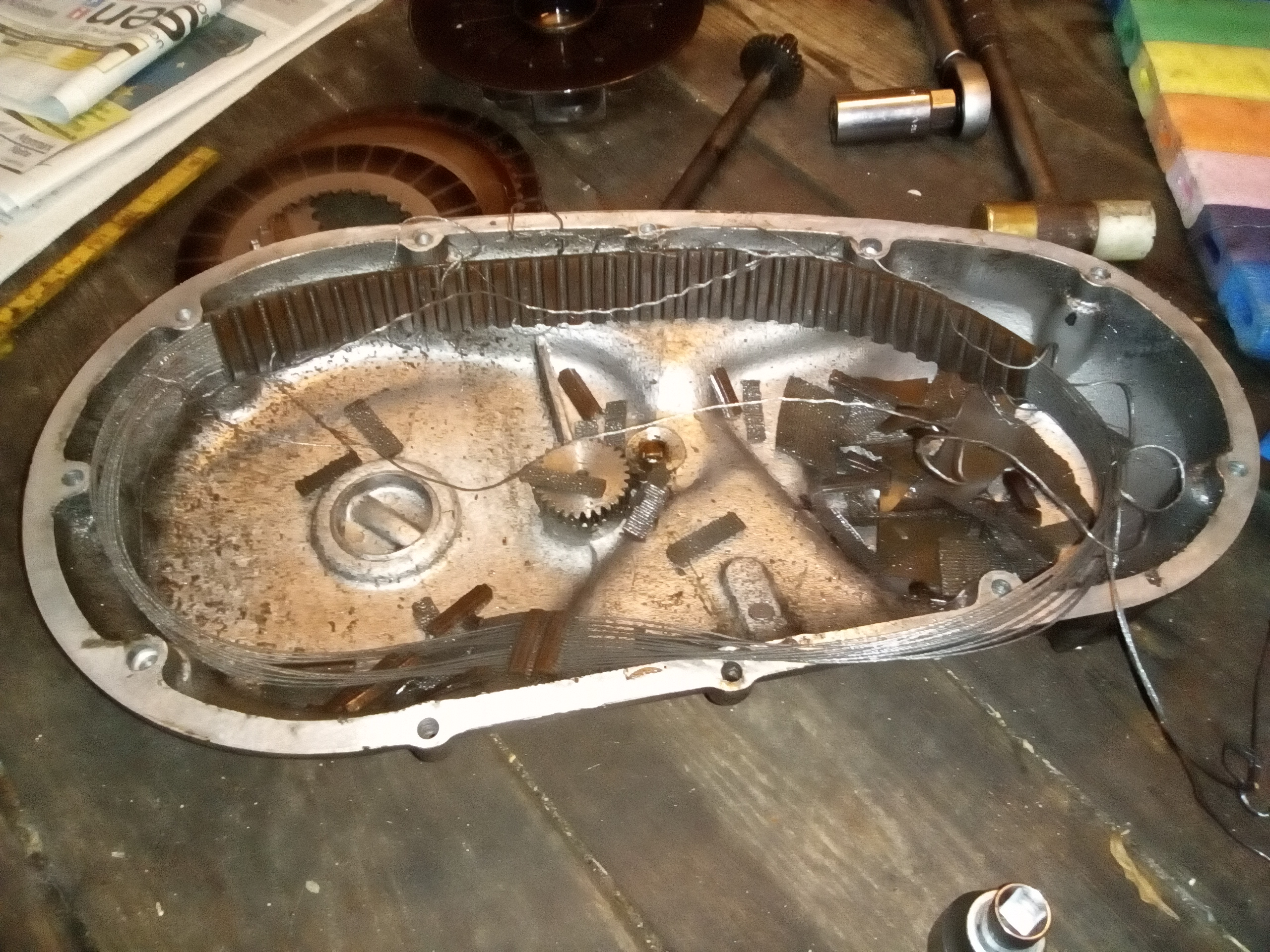

I have had the belt fail the teeth stripped off. The belt had approximately 7000 miles. Does anyone know if this is the normal life of the belt or have I been unlucky.

You've been lucky

Yesterday I pulled the teeth of my 24 year old RGM belt. It have been in service for around 75-100.000km on a 920ccm MK3, so I guess 7000 miles is to little.

7k miles is very poor. I have the Norvil belt kit using a Gates belt. I changed it once after several years use more because I thought it was time to rather than there being anything wrong with it. Belt alignment and tension are important. Run it loose rather than tight.

It is a Norvil belt kit…
It is a Norvil belt kit fitted 2012. I have had some oil get into the case from the crank oil seal, maybe that has contributed to the failure.

The camshaft belts on cars are generally good for 80 to 100k miles. For Harley owners with rear belt drives the recommendation is to change the belt before 30k miles have been ridden. I believe that hidden inside the notes I got with my primary conversion kit it suggested a change at 30k as well.
There are 3 main causes of failure of these belts. 1) The belt was too small or made of inferior materials. 2) It was fitted with the wrong tension or the tension has not been checked often enough. 3) Wear in the gearbox bearings has allowed the belt to move sideways and rub against the keeper plate or crankcases. Either ending up with excessive heat due to friction that causes the belt to shed chunks.

The belt was part of the Norvil kit. Installed as per the instructions. I have renewed all the gear box bearings and seals.

Belts fail in my experience when they are over tightened , 7k miles suggest a problem.
If you have a belt stick with it , just adjust it properly
7000 miles is not enough
I agree with Gino, 7000 miles is not enough for a belt. A friend of mine had two Belts fail on a Fair Spares kit so bought another from an industrial belt supplier. I’ve had my RGM kit on for over 20 years and done over 25,000 miles so far on the original belt. Maybe I should replace the belt to be on the safe side. Ive had my Alton E kit on for the last two years with the belt drive. I get oil leaking through the crankshaft oil seal so the belt does get oil on it. Checking to make sure the belt is running straight might be a good idea when you fit a new one and don’t have it too tight. I’ve kept my chain and sprockets in case I need to revert to original set up one day.

I know someone who snapped a crank by having the belt too tight, Ooch!
Mine came with a belt that was too slack and rode over the keeper plate and wiped out the alternator Ooch!

Considering the age, usage, the environment it has been subjected to, the miles you have had from it suggests that it has done very well.
Belts fail, usually suddenly, two failed for owners attending the Austrian rally last August. Road use - use a chain, track use - feel free to use a belt. How often do you hear of a chain leaving someone stranded, they fail, but usually after very high mileage or incorrect installation, usually the chain is still functioning when the owners find bits of it in the chaincase.when doing other work.
