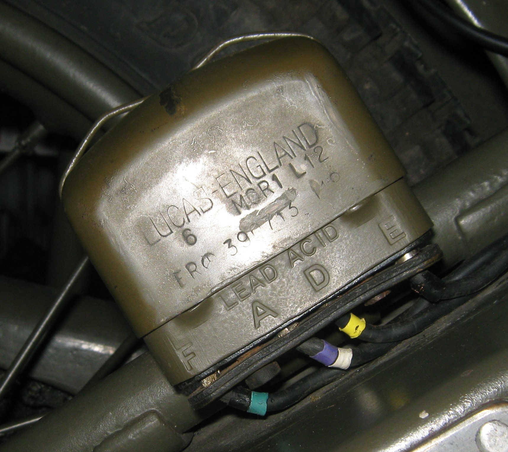

I don't know about the civilian bikes, but I have an original 1939 WD harness and apart from the dip switch wiring, it was all black but with small coloured rubber bands at each end as colour coding. This is my impression of it using shrink-fit.
