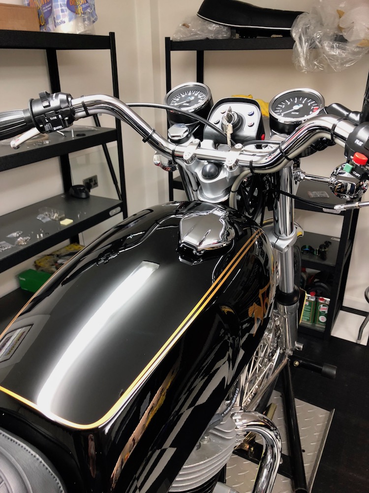

I used this firm in Surrey…
I used this firm in Surrey to do all my parts:
I went for the powder coat option and it looks spot-on. Really nice people and great quality. Here's a picture of the finish:
img_0201-jpg
Steve Thanks for the infor…
Steve
Thanks for the information, i have to say that is a stunning restoration, i will be going along the same lines.
Am just about to buy a table, can i ask the make and model of yours?
Great polishing of the casings same question, can you tell me who did it please?
Would love to see more pictures?
Table is a Sealey MC365 Hy…
Table is a Sealey MC365 Hydraulic Bike Lift 365kg Capacity. Couldn't have done the job without it, makes working on the bike a pleasure! A great piece of kit.
Norman White polished the engine casings while he was rebuilding the engine and gearbox.

And what a tidy workshop!…
I must admit even if I could achieve a result like that I'd be reluctant to ride the bike as the first stone chip would be so depressing.....
Steven: Do you ever ride i…
Steven:
Do you ever ride it?
Your bike is waaayyy to beautiful.
Or did you take the photos before putting it back on the road?
I've only just finished t…
I've only just finished the restoration last month and have yet to start it up.
Everything is done but I'm as nervous as hell starting it in case I've got something wrong! I was hoping to give it to someone who has good knowledge of Commandos to check over before pressing the button but everyone seems too busy.
Now the weather is a bit better I'll stick some fuel in it and give a try. If if starts I want to jump on and run it in with a ride rather than leave it ticking over in the garage. But with a newly built engine and gearbox, a new carb, new wiring loom, new starter motor, Tri-Spark ignition, CNW coil etc., I will be amazed if it starts!
Steven: Is this bike a sho…
Steven:
Is this bike a show bike???
It is waaayyy to beautiful to take out on a wet roadway.
