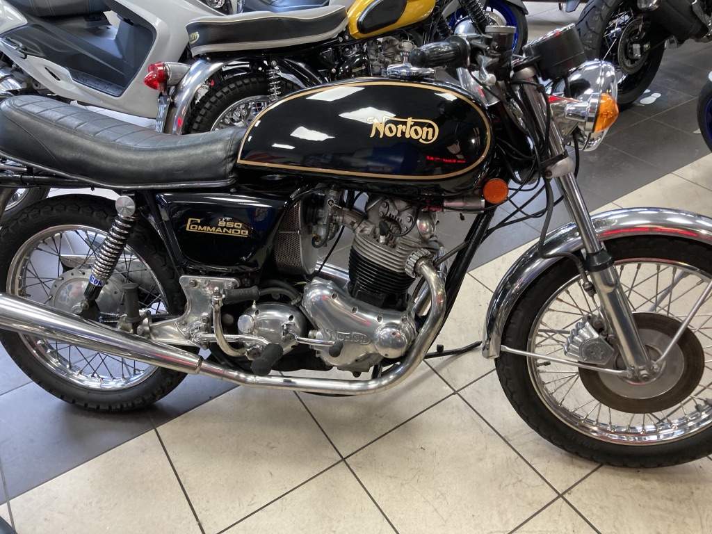

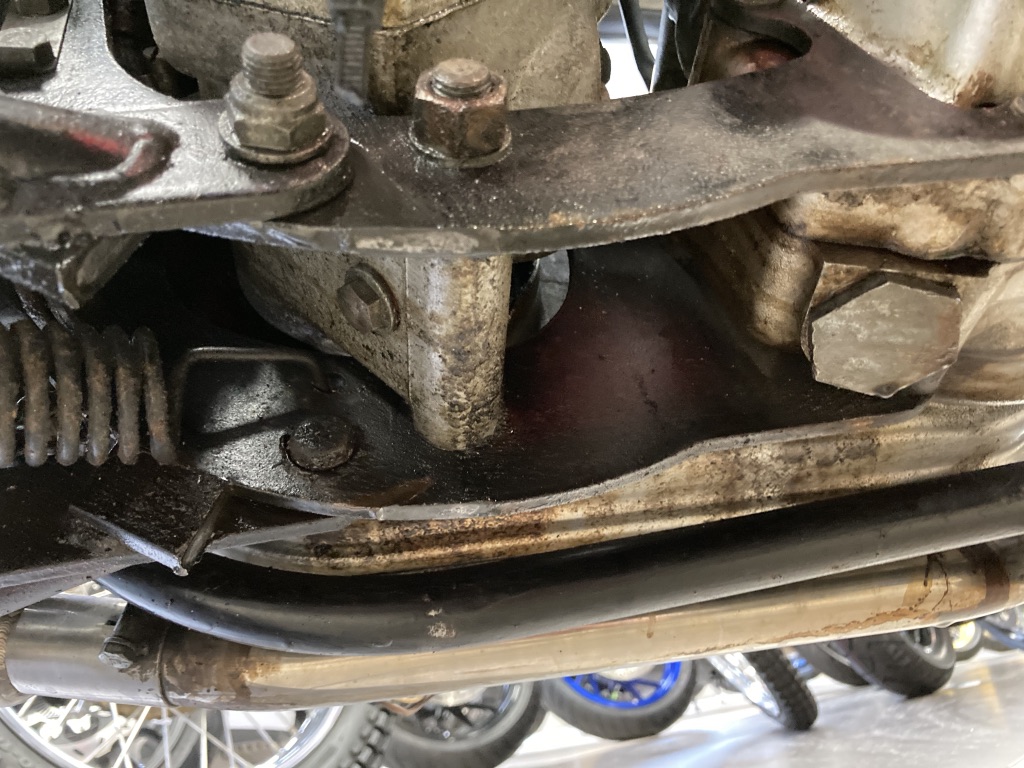

I'm looking for a running norton commando 73/74'ish and I've recently viewed a potential purchase a 1974 Norton Commando in a dealership, which looks okay and at a decent price (? £8.5K). However, it appears to have a couple of issues that jumped out and made me question whether it has been looked after: firstly oil leaks (potential lose fixings see photo?), secondly the handlebars have interfered with the tank/ damaged (replaced/ slipped forward? cable issues?). Generally it looks okay, though frame also looks to be spray canned, so am a bit weary as it looks like the bike may not have been looked after - so more hidden issues. Would be sorted to run if bought. Accepting the limited info, any comments would be appreciated.
It’s not the worst package in the world, but does need some tidying. If they are going to deal with the leak, damage,( seat looks a bit odd), and they offer you some sort of discount it could be made into a nice machine .  Not a lot of spanner rash, butchery and it depends on what your ownership is based on. A rider, show bike or investment, once checked by someone who knows the model well you can decide.  Personally I would avoid dealers, they will not offer any support once sold.  Keep an eye on club classifieds, that’s where the real nice bikes are.

A dealer tart up job with a respray and polish, surface only looks good, mechanicals will not have been touched and I bet there is no warranty or a very short one. Its a 5K to 6K bike as its unrestored and lead a hard life. Walk away and buy from the NOC Classified.
Seat looks like a Roaster seat bodged to fit the Interstate tank, rubber brake hose looks original and fit for the bin as it will expand when brake lever is pulled making the front brake even more wooden than normal. Tank is not fixed correctly at the back, too high off the side panels and probably the cause of the handlebar issue. Throttle cable adjuster will eat into that nice new tank job if not sorted.

It seems very close to the forks on full lock to me, so may not be an original petrol tank. The seat is just plain horrible. There isn't a shortage of Commandos for sale so I'd look elsewhere. £8.5k should get you a good one, not a shoddy one like that.
