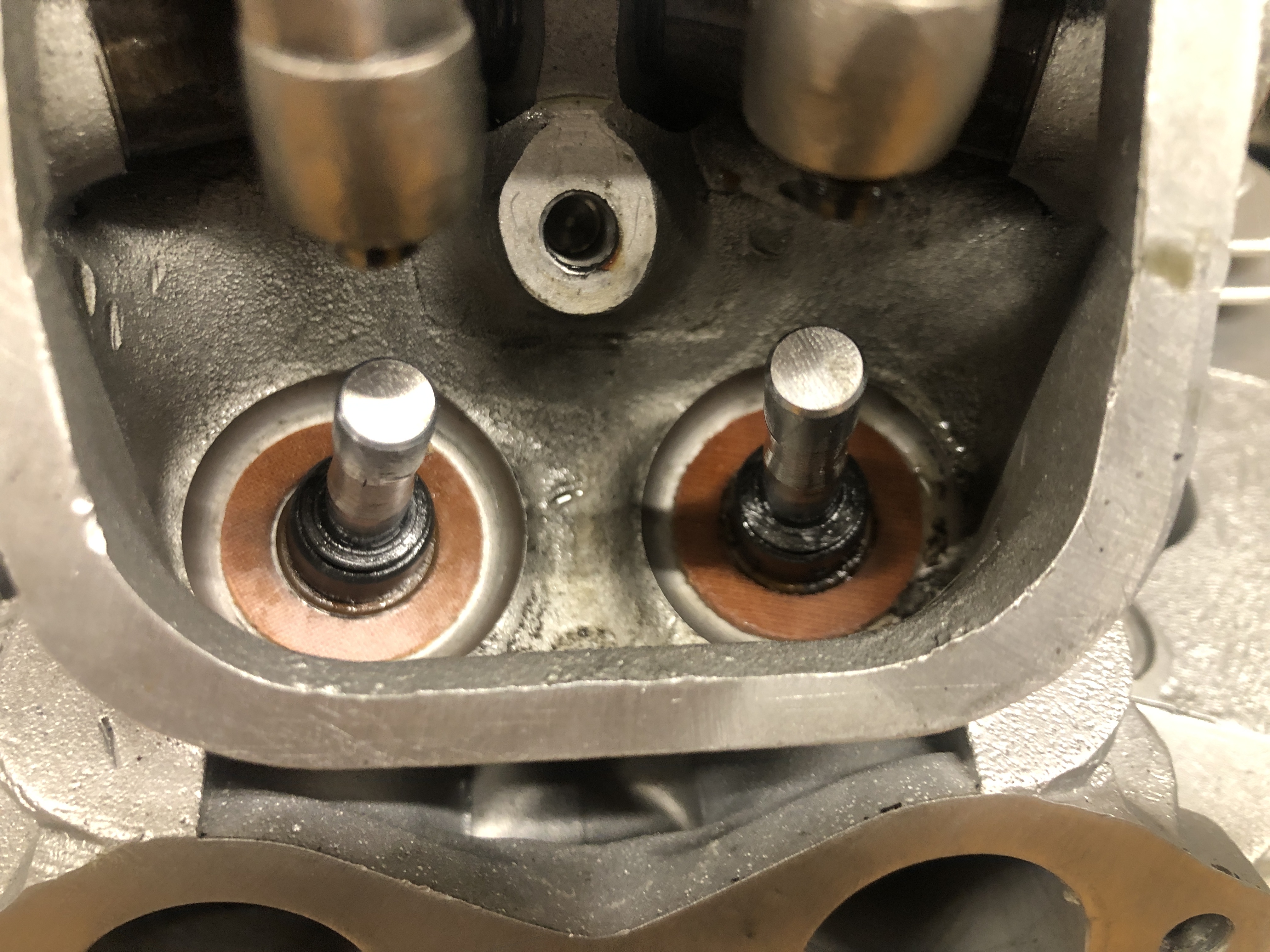

I’ve just removed valve…
I’ve just removed valve springs and valves , I’m a bit confused now , should I be seeing seals on inlet valve guides and a fibre washer under spring cup ?

No oil seals could be correct …

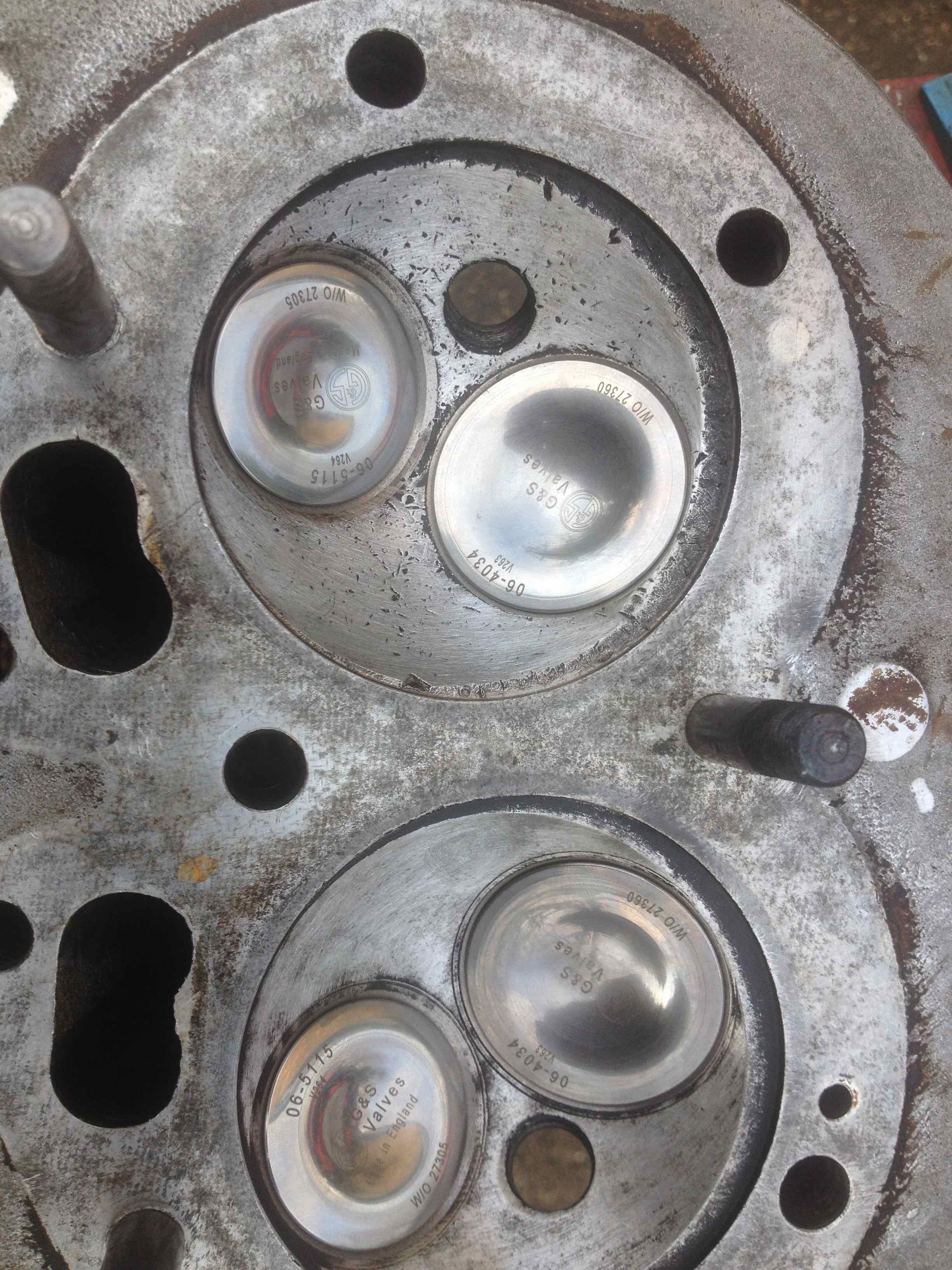

… if the p/o fitted Colsibro guides and corresponding valves, as suppled by (e.g.) BLR Engineering (http://blrengineering.co.uk).
I've been running these in my 750 Fastback for the past 1000 miles and so far at least they are entirely satisfactory.

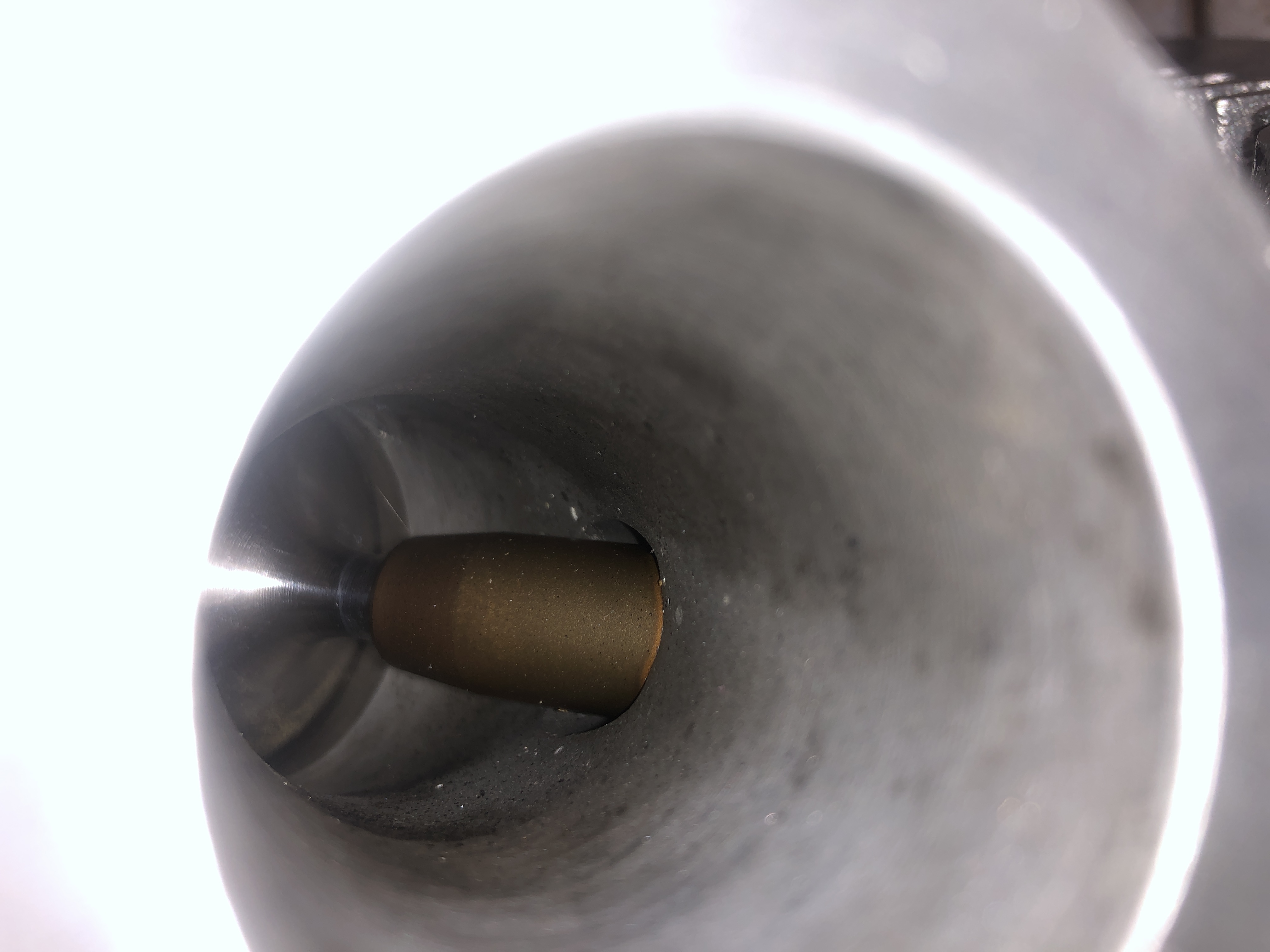

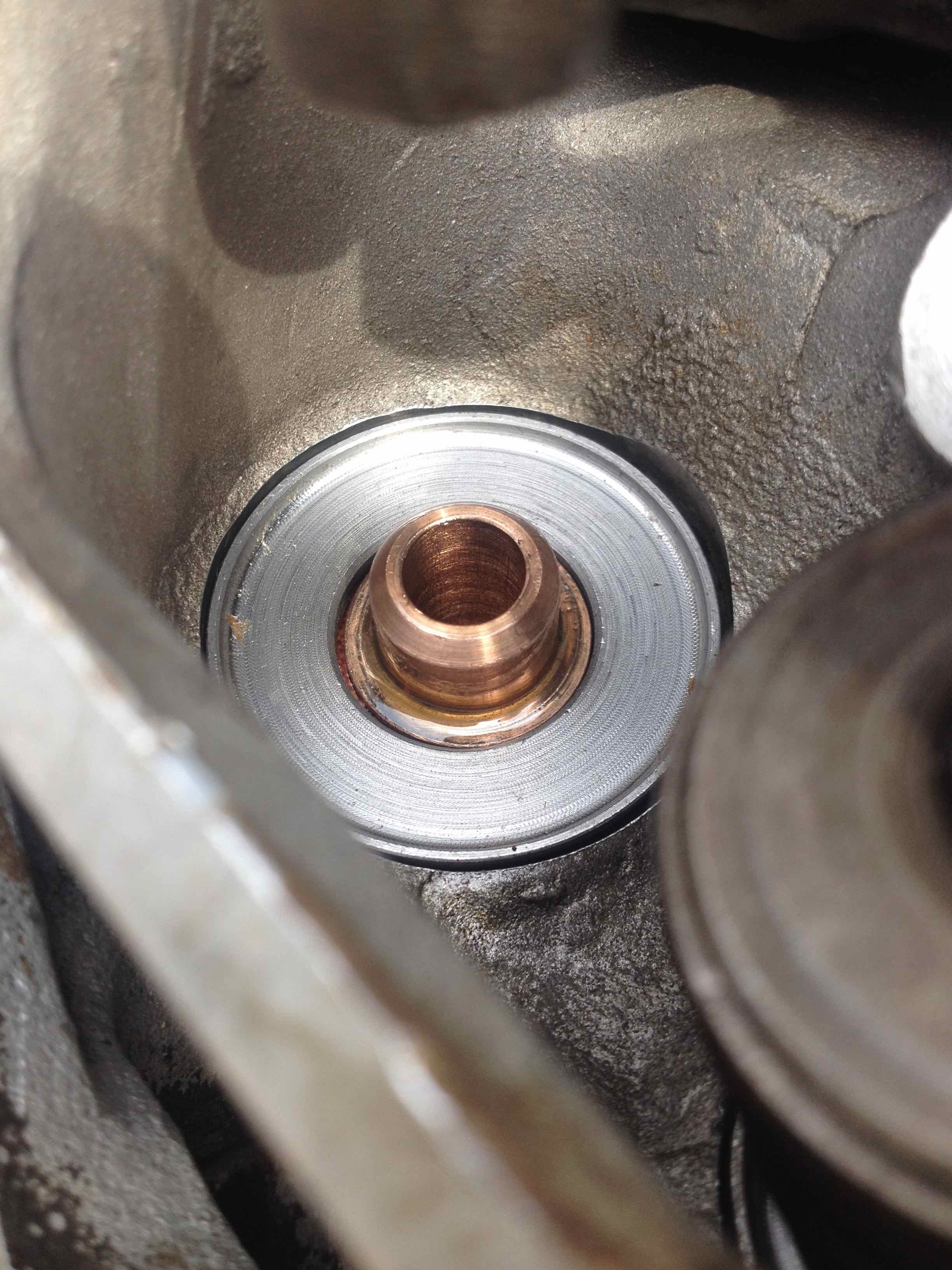

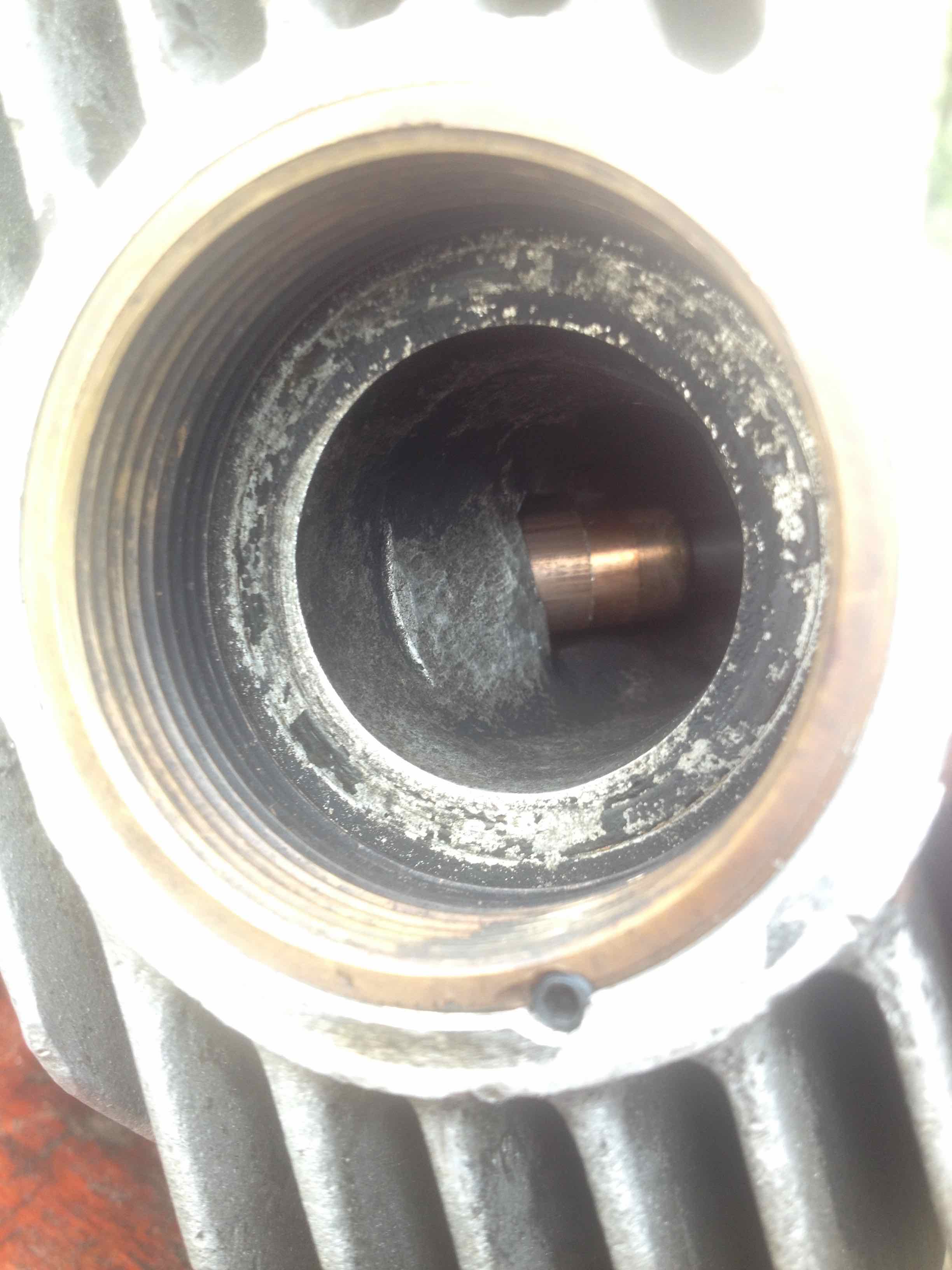

That’s interesting , the…
That’s interesting , the inlet guides look like a copper colour and the valves are a different shape to the replacements I have , the ones I removed look a domed shape , the replacements aren’t.Tried to post pic but doesn’t seem to post.
Colsibro guides
Allan may find the attached pix useful: the Colsibro guides and associated valves in my bike.

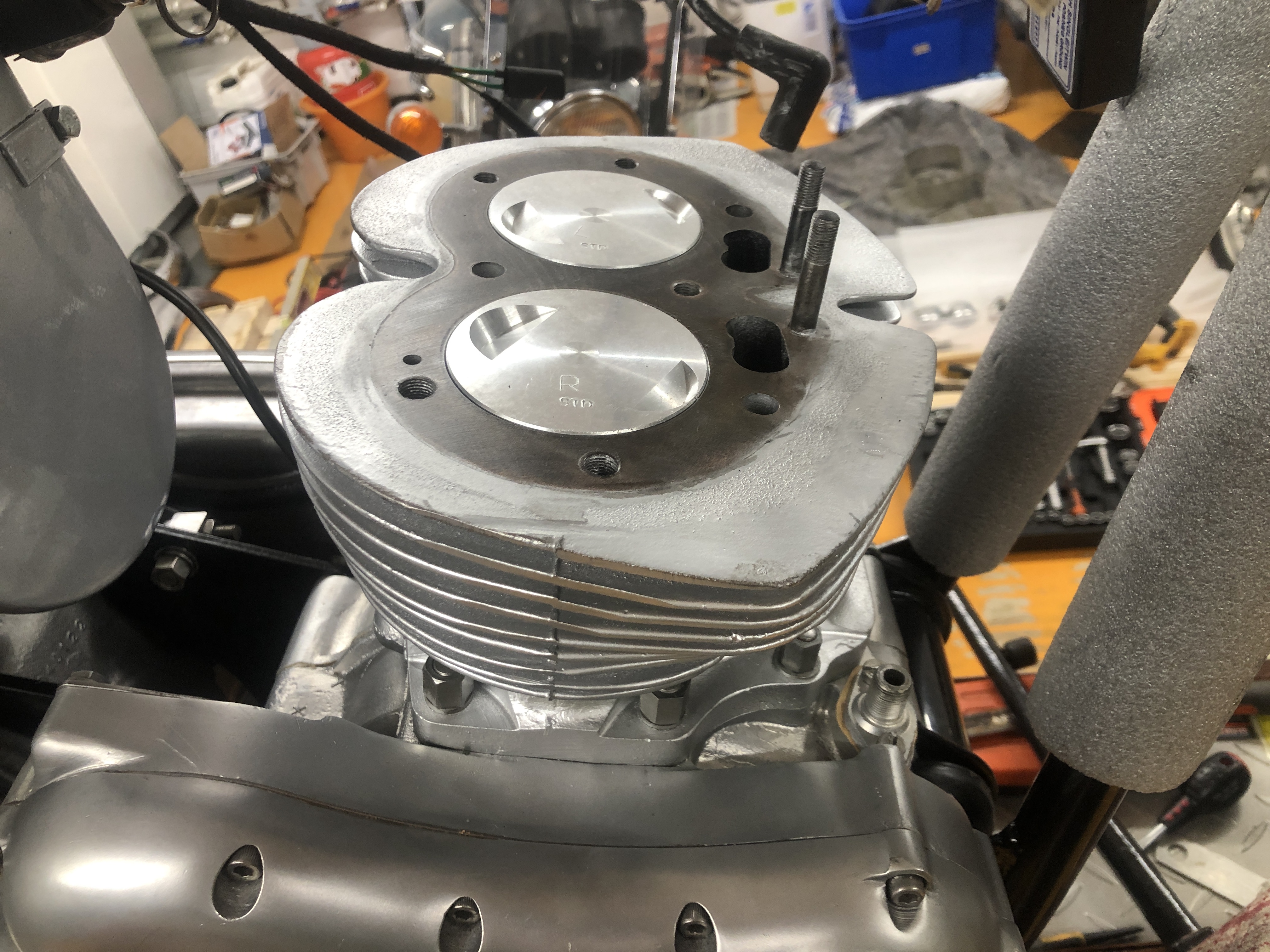

Well I’ve rebuilt head with new std valves exhaust valve stems were worn and felt loose in guides, the new valves fit nice so guides seem ok, fitted the insulating washers and std springs, the springs I removed looked like progressive ones I think trying to post some pics

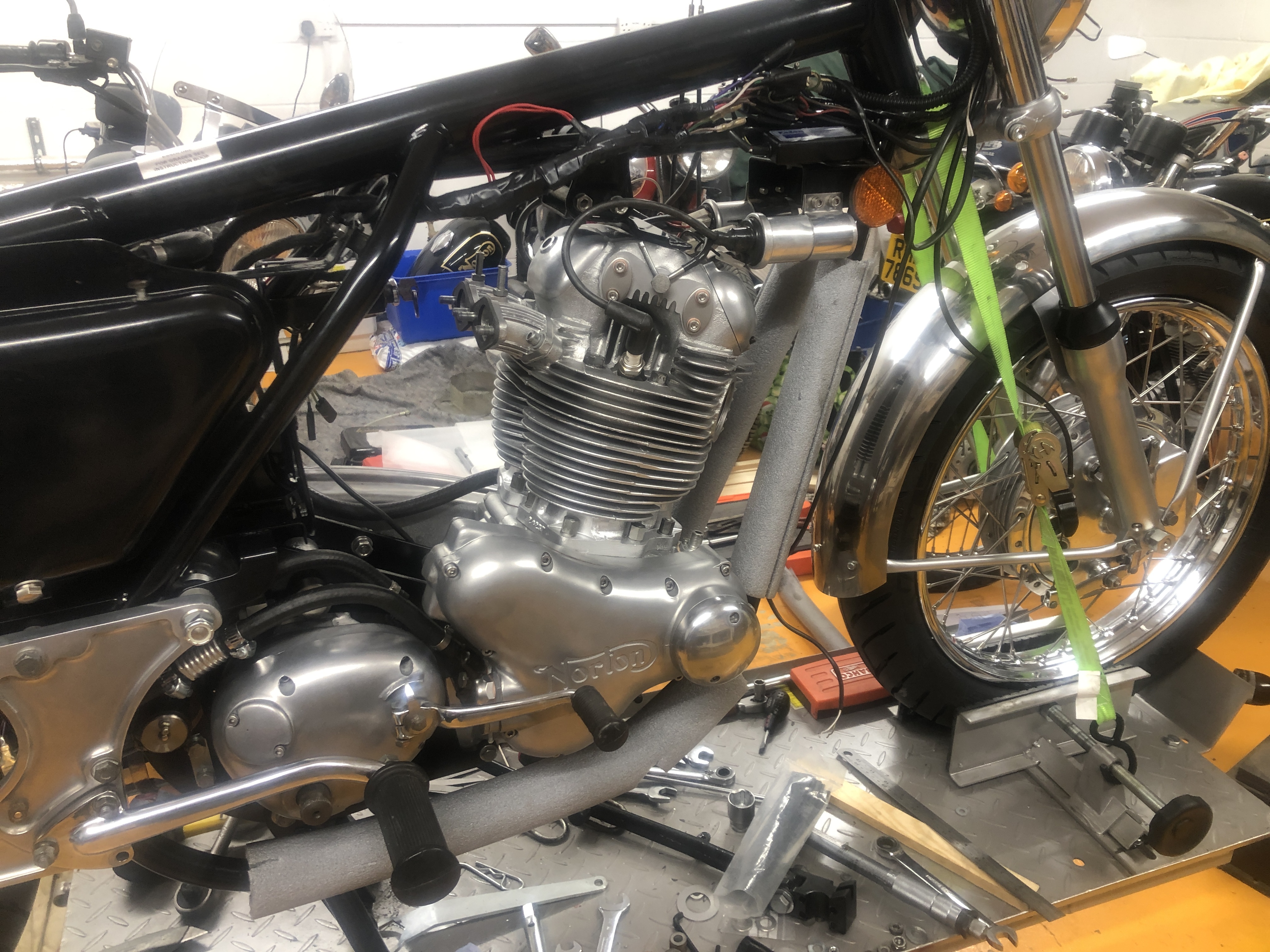

Back together
It’s back in bike now, not to long before the really worrying bit , firing it up !
