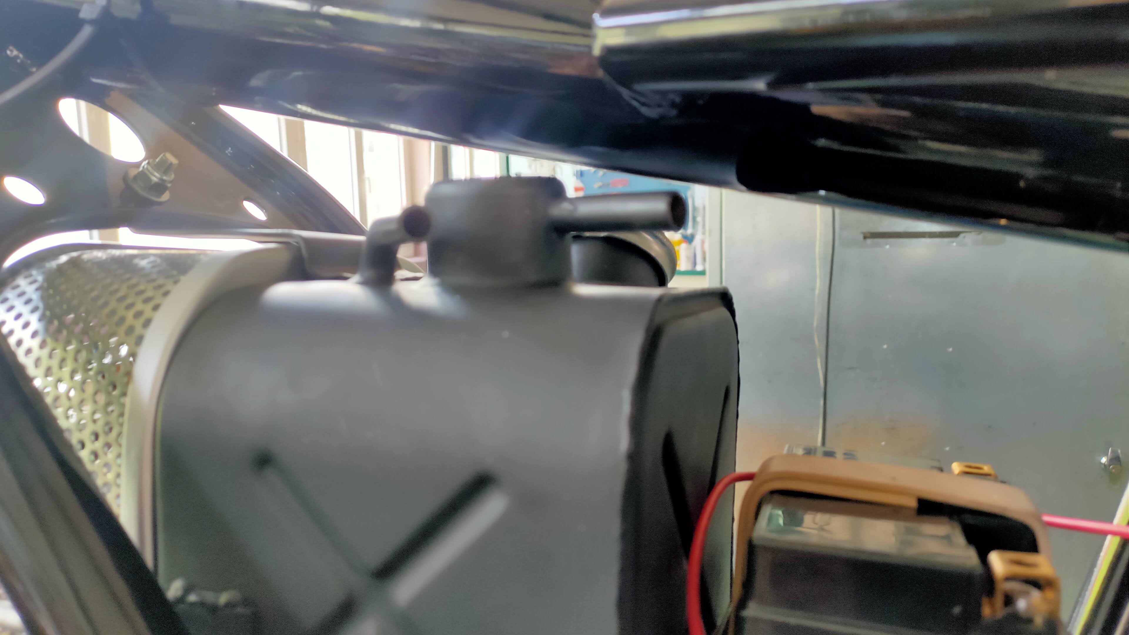

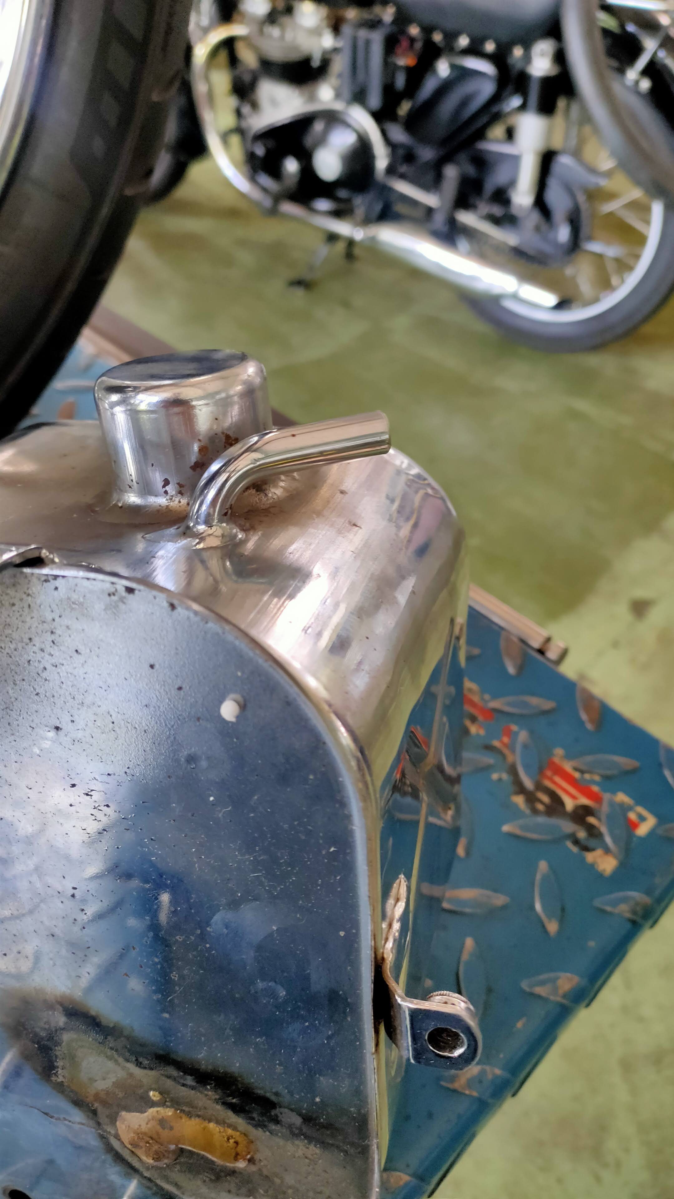

oil tanks early Commando
Can anybody identify from when to when this type was used?
The ventilation and connections 1 or 2 are not equal on these 2, any explanation?
Thanks in advance for any information.
Yes. It's a 1970 Roadster.
The connections at the top are for the breather and the one in the cap at the top is not original. Originally the vent outlet from the tank was to the back of the air filter which has been brazed closed, probably because it would fill the air filter with oil..
