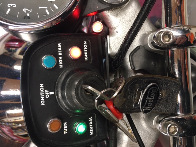

Recently sourced some appropriate items for the task of adding an oil pressure sensor and warning light to my Commando Mk3.

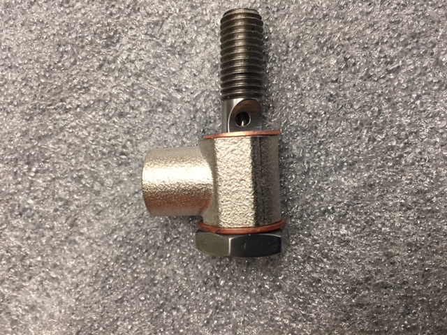

A very neat Banjo that has a 1/8" BSP female for attaching the Oil Pressure sensor.

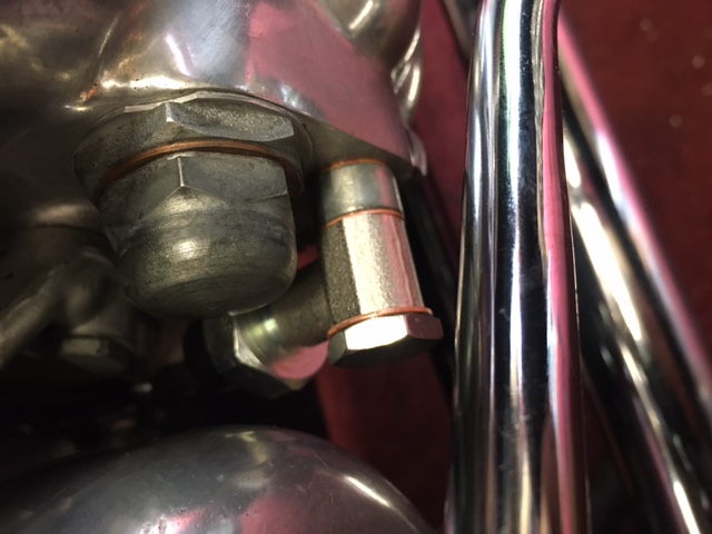

Modified Stainless Steel Banjo Bolt to complete the job.
All at a low cost! Works a treat
The most expensive item was the original warning light!
Comments appreciated!
Venhill can supply a Double stainless steel banjo bolt at £8.75 (Plus delivery) but it is just too short for the job (only a few threads engage in the engine).

Materials
Brass Banjo - Nickel Chrome plated.
Copper washers
Stainless Banjo Bolt
= No Soldering!
