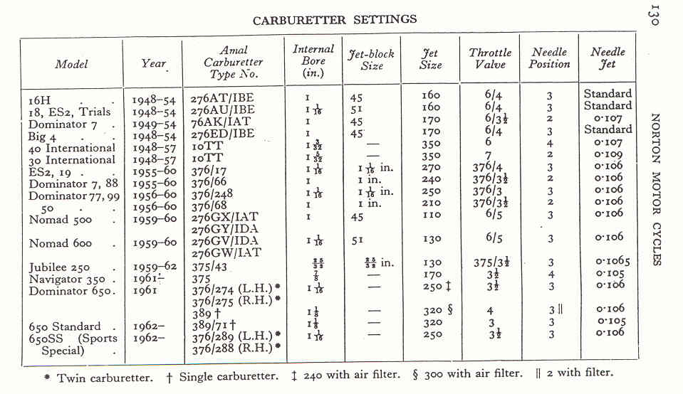

Hi Colin, Is it misfiring? Does it fluff under load? If the ignition circuit is fine then everything points otherwise to fuel delivery and carburation, are there tank problems, fuel taps? But from your description it does sound like a carburation problem, what are the settings you have used? Is the bike twin carb's?
See settings table, posted up previously, by Phil Hannam.

Doesn't misfire at all just struggles and revs die but keeps going and once it's over the hill it's away again, tank and taps okay, good flow and carb settings (single carb monobloc) are as per Phil Hannam table for an 88, the bike is to nice to be left in this condition.
