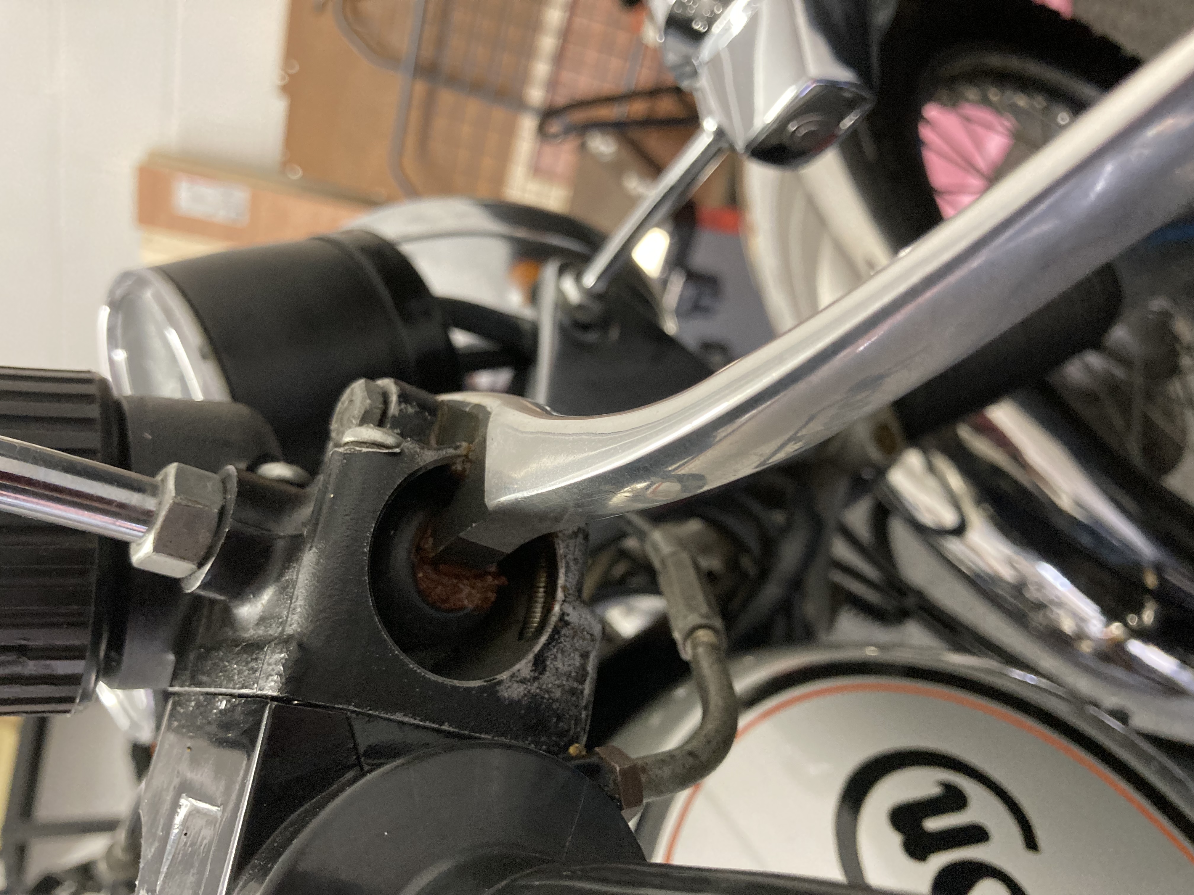

Have just started / got a Norton so exciting times ahead! However have just noticed some brown thick residue from the brake rubber between the lever and housing (see photo). Didn’t notice when I bought it but though I’d ask whether this is normal and before I investigate further? It is a mk3 850 interstate.

Master cylinder.

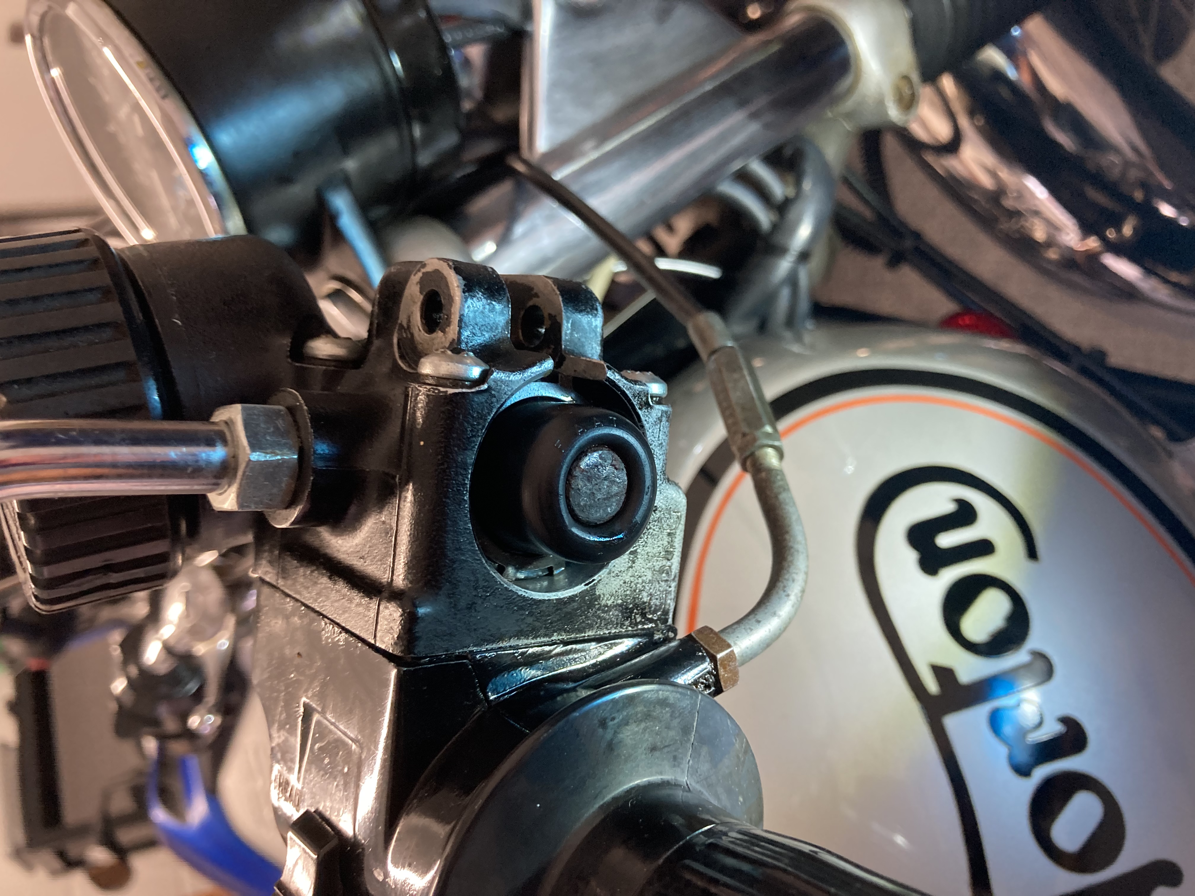

Hi Hans, thanks for that confirms my worse fears but very helpful. Have had a look and cleaned up see pic, rubber looks okay, will check fluid and put back together later. Thanks again Nathan
Looks like corrosion to me, aka rust. You can remove the lever without the piston shooting out and give it a wipe off.Clean it up with a squirt of wd40 and check operation of the brake ,and make sure the fluid is clean in the reservoir. HOWEVER if the rubber boot is damaged ,it means a rebuild, which is not that difficult.
