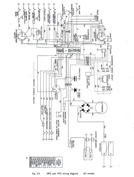

I have a "1972 and 1973 wiring diagram   All Models". Please see attached *.jpg file.
The issue is that the '72 and '73 diagram does not match the wires  on my '74 mk2a roadster.
Can someone please scan the '74 version of the wiring diagram, presuming it's different from the one in the image below, and send it to me.

The 72/73 diagram works for mk2a, well before I added my own changes. Grants website confirms this. So best if you explain your differences.
Help yourself to anything on the site.
If there is something you need that I haven’t covered, let me know and I’ll do whatever I can to help.
Grant
