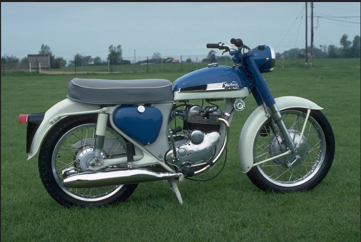

My question is, i really dont like the enclosed look, so, would it be a simple case of removing the rear tinware (and storing them carefully away) to reveal the oil tank and battery box (i'm assuming that's what is on the opposite side) as per the Stolze machine above? Or, does the rear tinware hide a more utilitarian arrangement underneath?

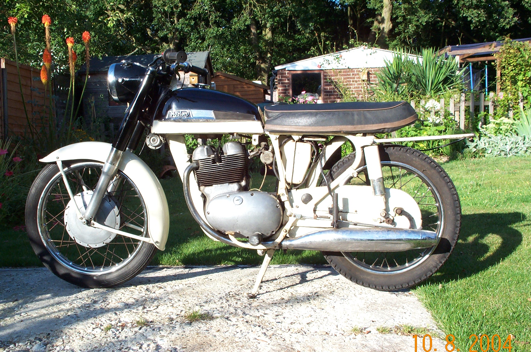

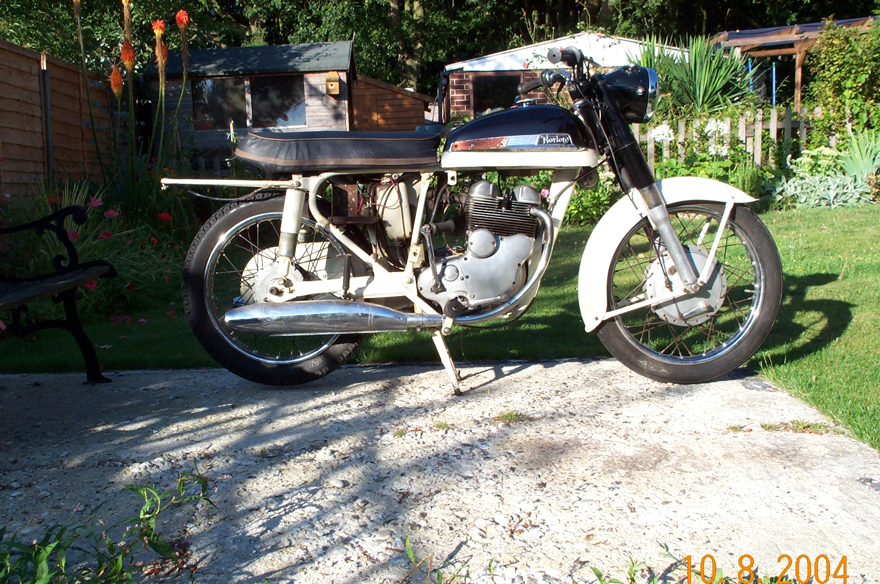

If you like the style of the standard model, then try to find a nice one thats complete. There are two styles/colour schemes. Birmingham bikes were two tone, Dove Grey frame & mudguards with Ever Ready Battery Blue top half of fuel tank, headlight, battery box & oil tank. For correct colours use British Leyland Arabian Grey & Ford Fjord Blue.
Plumstead bikes had a black frame, with black mudguards (or chrome option) & Headlight , with Polychromatic Blue tank, battery box & oil tank. Vauxhall Blue Starfire I found to be quite close.
Two pictures attached - the blue & white one I restored & sold on - while the later black-framed bike is my own trusty steed from 1964

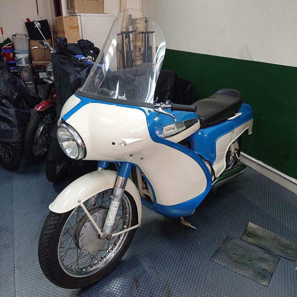

Hi Adrian,
You really do not want to remove the tinware from a Delux, the attached pictures shows what you end up with.
