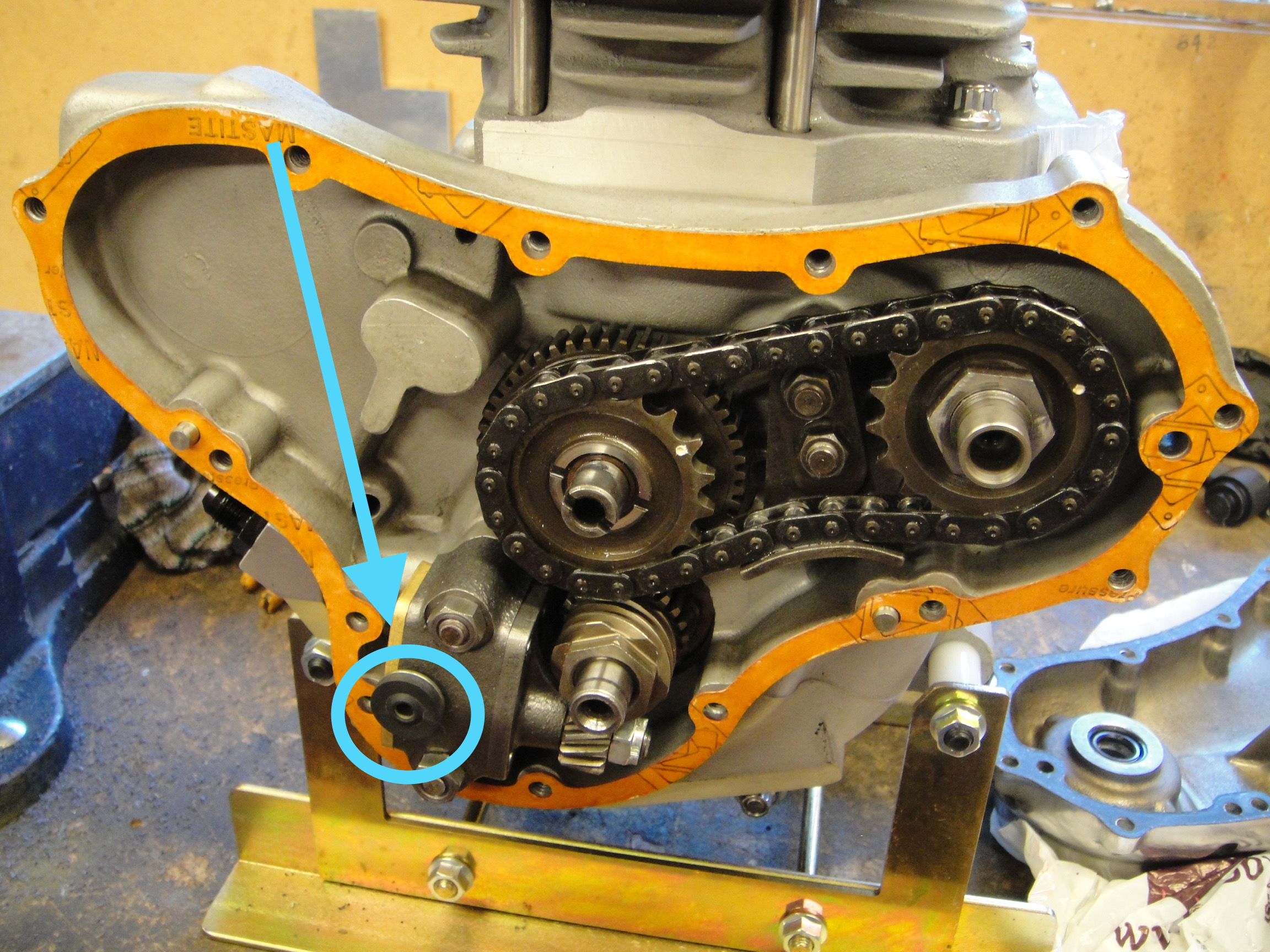

It is important that the oil pump washer is the bigger diameter, flatter one.
washer

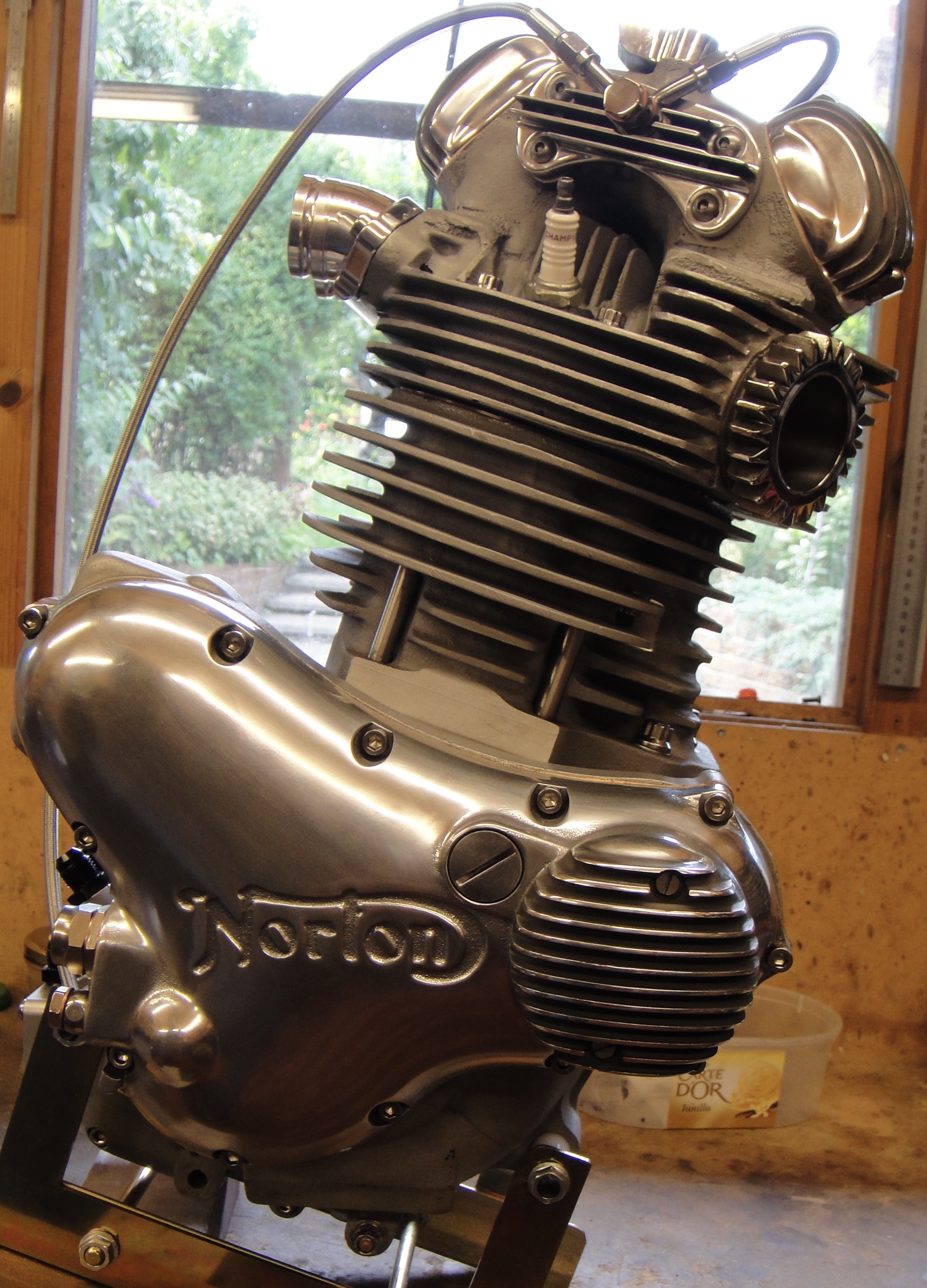

Here is my 72 engine with the MKIII cover
engine

Wow thats a smart looking motor! Love the finned rockers (Dunstall?), been looking for these for a while but nothings turned up. I've not seen that mod to the rocker feed tho? Where is that from?
Look up on ebay Norton Finned Valve Cover Set, and they are there . In the USA being sold by bsanut. I've had two sets off him, really good quality like all the stuff he sells. No prob shipping to the UK.
They are investment cast, and hand polished by Edward ‘Sir Eddy’ Billington-Smith who sadly passed away a few years ago.
To my knowledge he only made a few hundred sets.
He had some really interesting ideas around engineering, and getting the most out of a Norton twin which I found fascinating.

I have one fitted to my Mk IV 750. I bought it for the ability to access the cam chain and check the tension periodically without having to upset the timing by taking the cover off.

The Bsanut/ Eurotrash Jambalaya set is not the same although they,re very nicely made.
I bought mine from Sir Eddie after speaking to him in the USA by phone, interesting character. They have closer and thinner fins, very high quality and were quite expensive but well worth it.
I only bought  the three rocker covers preferring my existing rocker spindle oil lines setup with stainless Aeroquip fittings and the old Wassal partially finned ignition cover.
