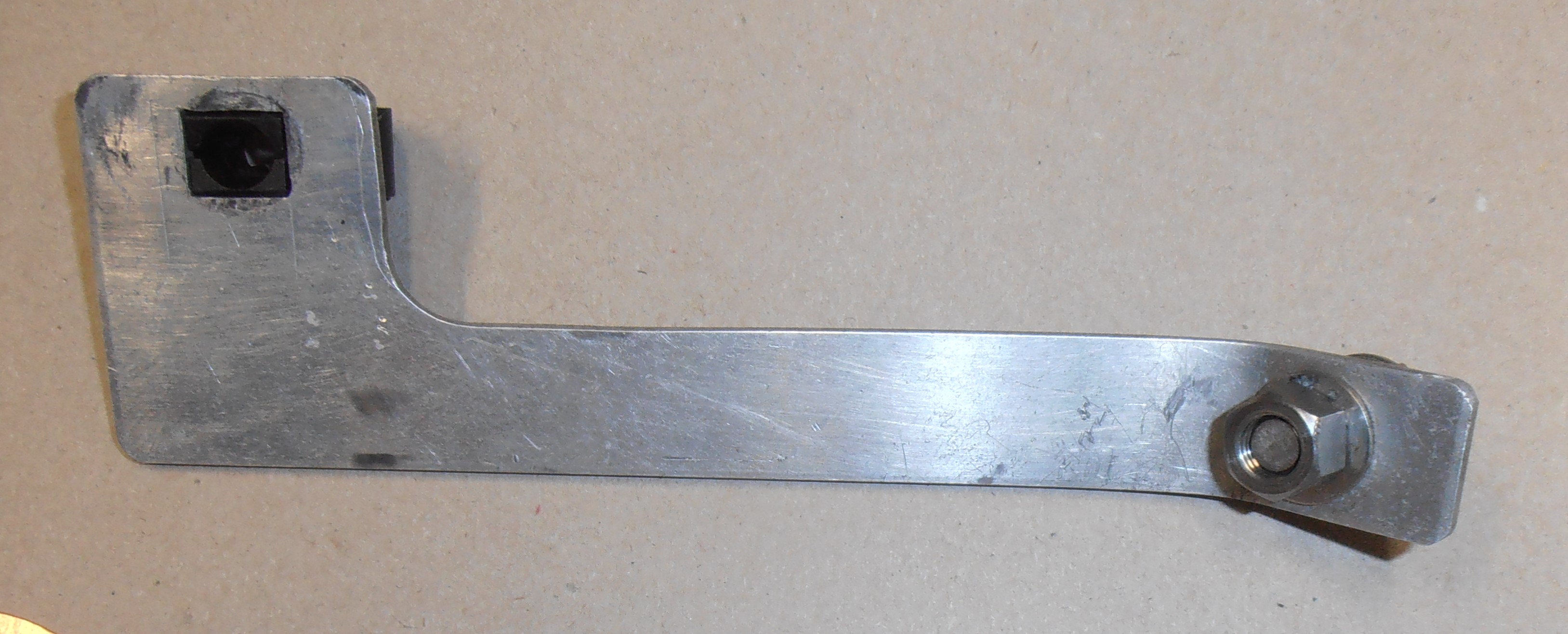

I am rebuilding my MK3 and am doing away with the Airbox, Oldbritts.com sell a bracket that holds the LH side panel when the airbox bracket is not there.
Unfortunately Oldbritts do not ship outside the US, has anyone got dimensions of the bracket so i can make one. I will happily pay anyone for a drawing that can help me make one as im not wanting something for nothing.

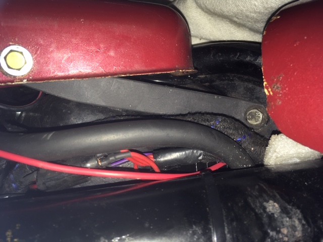

Most of us use whatever we have, Ian. I certainly didn't make a drawing !. I used a piece of dural sheet and filed a hole square so that I could continue to use the dzus fastener, but there have been several incarnations, dependent upon what was in the scrap bin.
It's easiest to begin with a cardboard template and offer it up.
Bracket
