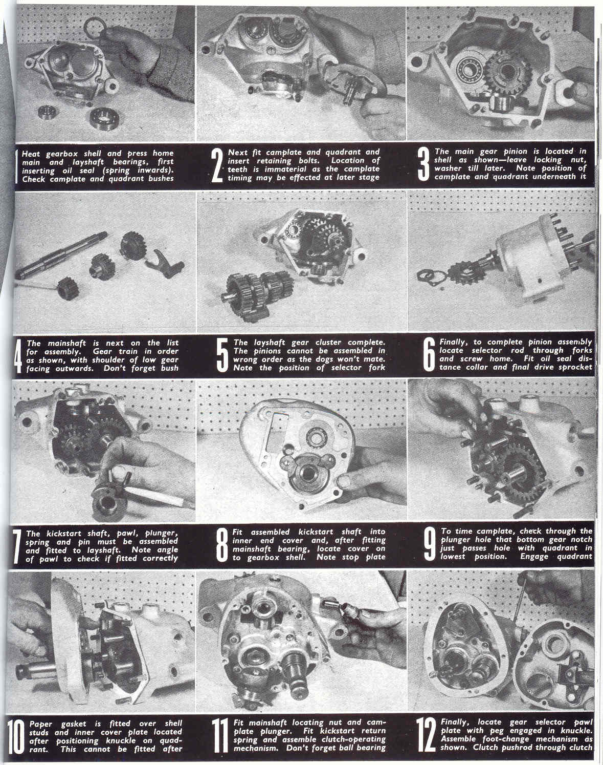

There is a procedure for getting the selector arms in position. It is best to mount the box vertical to help make the job easier.
The Layshaft should have its 3rd & 4th gears added and then it is slipped into its roller bearing. Next add a selector to the Mainshaft 3rd gear and the camplate.
Now add the last two Layshaft gears along with the second selector. Make certain that both selectors have slotted into the camplate. Feed the selector arms rod through each selector. You will probably need to wiggle or move the rod and arms a little in order to get the threaded end to screw into the casing.
Attachment is minimal but does help.
