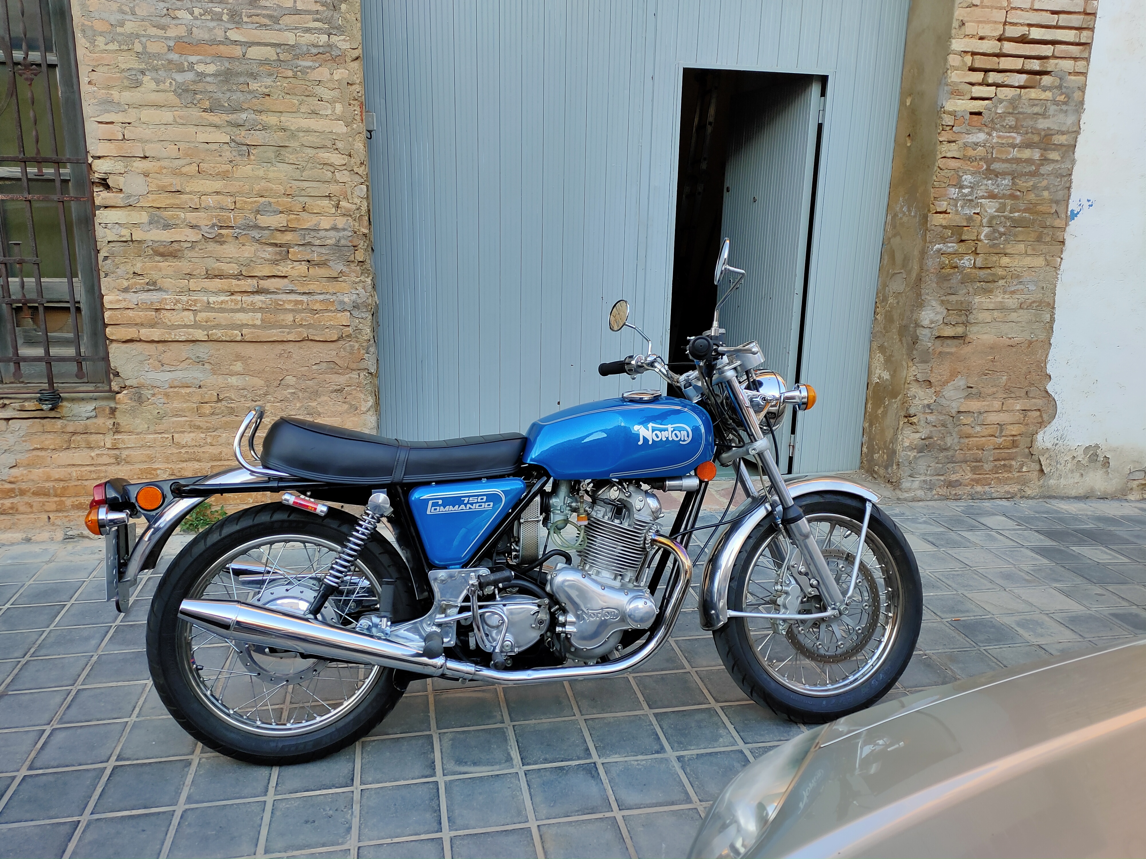

I have built a MK3 fork yoke on a 1971 frame what alters the angle.
First slow running in test rides up to 65 miles has not shown any strange behaviour
Any experience or comments welcome.

Can,t see any negatives but as you have done it you are the expert at the moment. I,d be surprised at any adverse effects on the road.
I,m doing something similar, but Mk3 yokes on an Atlas Slimline to increase trail and hopefully slow down the quick steering a tad.
850 yokes increase the trail by setting the forks at a steeper angle than the headstock thereby moving the contact point to the rear. This counters the large offset needed in the yokes to clear an Interstate tank.
I ran 850 yokes with a 750 frame on a race bike for a while. Steering was a bit slow and heavy but you might like the stability on the road. I fixed the heavy handling with smaller section tyres (100/80x18 and 120/80x18) and longer rear shocks.

It certainly is a bolt in operation, no custom parts required. Just checked the fit of a new Mk3 yoke and spindle assembly in my 1965 Atlas slimline stem and they go straight in. No mods required using the same taper roller head bearings. The Mk3 bottom nut can be used so the assembly will be identical to my Mk3. The steering head stem on the slimline Atlas and Mk3 frames are the same length at so my setup will be similar to Martin and Stan,s Commandos.

The new 750 yokes offset the forks  forward by more than the earlier ones to clear the Interstate tank. The 750 yokes ran the forks in line with the steering axis which remained 63 degrees. There were complaints about wobbles and tank slappers. The Interstate was initially 6 gallons but was reduced to 5.25 gallons, by slimming the top section, which helped as did fitting a 3.60 TT100 on the front. But mostly the wobbles would be blamed on Isolastic adjustment, swing arm pivot wear and bad load distribution. I remember putting a heavy pack on the rear rack and not being able to ride off it was so bad; moved the pack to the tank and it was ok (750 Roadster). It was widely joked at the time that running your Commando into a wall would improve the handling.
On the 850s the steering angle was changed to 62 degrees which together with the revised yokes increased the trail and made them much more stable.

The MK3 geometry is no different to the pre MK3 850 geometry. When you follow a 750 on an 850 the difference is notable, the 750 turns in quicker. The change was made to try and remove the wobble when applying power when coming out of a bend.
