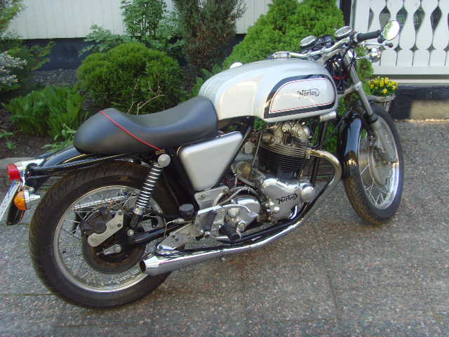

I have main jet:320,pilot jet:35,needle jet:p8,needle:6DP1,air jet:0,7 and slide:2,5.
Workin but not very well,plugs are almost snow white and fourt gear i can reach about 4500 rmp.How does that air jet works?-only with main jet or also with idle jet?.

The plugs are champion 7 NYC and i think these should be ok.I have ported cylinder head and PW3 camshaft-maybe one carbuertor does not give enough fuel.The cylinder head air(gas/ mixture flow is 38% better now before porting).

Ok,you are lucky man,my problems continue,i got my record today:80mails/h-there must be something wrong in my Mikuni...
With Q-5 needle jet and 6DH3 needle i finally got black plugs,even on second gear speed was 70m/h,looks good.
