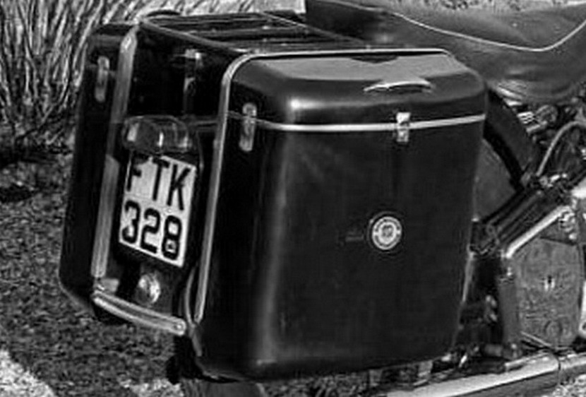

I have attached a photo of a well used 4-pipe Ariel Sq4. The owner fitted a Craven bracing bar to the lower backs of the panniers, which prevented them from waving about. It meant they were no longer QD, but this chap thought nothing of riding from Somerset to Edinburgh, or around the continent, receiving long distance awards along the way and said that bar was well worth fitting.
Paul
I have the same brace on my bike, Its a standard fitting and was also fitted to my 88 back in the day. They were QD as well , but i can't remember how the brace allowed the QD to work.
Robert Tuck previously wrote on Tuesday April 24th 2012 at 19.04hrs:
.....................................but i can't remember how the brace allowed the QD to work.
Hello Robert,
No, I meant that fixing the brace to both panniers like that ensured that they were no longer Quickly-Detachable, until you'd fiddled around for a few seconds unscrewing it.
Paul
