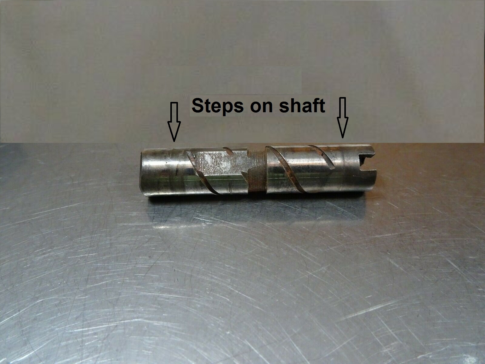

Put the dodgy side on compression and pull out the exhaust rocker spindle.  Check this spindle for steps near to each end for wear that has left a small ridge or step.
If there is bad wear in the form of a step or ridge, this may be the cause of the click. This is not uncommon on low pressure return fed rockers. A worn oil pump leads to poor scavenging, which in turn leads to a poor rocker supply. Especially on a cold engine start-up.
A  rocker that is not sufficiently lubricated will wear both the spindle and the rocker itself. See attachment.
