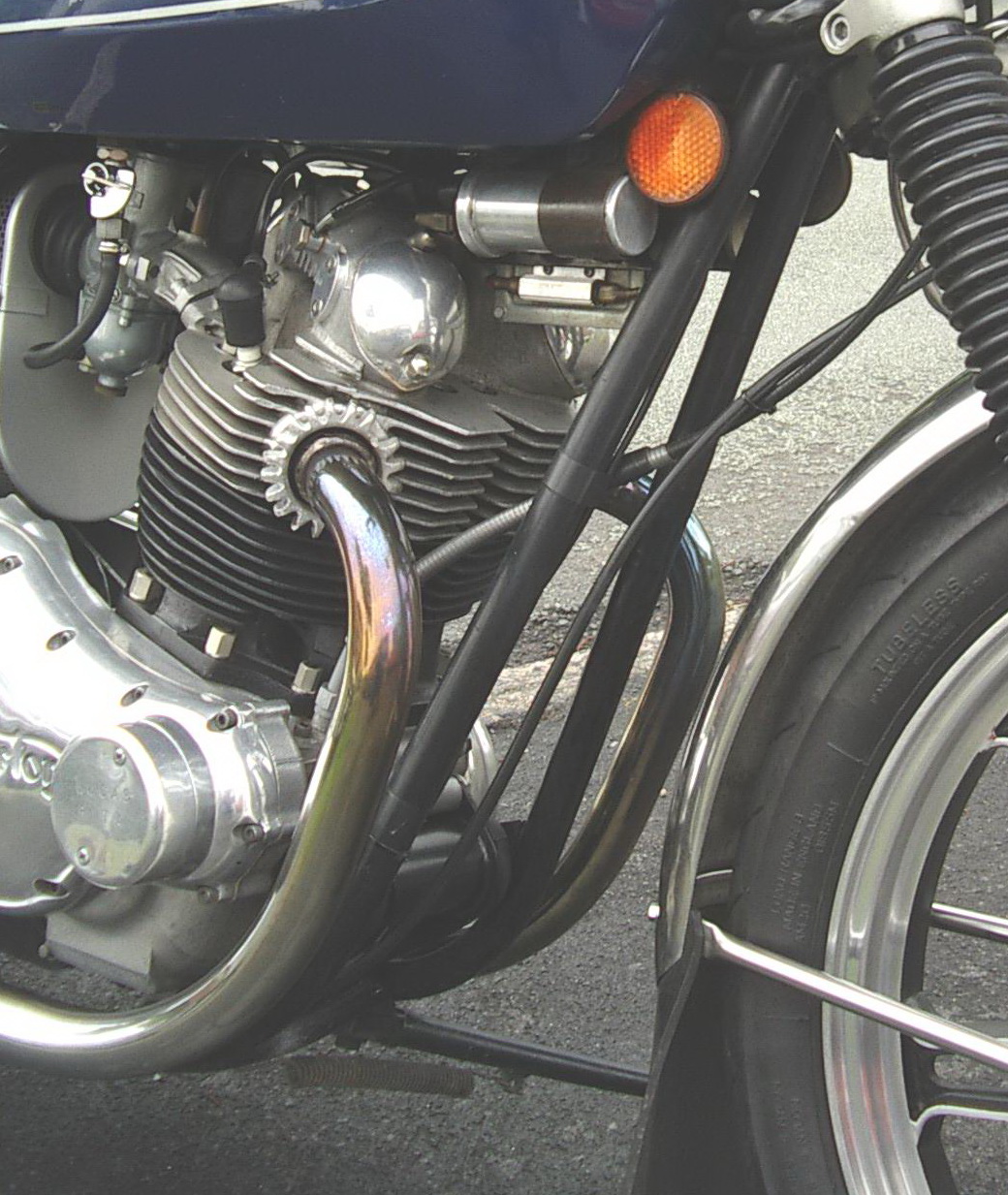

Didn't the protective shroud arrive with the 850 balance pipe exhausts ?  If you're not running balance pipes then you certainly don't need the protection. I haven't used one for years. Original 850 cables had a swaged cup for the lower end of the reinforcement which I haven't seen for years. Tacho Cable

My '72 Tacho Cable does have the metal protective sleeve. I am pretty sure it's original as I have no recollection of ever replacing that cable.
Looking at the brochures the metal sleeve appears to have been fitted from the beginning. Although it is not present on the first bike shown at Earls Court.
