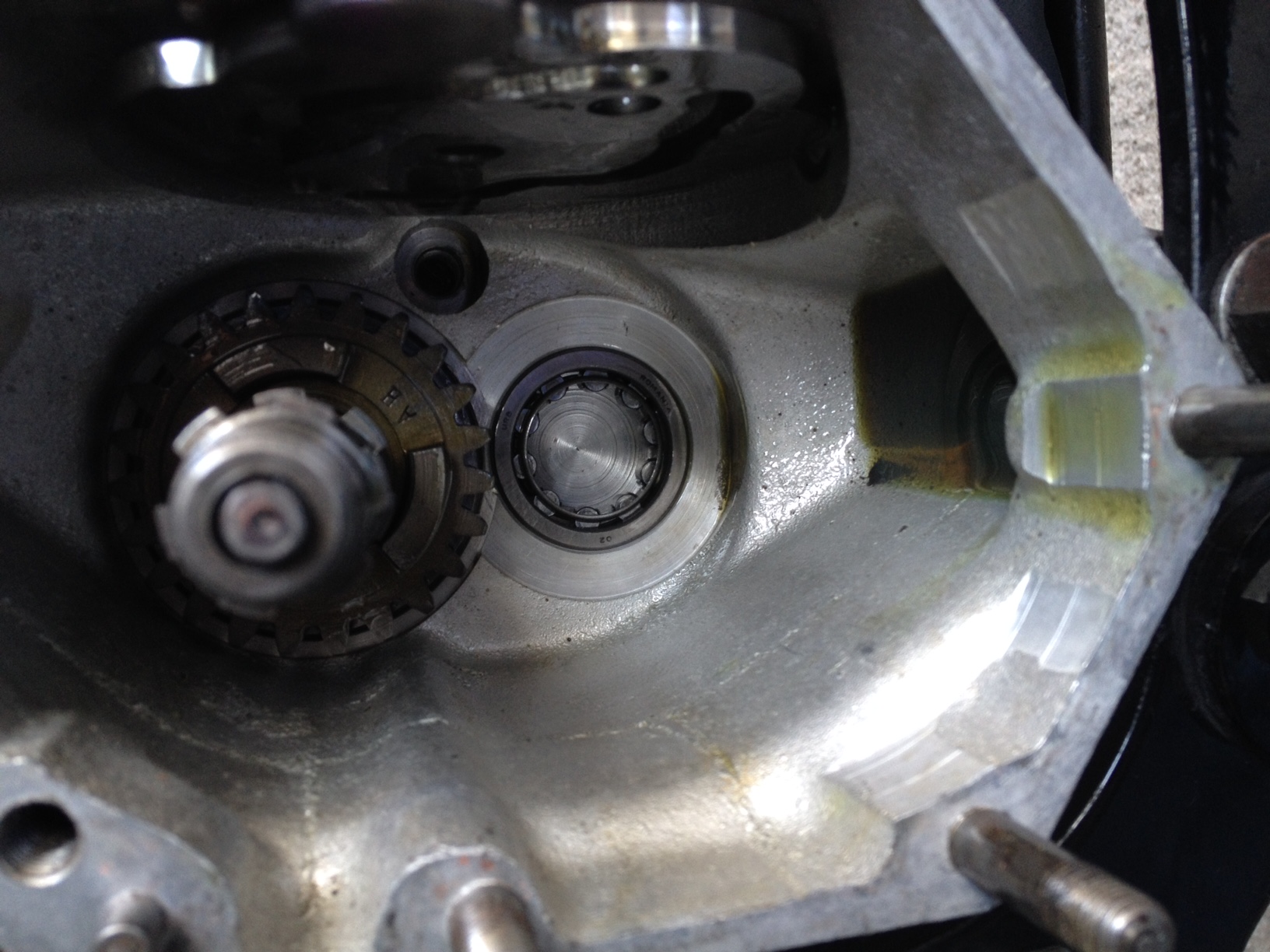

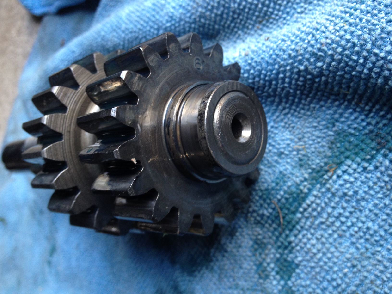

Hi, I have the gearbox ope…
Hi, I have the gearbox open now. Does the gear look worn enough to replace as well?

Paul: You might get away w…
Paul:
You might get away with just renewing the pawl as it is seriously worn.
Nice photos by the way. What camer are you using?

Hi Mike,Took with an older iPhone 4S.
Previously AJ Walker wrote…
Your gear looks like all my first gears. I would go ahead and use it. It is a lot harder metal than the pawl.
