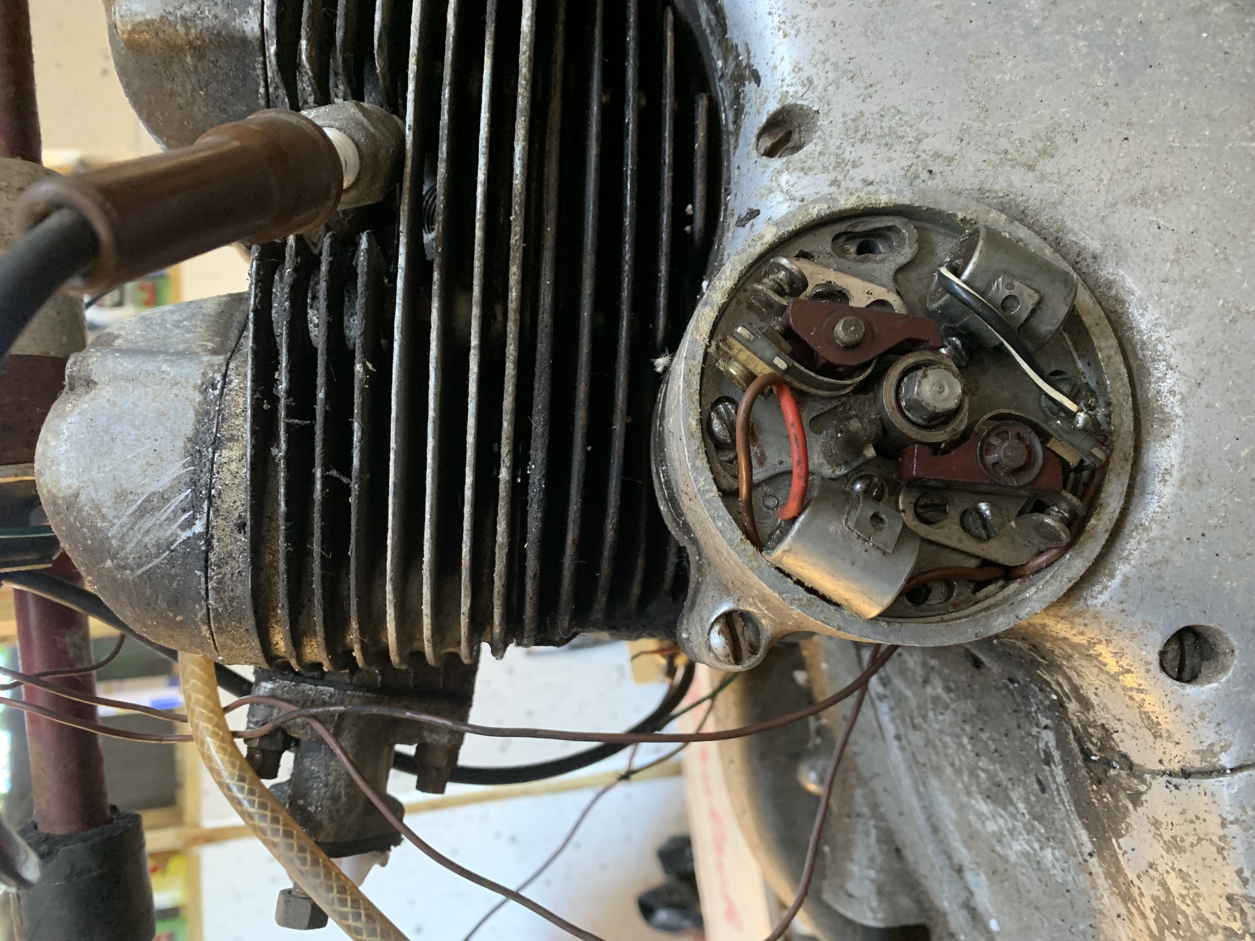

Hi I’ve just joined the Norton owners club as I’ve bought this Jubilee  and I was hoping for some help to get it running and eventually looking a bit tidier, It’s got good compression so not seized up.
I have some basic knowledge of mechanics but not enough for this job but willing to learn,  Basically the first issue I’d like help with is to get a spark, What are the basic requirements it needs.
Theres no switch anywhere other than that on the headlamp,  As you can see from the pictures it has the coils and points and a few wires here and there but no battery, does it need one to get a spark?

Welcome to the club. You have a nice challenge there. I suggest you get a good owner's manual. I think there might be one available from the club document repository. You really need a wiring diagram to see how things work together.
The alternator provides the power when the engine is running but you need a battery and voltage regulator to supply the coils that generate the spark. The points determine when the spark is produced for each cylinder. The alternator charges the battery.
Looking at your photos I would recommend in due course a new wiring harness (available from NOC shop) a modern voltage regulator and, if you can afford it, modern electronic ignition to replace the points.

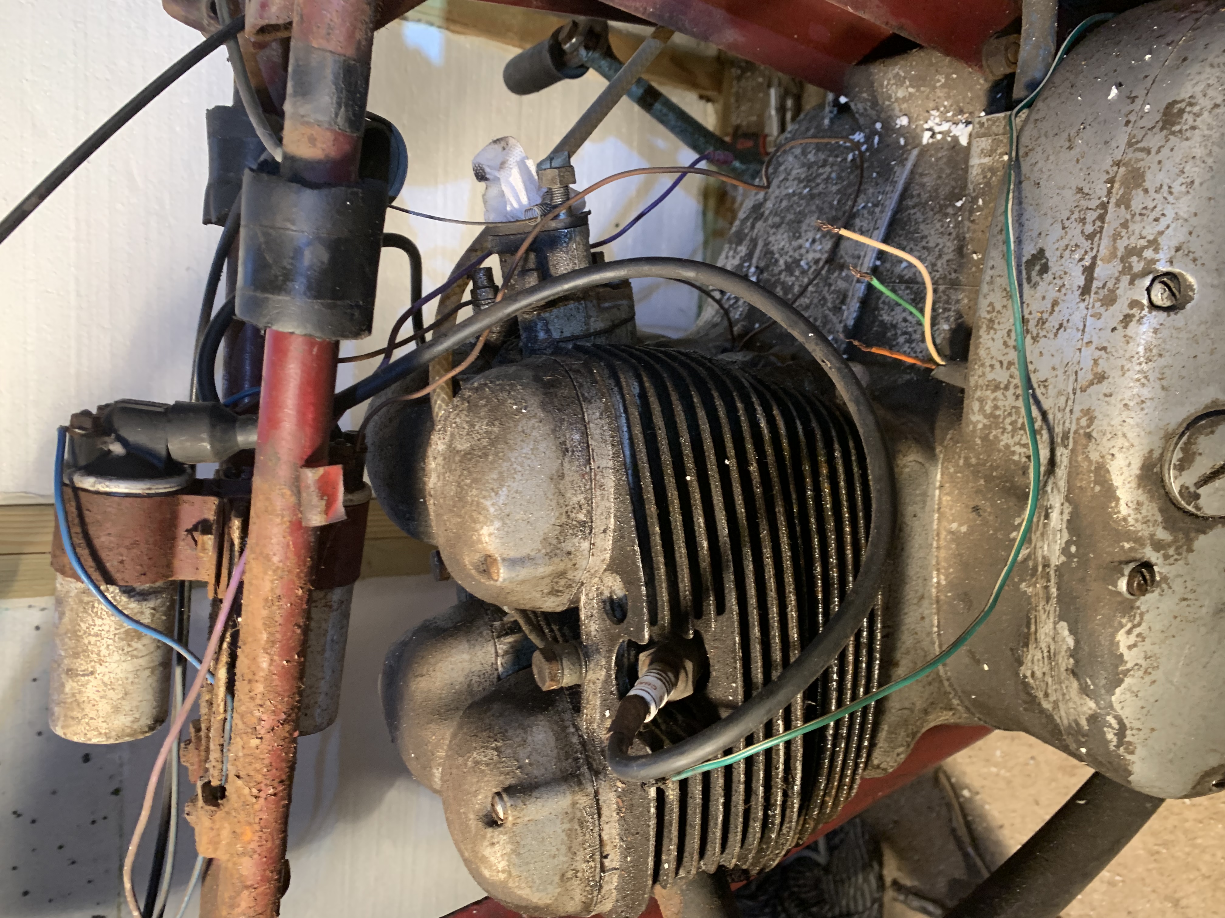

So I would connect the battery + to the brown wire on the coil in the picture and the battery negative to the blue on the coil Is that right?

The wiring loom looks home made so the colours may not be correct. At the vey least you need to check a wiring diagram and trace the path of each wire. Also, looking at the rust on the coil connections, you will need to clean each cable termination to get a good electrical contact. This is especially true of the battery connection to earth on the frame. If you have a multi-meter or a battery and bulb you should check that each wire is not broken inside the insulation by checking continuity. As Dan says help from a friend is a good idea and a second pair of hands will help.

So I would connect the battery + to the brown wire on the coil in the picture and the battery negative to the blue on the coil Is that right? Not the way to go. The original wiring had a GREEN connection to both coils fed from the ignition switch, this could be the BLUE wire, this would be the battery negative (via a clip-becomes the ignition switch!) and the battery Positive goes to earth. There is no loom as such on this bike, just a few 'casual' wires, fine for a startup. BUT seeing the work involved and the condition is this recommended? How much water has been in the sump?
Very important -removed the sump plate/filter and see what comes out? If it is mostly water based or serious sludge then do not run it, you could cause more damage. If it is mostly proper oil then maybe try a start.   Best of luck. (you'll need it!)

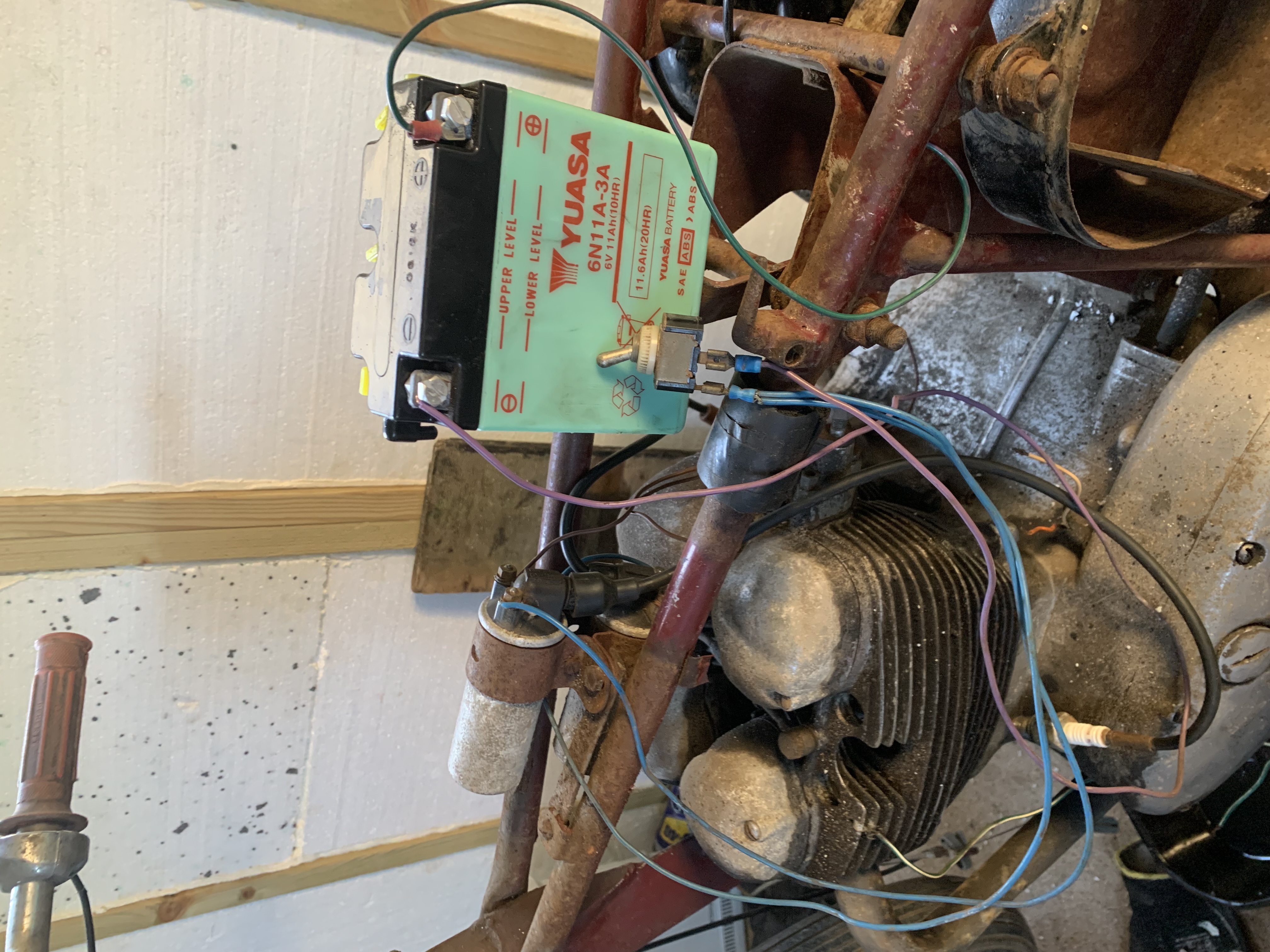

Ive now got a battery and have cleaned up all of the wires and connections,
The bike already had a switch on the head lamp (which I presume was the ignition switch)with a purple wire which I presume went to the battery negative, well thats where ive put it, and 2 blue wires which go to the coils (Pictures attached)
I earthed the battery positive to the frame
Is this the basic configuration of wiring to get a spark ?
Any advise appreciated

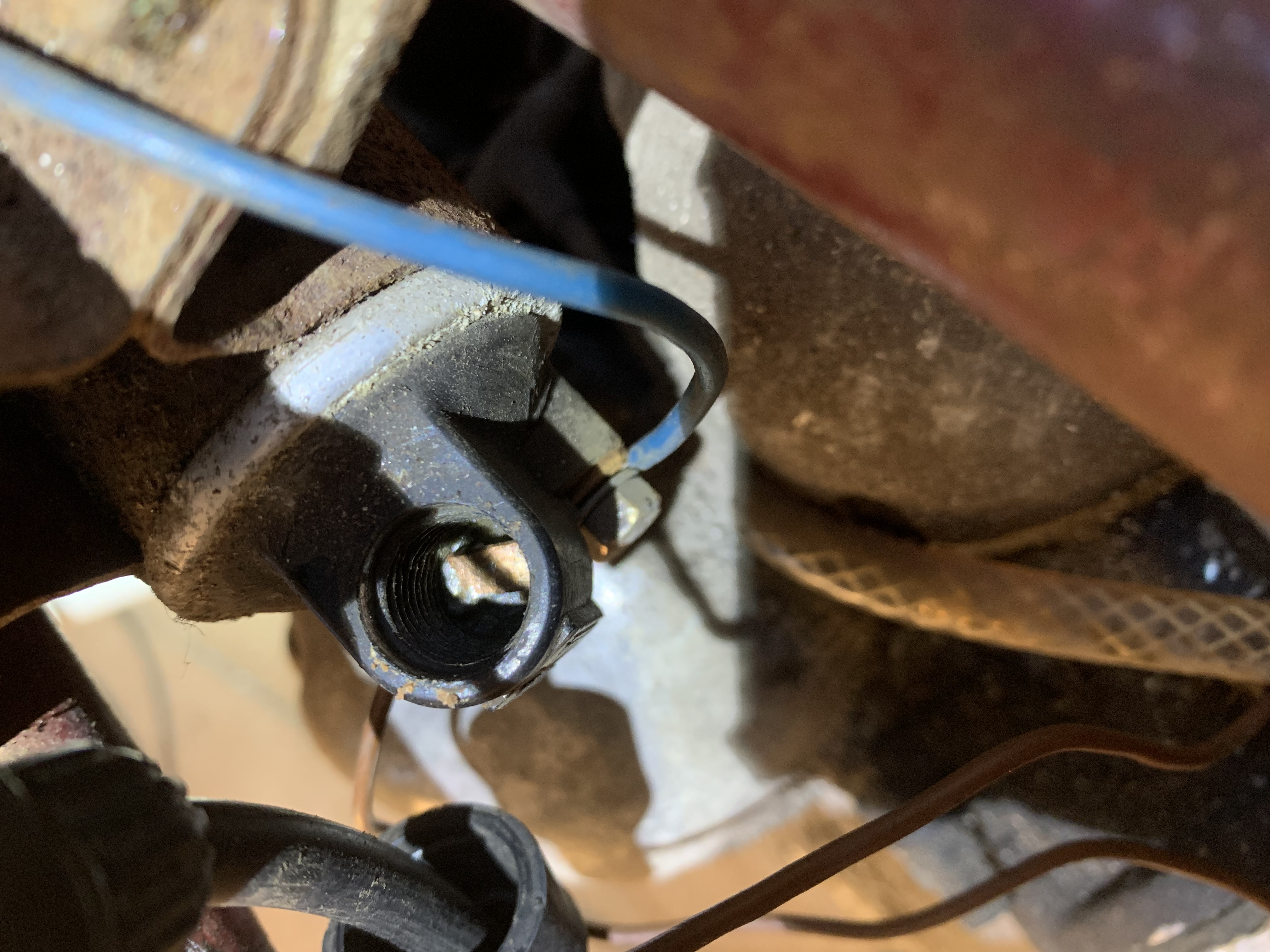

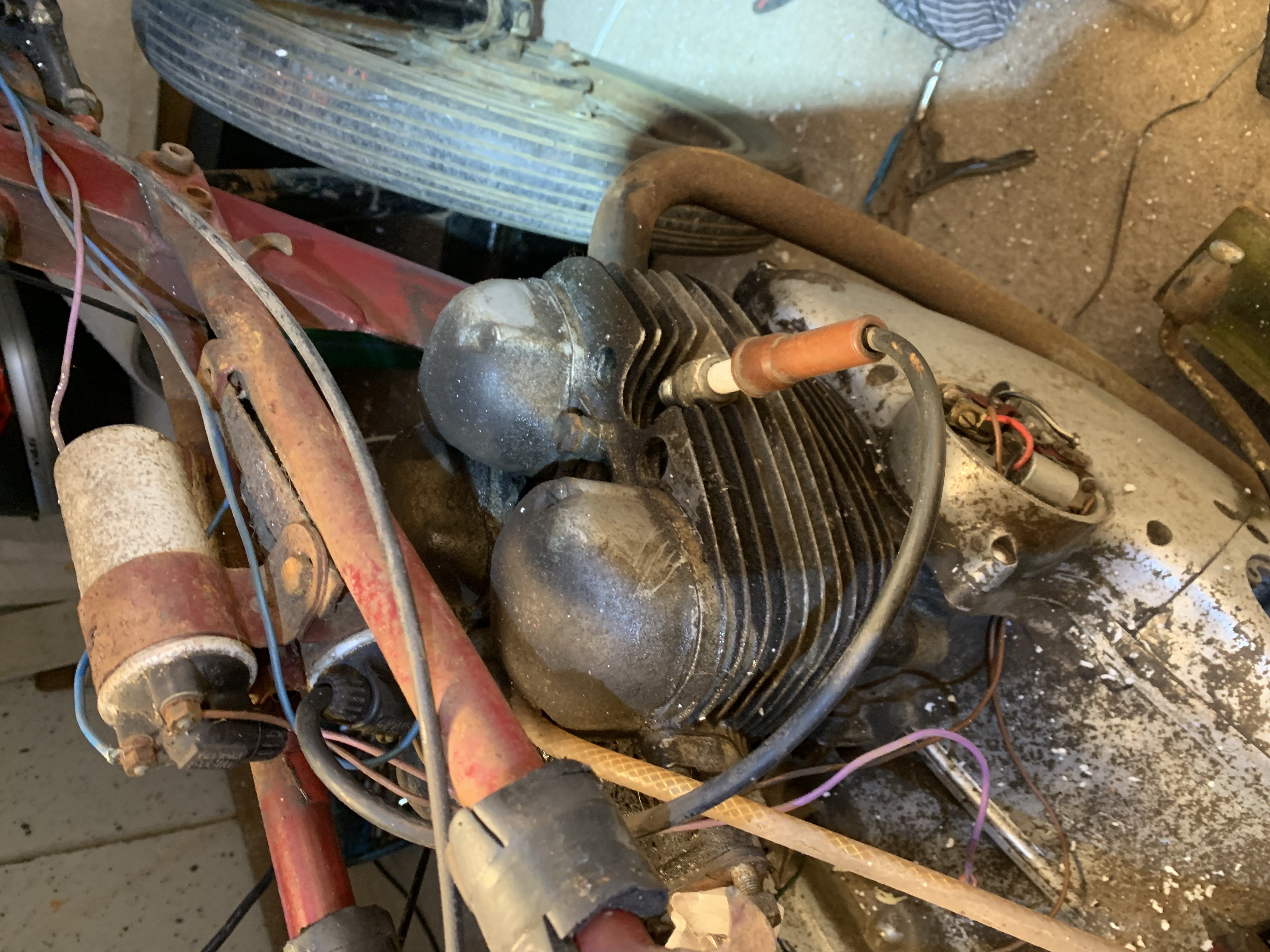

Hi, make sure ignition points are gapped properly and clean(points looks suspect in latest picture)as well as any wire ends where corrosion is evident. A prior picture shows corrosion on blue wire to upper coil. Good luck with the initial startup -Pat
Cheers Pat I’ve now got a spark on one plug, on inspecting the other lead and coil I noticed the contact in the coil had broken off so the lead wasn’t connecting,so I’ll get a couple of coils this week if I can find some.
the points cleaned up alright so I’ll stick with them for now.
You won't get Wipac ignition coils. Lucas (type) will have straight end terminals which are a nuisance under the tank. Spending money on coils at this stage is potentially a waste of money. Suggest an enquiry within the club if any ones has a Wipac 6V.
Stick with a pair or 6V Wipac if you can. Your last picture doesn't show any broken wires. But the Blue wire is still corroded, remove, and reconnect would be useful.
