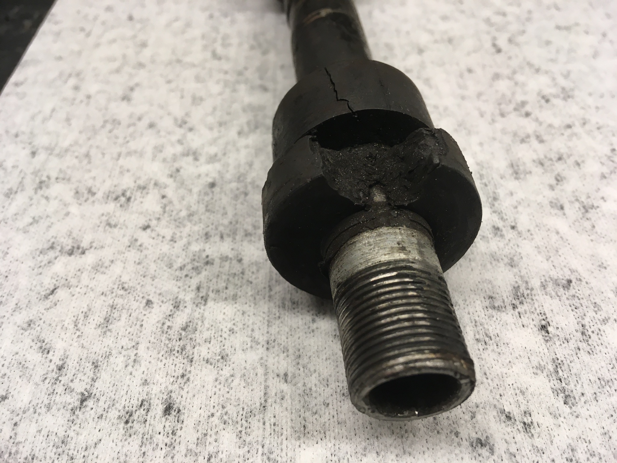

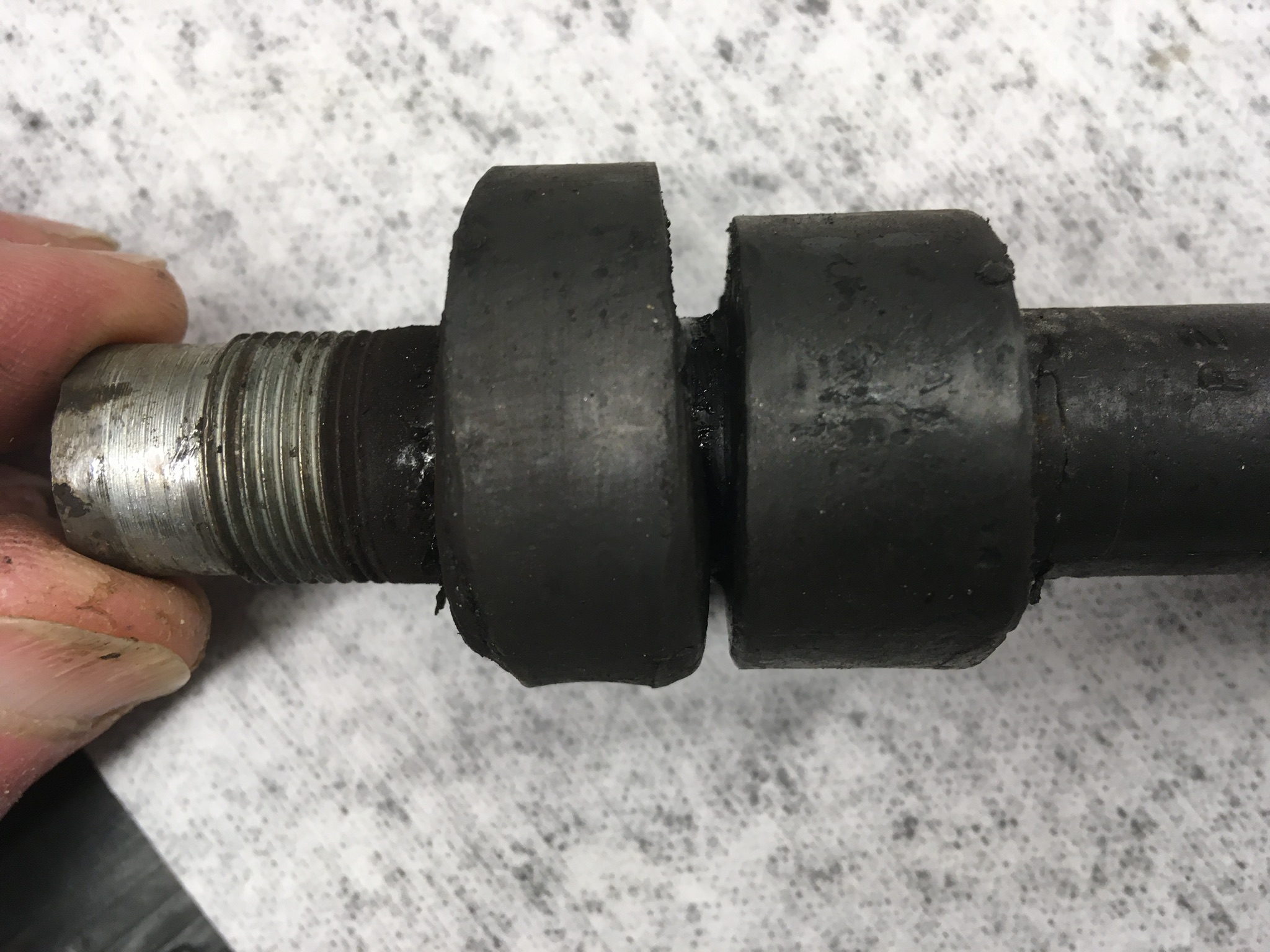

Rainy day so thought I would remove the old ISO’s today.
I had to take the primary off to get full access by dropping the engine down using the front ISO as the pivot.
My old rear ISO’s had collapsed, so that the bolt was way off centre in the tube. I thought you may be interested to see the rubbers.
I had a chunk missing from on rubber that was just dust in the tube. The first photo shows how the end rubbers had flattened to the same diameter as the smaller inner rubbers. No wonder the vibration was so bad!Collapsed iso
Chunk out of iso rubber

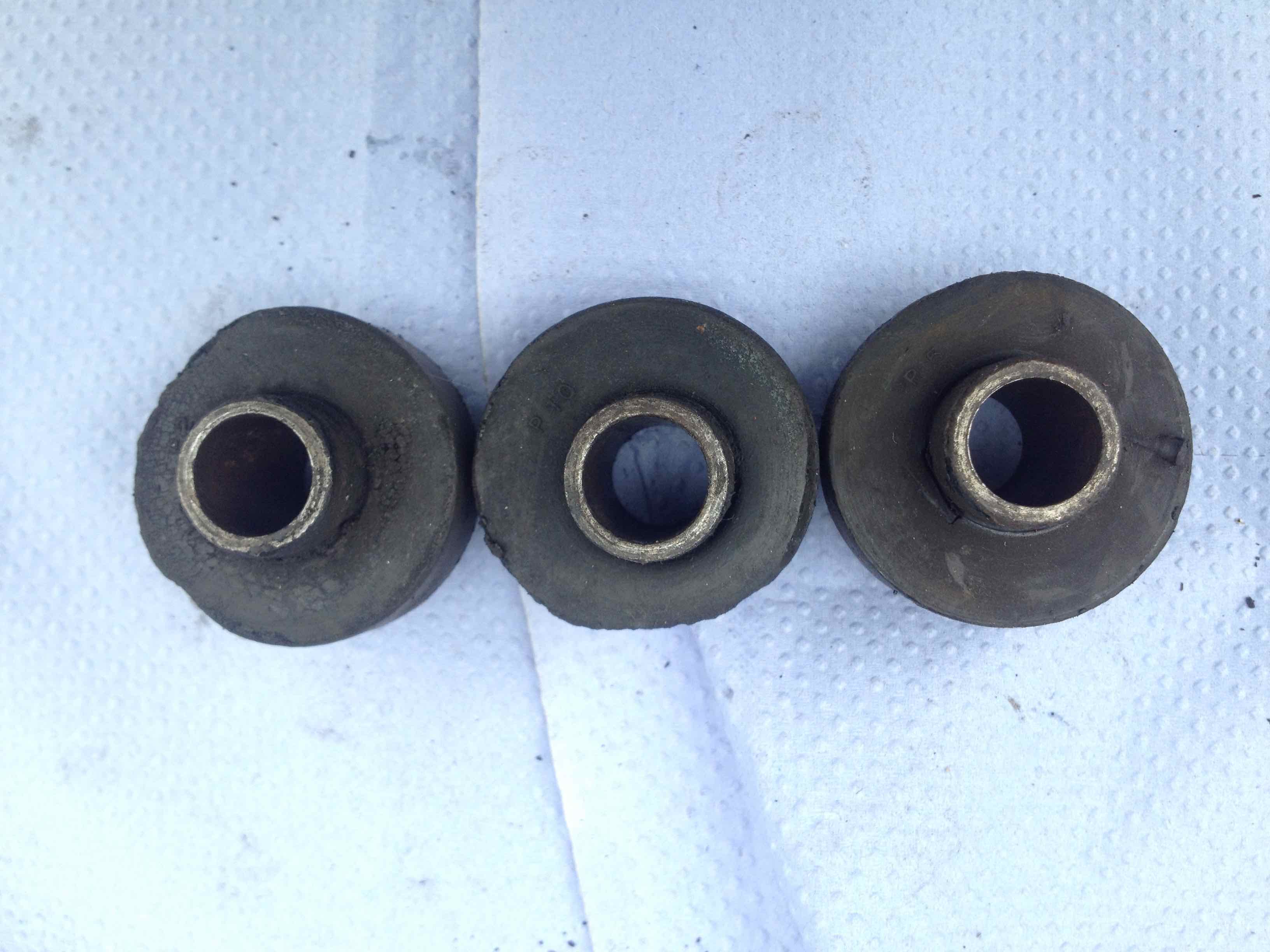

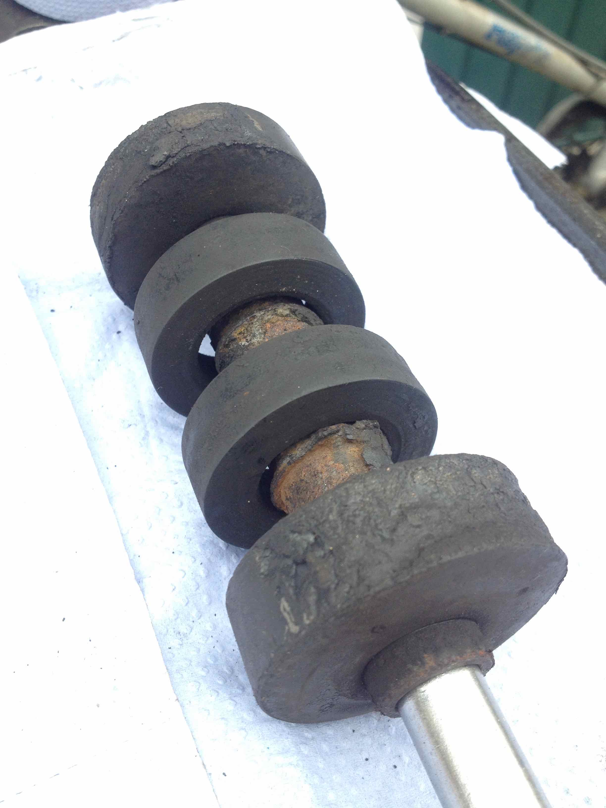

These were the isolastics in my brothers 750 which had been re-imported back from the states....
solid steel!
750 isos
Julian,
He got it running for the then owner who had just bought it as a US import then decided to buy it off him. It had been "customised" in the best American tradition so he wouldn`t have been seen dead actually riding it like that!
