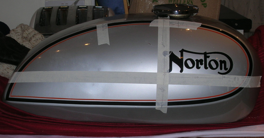

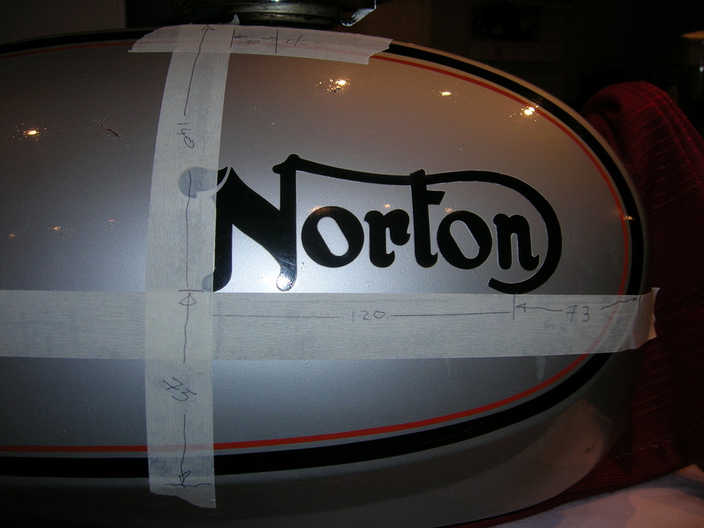

Believed to be from a standard bike.Another
... but I think they would look better a bit further back and maybe slightly lower. Having said that I spent ages shuffling mine about on the ES2 till I was happy. Still better than choosing the right Arden Green for my Fanny-B however.
I have to agree with Ian, I put mine further back and got them made up smaller which In my opinion looks better.
They need to be far enough forward to be in front of your knees, don't they?  Otherwise people might think you are riding a H****?
I think I remember reading they were applied on top of any tank lacquer.  Then they can be replaced if they fade - or if you aren't satisfied with how they look.
I think your positioning look about as perfect as you can get.
