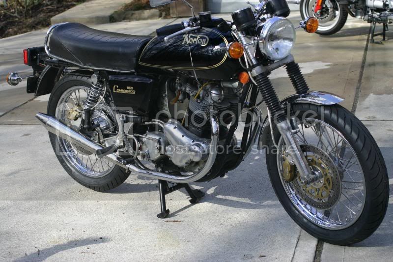

Hello i am looking for buy this tipe of handle bars suitable for disk brake .
do know someone tipe or identification  number ?
Tomas

Brian these are higher and wide too much i thing that i have now on my commando these
https://www.rgmnorton.co.uk/buy/handlebar-27-5-wide-x-4-5-high-european-type_2347.htm
iam looking for same lower and narow but useble for disk brake

Pic looks to be a Mk 1 850 to me.

Alan yes i sometime ride fast and on my commando is too windy :-) my bars i think are us version .
Tim thanks for info i have mk2.
Tomas
mistake sorry mk1 year 73
