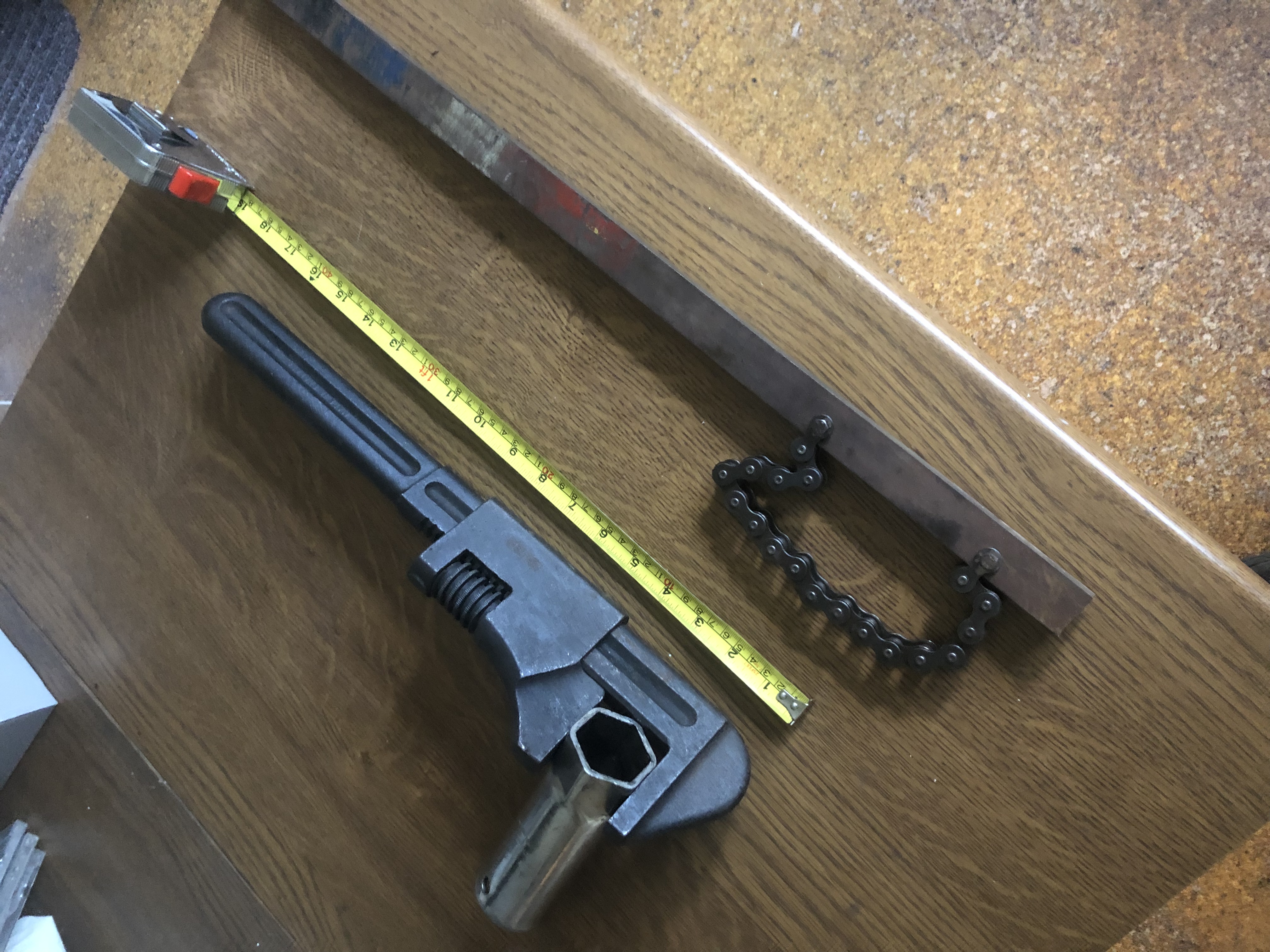

The wrench I use on the box spanner is substantial (see photo) so can get a pretty decent torque when the sprocket is locked with the tool shown in the photo.  The wrench jaw width leaves just enough box spanner protrusion to engage adequately and be reasonably square on the nut.
I flipped the lockplate, reduced the tightness slightly and it now lines up nicely.  Hard to say what torque has been applied, but given the length of the wrench, I would guess around 40-50 lb/ft.  I agree with you, the nut should be tight enough to securely clamp the sprocket to avoid shuffling and potential shaft spline wear.

I've just looked at my torque wrenches which I use for check-tightening. My Superslim only goes up to 50lbs and is 13" long. The big Norbar starts at 60 lbs and is 22 inches long. I think that you certainly need something between those two to reach 80 lbs. I find it rather difficult to assess torque with an adjustable...too many things moving about..
