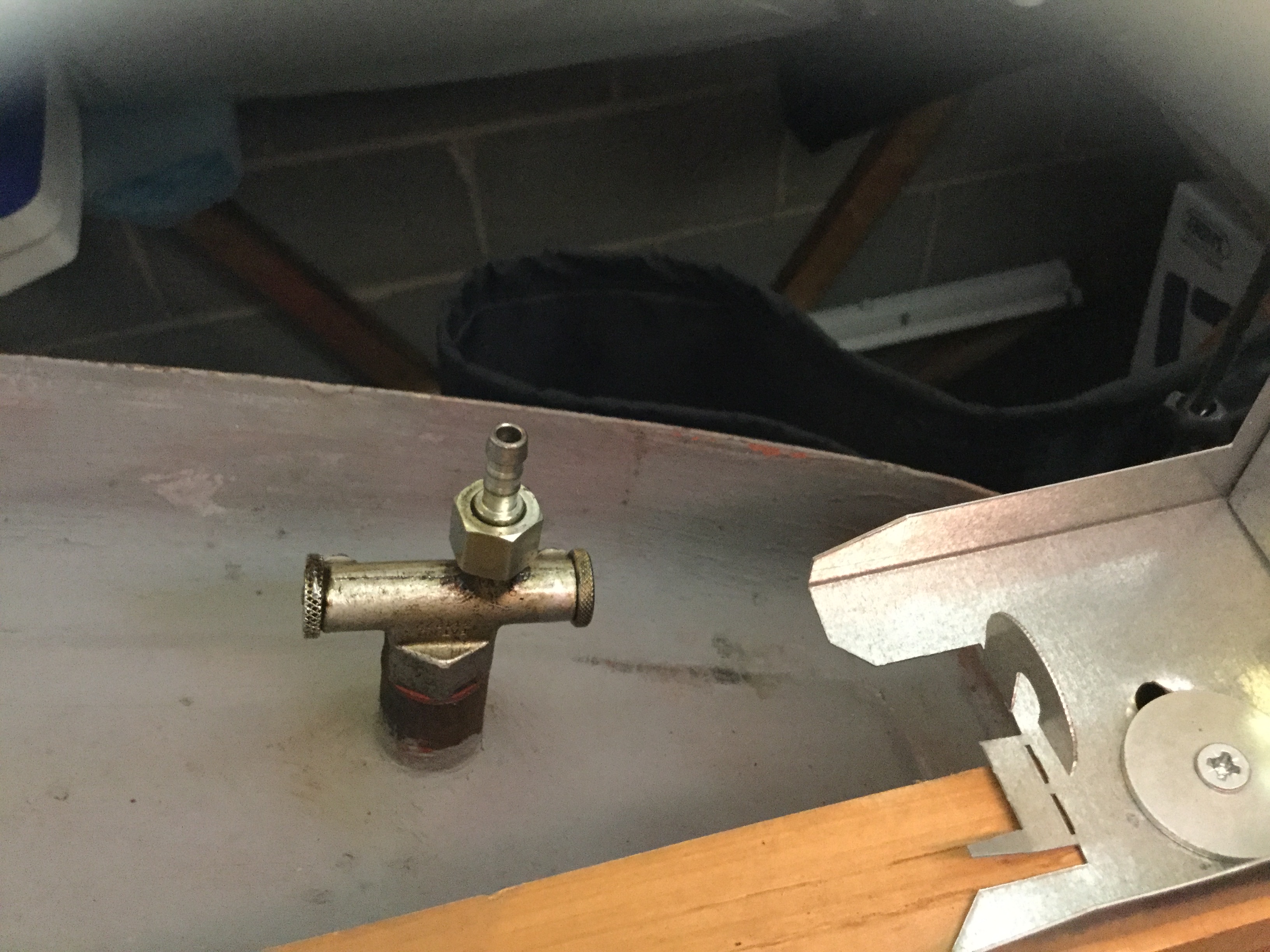

After seeing the Ace Classics tap, and realising that I would also need an outlet tube and nut, and the price was now at £50, I decided to adapt the BAP type tap I already had (modern fuel safe) to fit properly. The following is not for the purists, but for the riders.
I purchased from a plumbing shop a brass 1/4"BSP nipple, running nut and ferrule. The ferrule is 30mm long, so the perfect length to clear the frame tube. (See Parts 1)
I then soldered 1/3rd of the nipple into the ferrule to make a solid assembly.
I removed the filter from the tap and found it was a perfect 'snug' fit into the nipple (Assy 1).

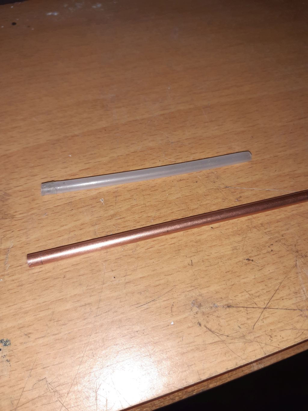

I checked the length that the ‘main’ tube would need to be and bought some 4mm copper tube from a model shop. (See Parts 2). The tube was a light “tap” fit into the fuel tap, and was cut to length to suit.
I then assembled the tap onto the nipple/ferrule assy with a new washer, and then offered the assembly into the tank, with a new rubber/copper ‘crush’ washer above the nut.
I had to back off  ½ turn from fully in to get the tap pointing outwards, and nipped up the running nut.
Result? See Tap fitted pic. A fuel tap that does not leak, is accessable when riding and cost a total of £9 in parts.
The reserve supply volume I don't know yet, but the pipe extende into the main tank 27mm above the tap boss, so perhaps 2-3 litres is available - certainly better than no reserve!
