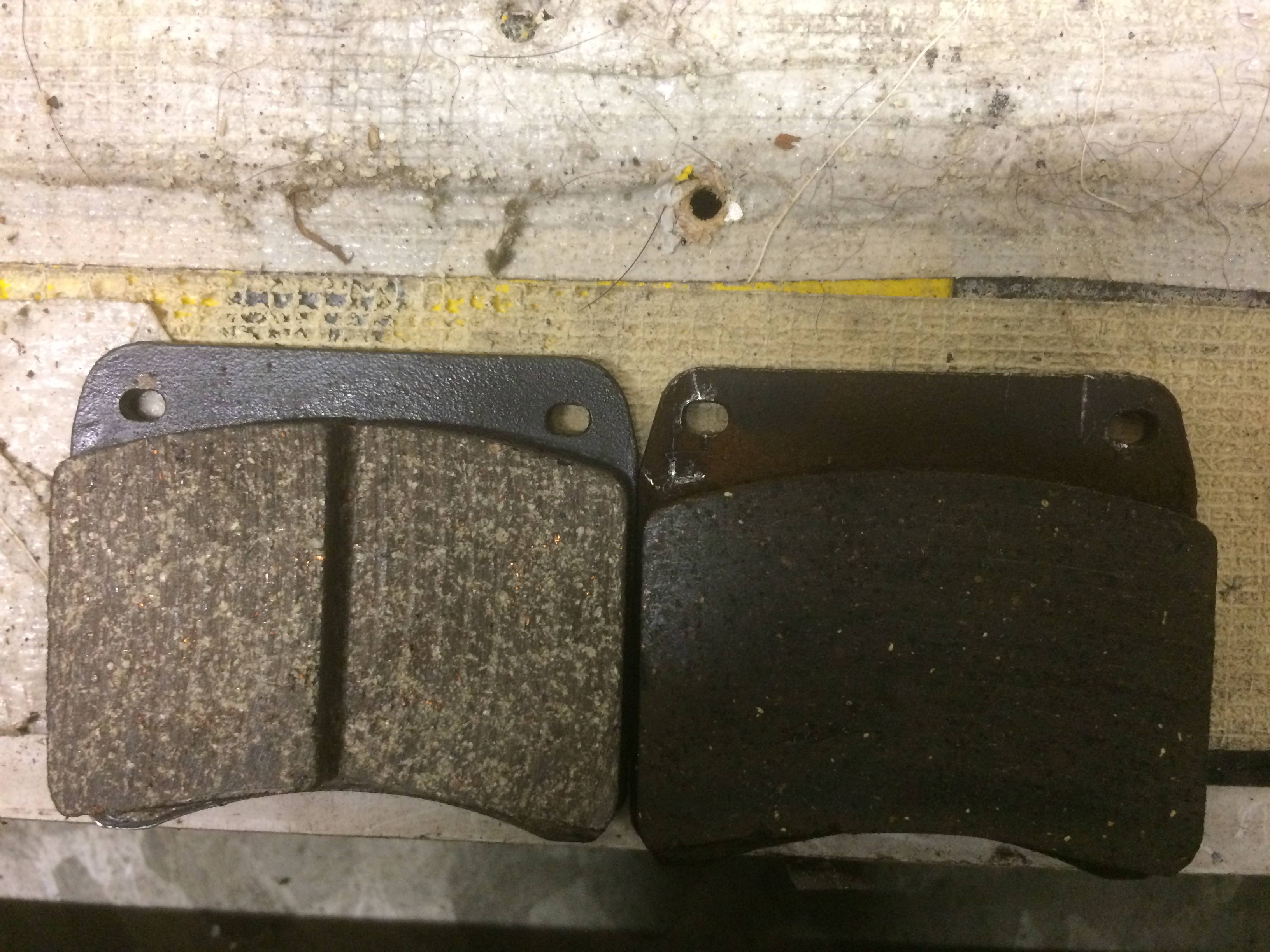

Following valued responses to my initial question, I was having a dig around in the shed this morning and came across two disc pad sets, one part used, the other brand new. To my delight, the new set was identified as EBC FA16S. Had I bought them but never got around to fitting? Sadly not. They looked good but didn't fit. Pad area looked good but the pad material was not "deep" enough on the backing plate. Even with the calliper touching the edge of the disc, the pads still had about 5mm overhang. See pic for pad comparison. Why I still have them is a mystery?

there is only one AP caliper size in that external design. Pads touching buttons: a slight chamfering of pads  by filing should solve that. Position of caliper left or right is mostly a matter of personal choice. Sizing of bracket will not be overly stressed. ( behind leg is slightly less rotational inertia when steering, due to fork yoke offset)
on the edge, not friction face, obviously!!
... having that "overhang" issue on my Commando with Lockheed caliper. I just cut the excess off with a hacksaw......
So which EBC pad - or other make - fits this calliper?
The pads I use are FA16HH. If the pads 'overhang' the disc then the bracket holding the caliper is wrong. The first bracket I bought to mount the Lockheed racing caliper was like that. Needed to take a bit off the top edge of the friction material, which I did for a while. I made my own bracket in the end which put the caliper further on to the disc and cured the problem.

I got my 16HH pads from RGM at a very good price I must say and fitted them. First thing to notice was the pad area is smaller on the new pads. They fitted my set up perfectly without overlap on the outer edge, and I would suggest they are a couple of mm clear of the floating disc rivet springs. How much this smaller pad area affects the braking I can't say - but it must increase the load per sq ins?  Yesterday I took the bike out for 150 miles around the local Dales - aiming for a coffee stop at Slaidburn. The brake is transformed. By the time I was on my way home I was easily coping with the challenges of steep downhills and tight bends with just a slight touch of the front stopper. As to whether it would actually squeal the front tyre - I don't know and hope I never have occasion to find out! Most of my motorcycling life has been spent trying to keep the front wheel rotating under all circumstances and find myself reluctant to change this approach at my advanced years!
