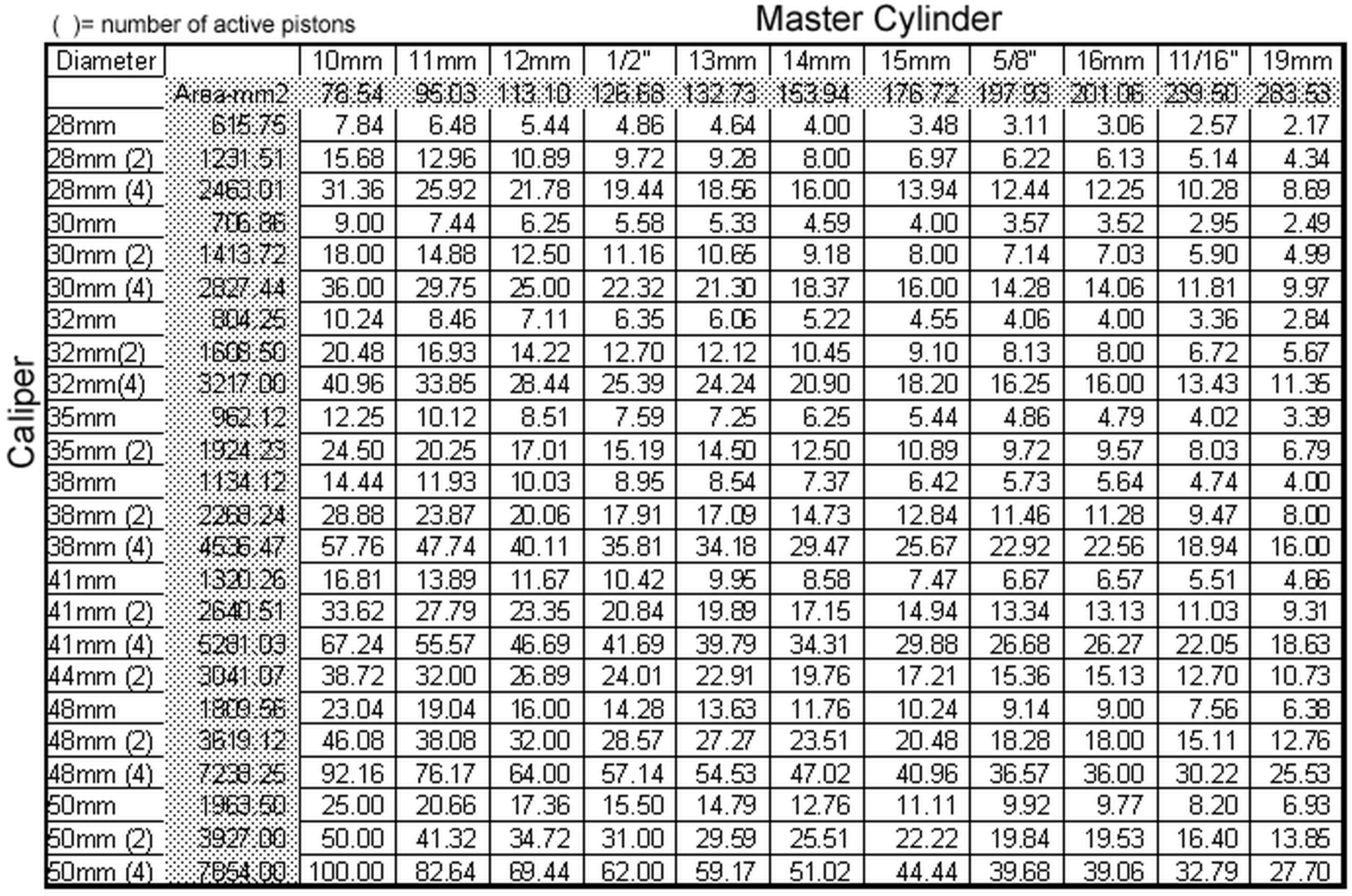

Here,s a useful chart from the old Vintage Brake website in the USA. Good info and advice.
http://vintagebrake.com/mastercylinder.htm

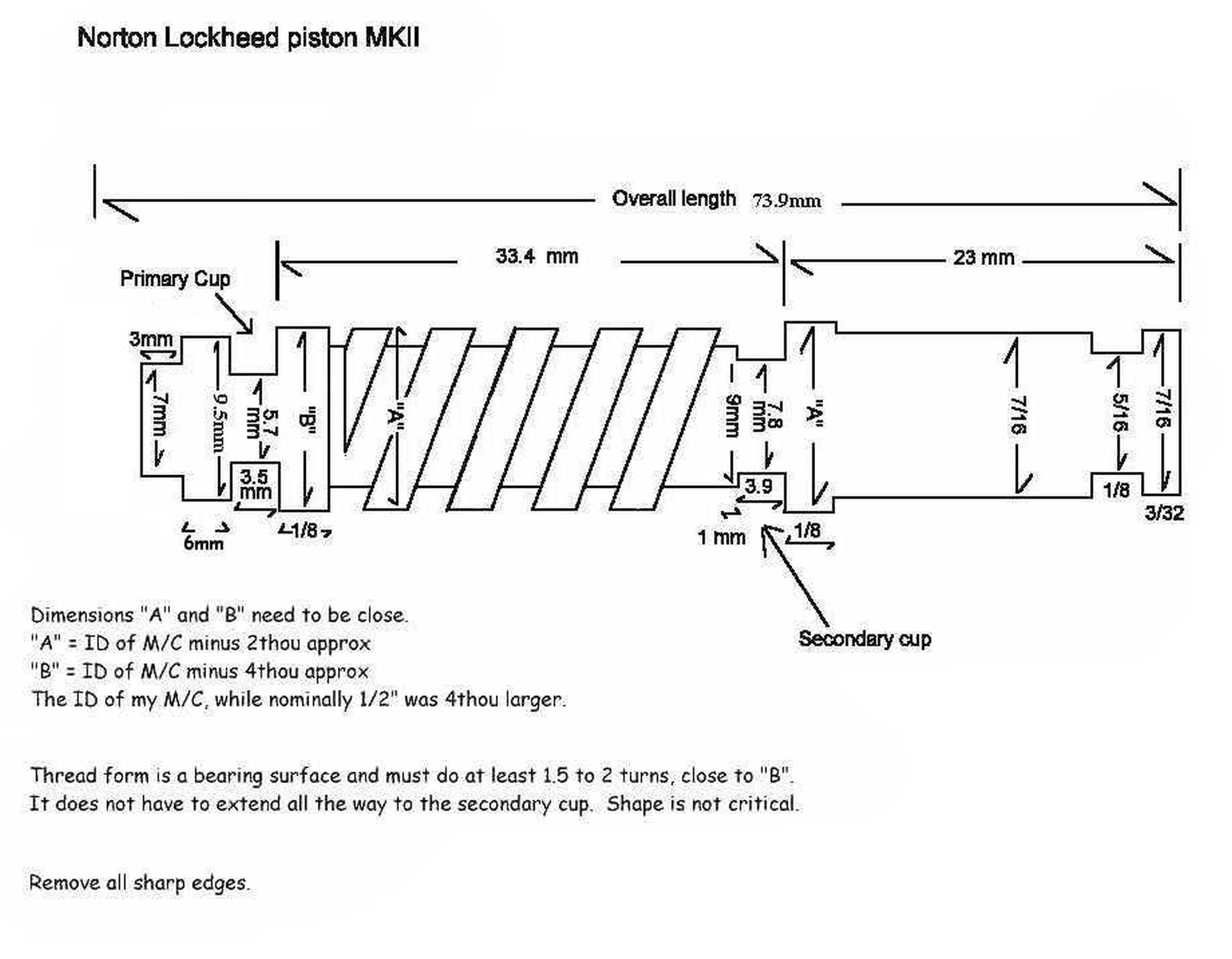

I went for a 12.7mm bore based on the Vintage Brake recommendations on Neil's link. I made my own alloy sleeve and modified a 12.7mm shaft with seals to get the seal and relief area's in the same position as the original. That gives me a ratio of 25.5 with Brembo P30/34 4 piston caliper.
I have attached a drawing of the original shaft and of the ratio chart as it may disappear soon.

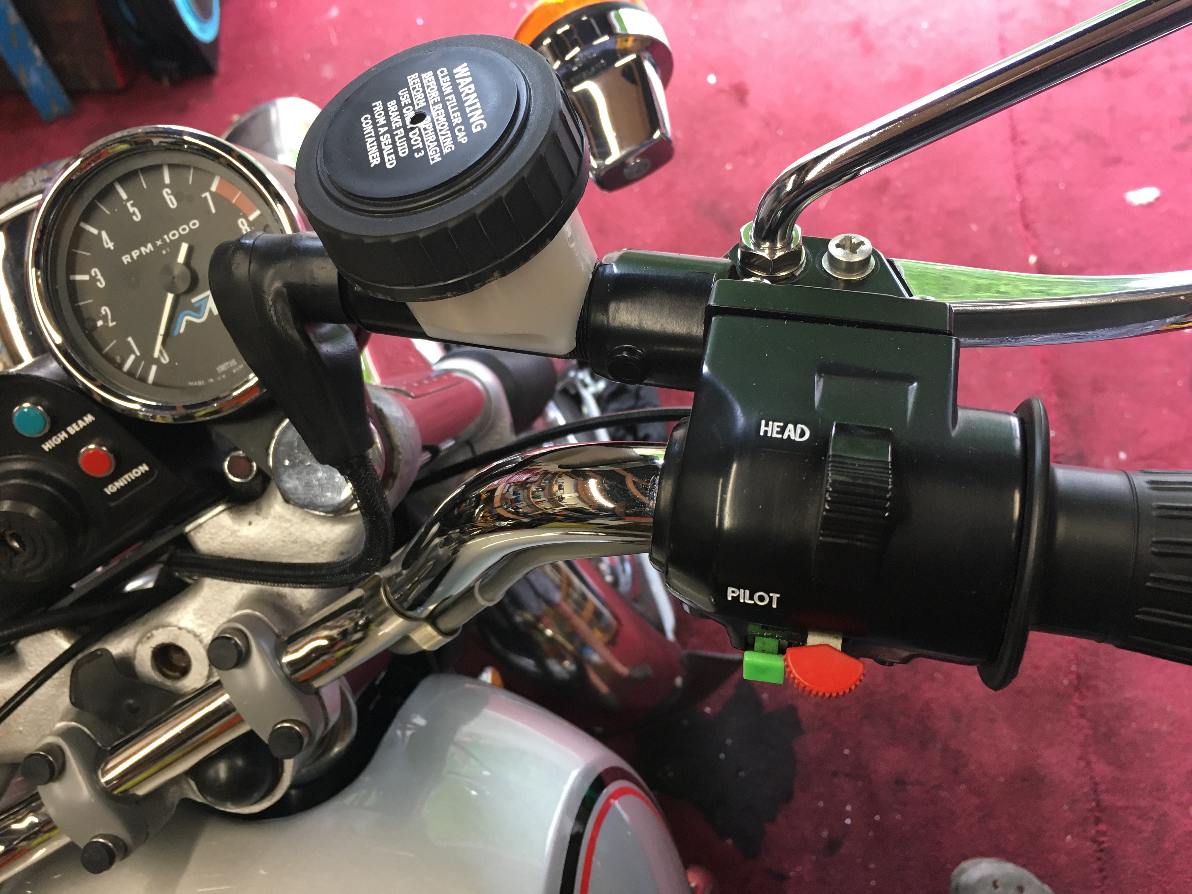

The action is solid and instant compared to other set ups and the bleeding of the system was easy. The lever on the master cylinder is an exact match to my original clutch lever.

Installed
Thanks for the picture Brian, definitely something to consider.
I notice that the switch and brake bodies don't quite line up. Is that a new switch unit as well? It's in remarkable condition if it is 45 years old.
And you also have the chrome steel brake lever rather than the alloy one in Andover's picture. the alloy lever looks just like the Commando one so I guess it would be possible to use a Mk3 lever to reduce the reach.

The lever is alloy and matches the original alloy clutch lever exactly.
Switch is original - didn’t notice the slight edge on the fit.

Just a trick of the light then. I did look at various Triumph master cylinders and saw that some, usually for earlier T140/T160s, had chrome steel levers with a linkage the m/cyl piston.
Judging by the bits we can see in the pic, your bike looks like it just came out of the showroom - puts mine to shame.
