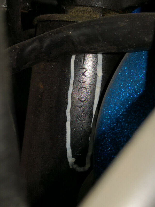

I am looking at a rare 1969 Norton R 750.  There is no aluminum ID plate on the head stock as I have in my 70 roadster. I think it is original as it matches the engine number.  I have enclosed a picture.  Any thoughts if this is the way they were identified in 68 69.  I seem to remember my dad had a 68 fastback and if memory serves me well it was on the head stock like the pic
Dave L
What your pix shows is what I have seen before. Your  VIN/serial# is very early MY(model year) 69 according to published charts.

Thanks David.  I asked the owner to check the head stock and make sure there are no holes where the later ID plate would be attached to.  My Roadster is a 70 and has the aluminum plate so I agree it is a very early 69 before they went to the plate, so I think it is safe to say that it is legit and not something that has been messed with.
