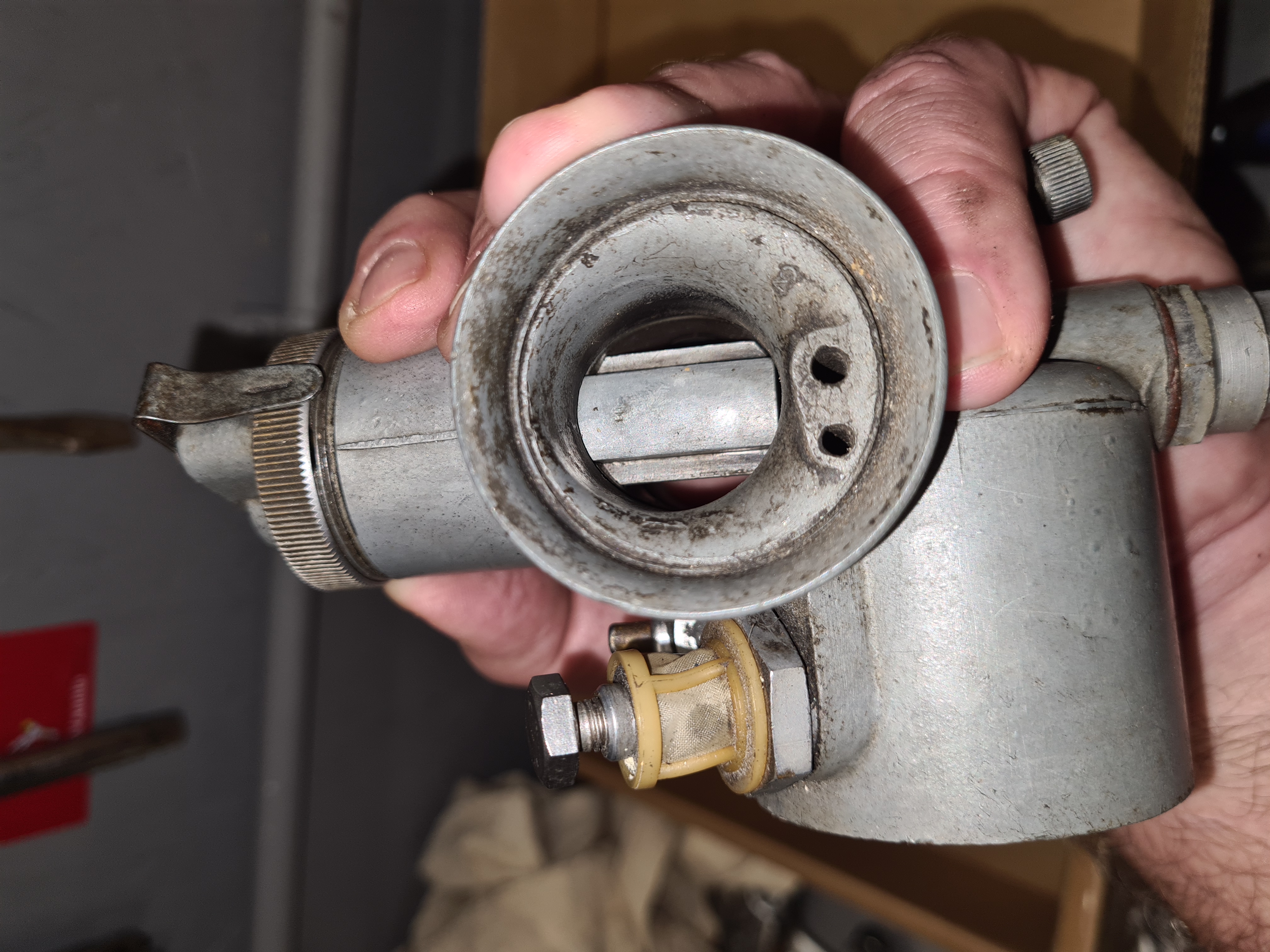

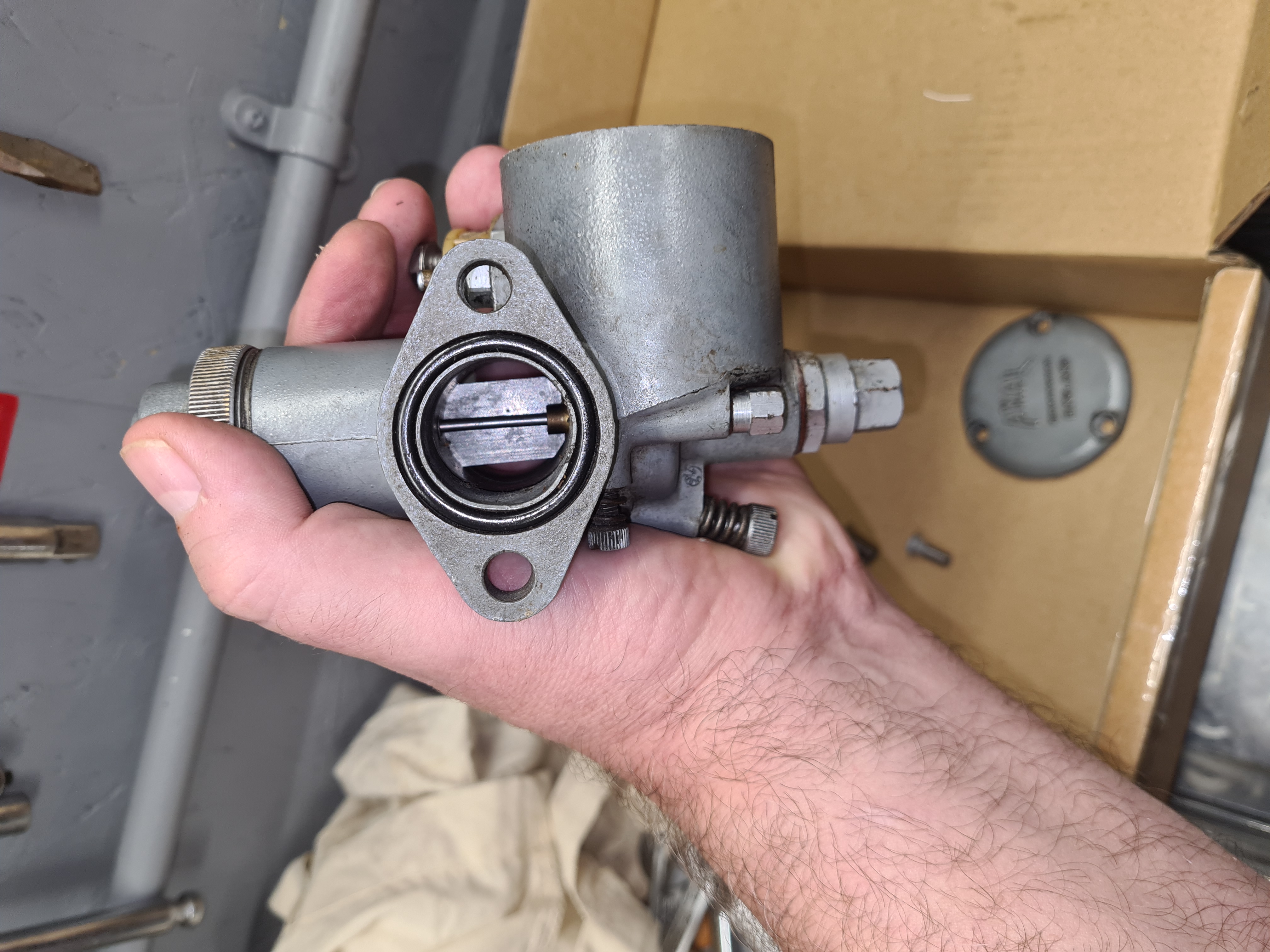

Took the carb off tonight as I need to find the exact model so I can order the missing banjo and the refurbish kit. I have found a banjo on Ebay that fits 375 376 389 600 900 NORTON so I guess its one of these?
Overall condition dirty and looking at the float bowl its probably not pretty inside and my uncle probably didn't touch it. The slider inside moves and springs back but not as smooth as I expected so it will be taking a good long soak in my sonic bath then finally flushed through with carb cleaner.

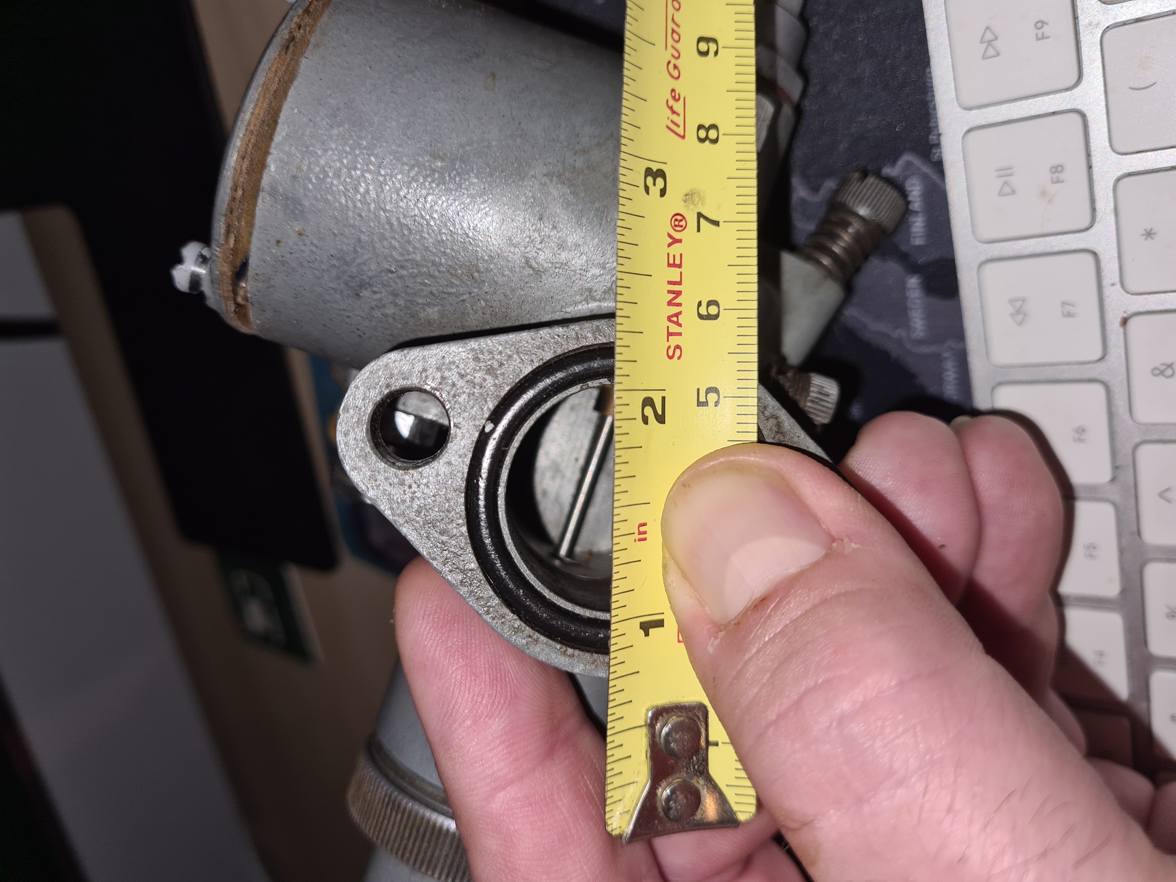

I have eyballed the engine side of the carb and it looks around 1" 1/8 diameter if that helps could not see any markings.

Carb looks like std fitment …
Carb looks like std fitment , monoblock 376 . A sonic bath is good but does not usually clear the very small pilot drillings fully . The slide and body are likely to be both worn enough to make slow running and clean pick up elusive but will work enough to use.

Looks more like inch and a…
Looks more like inch and a sixteenth than inch and an eighth. 376 on the flange will confirm it's no bigger than that.
Hope I'm not being too obvious, but that air slide has to be held up out of the air flow for normal running.

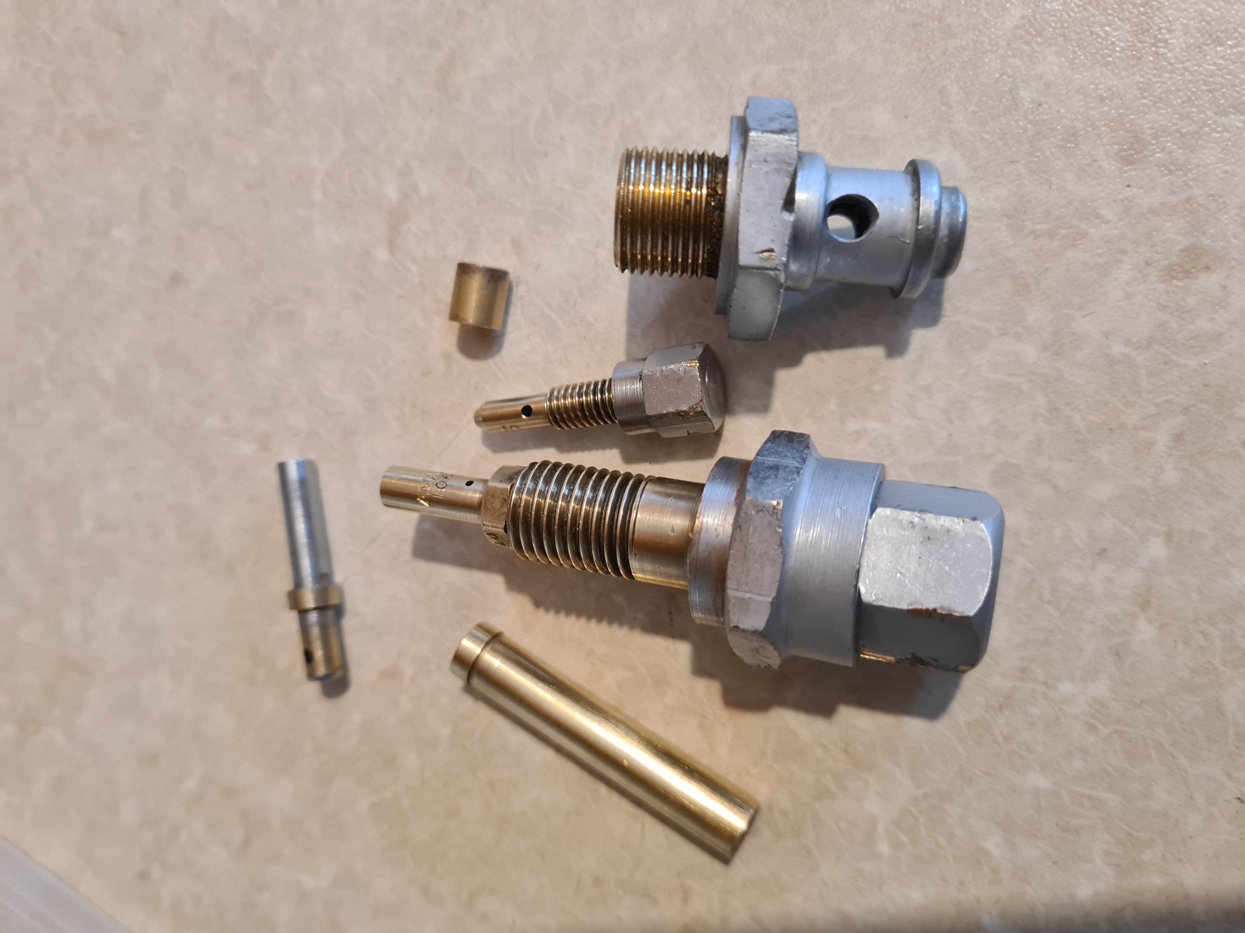

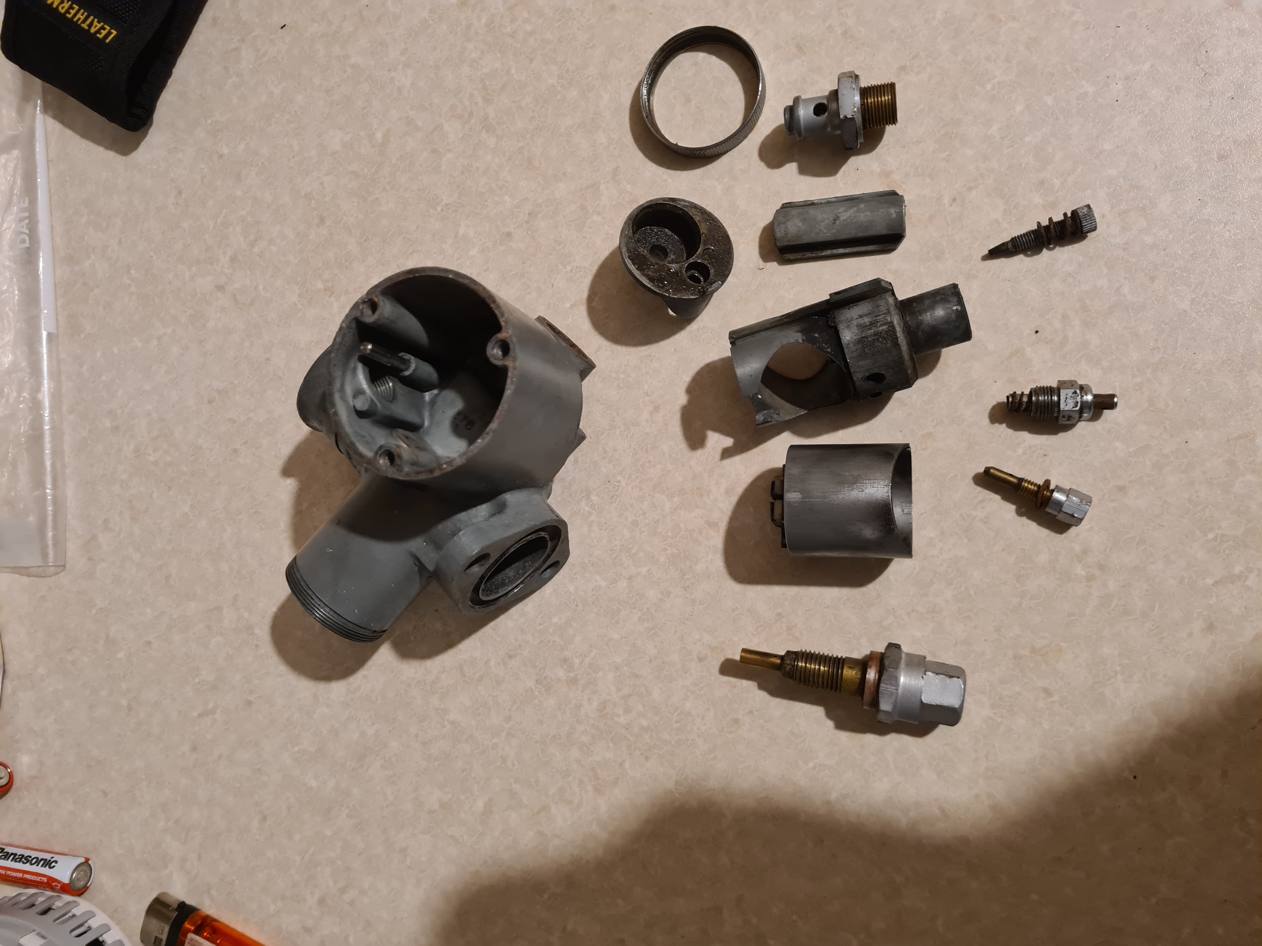

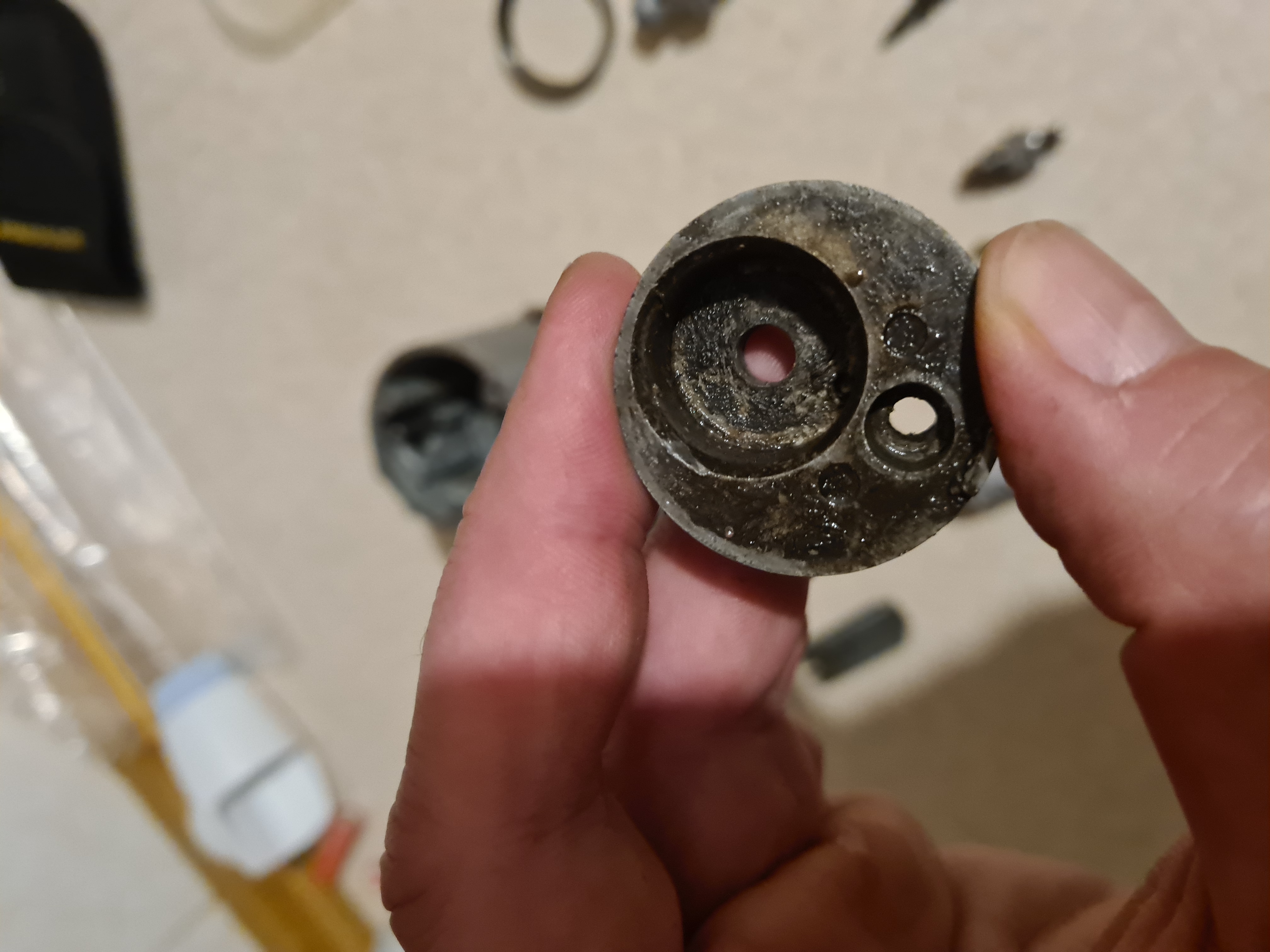

Carb fully broken down
Okay I am glad i decided to pull the carb completely to bits it was not a pretty sight and everything was stuck together inside and would not have run in a month of Sundays as my father would say.
There is some slight wear at the intake tube, small what look like cracks on the edges but this could be replaced if necessary and I may be doing that to fit a gauze filter. I was not up to the fight to get it off tonight but will ponder that one.

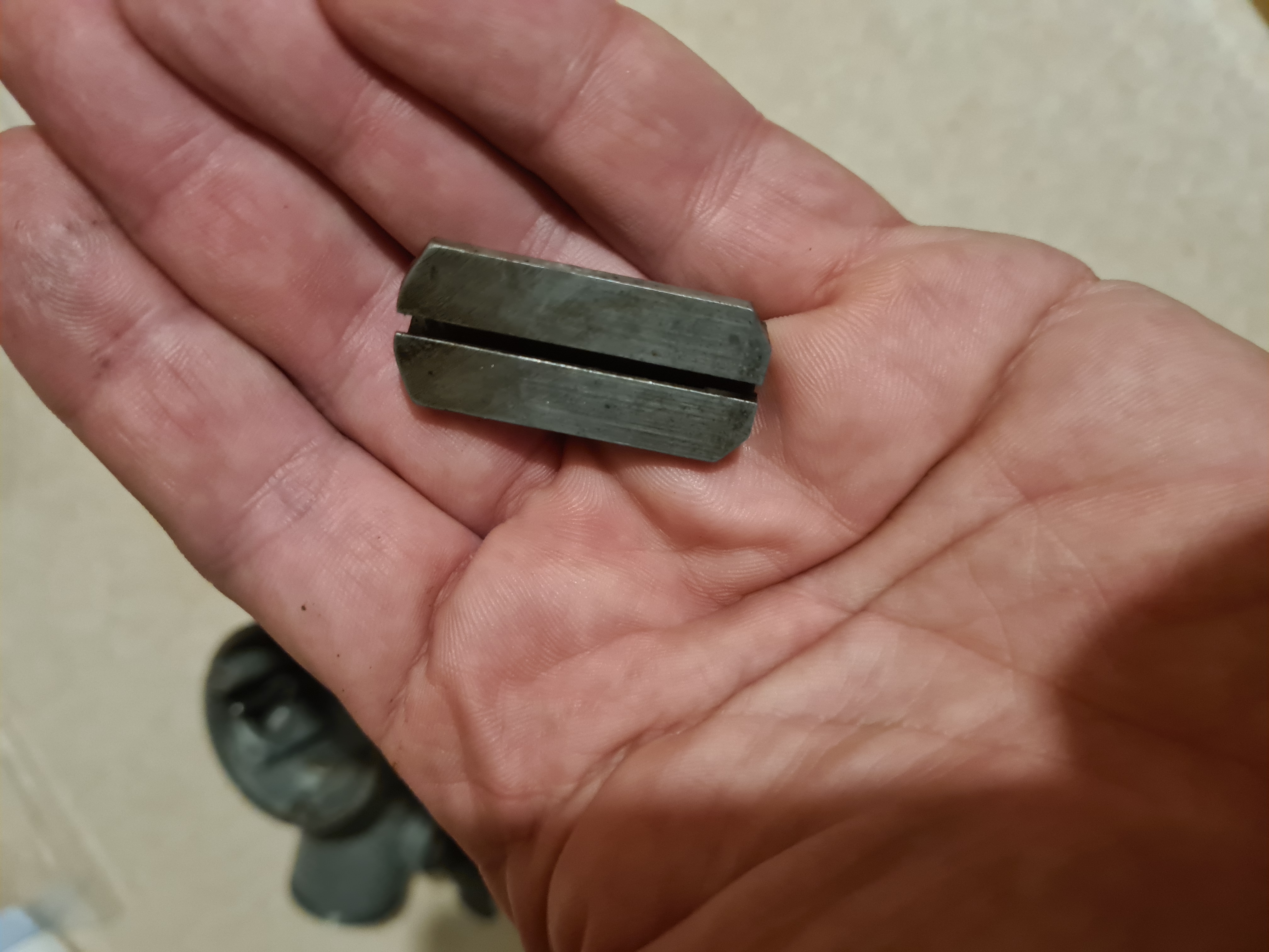

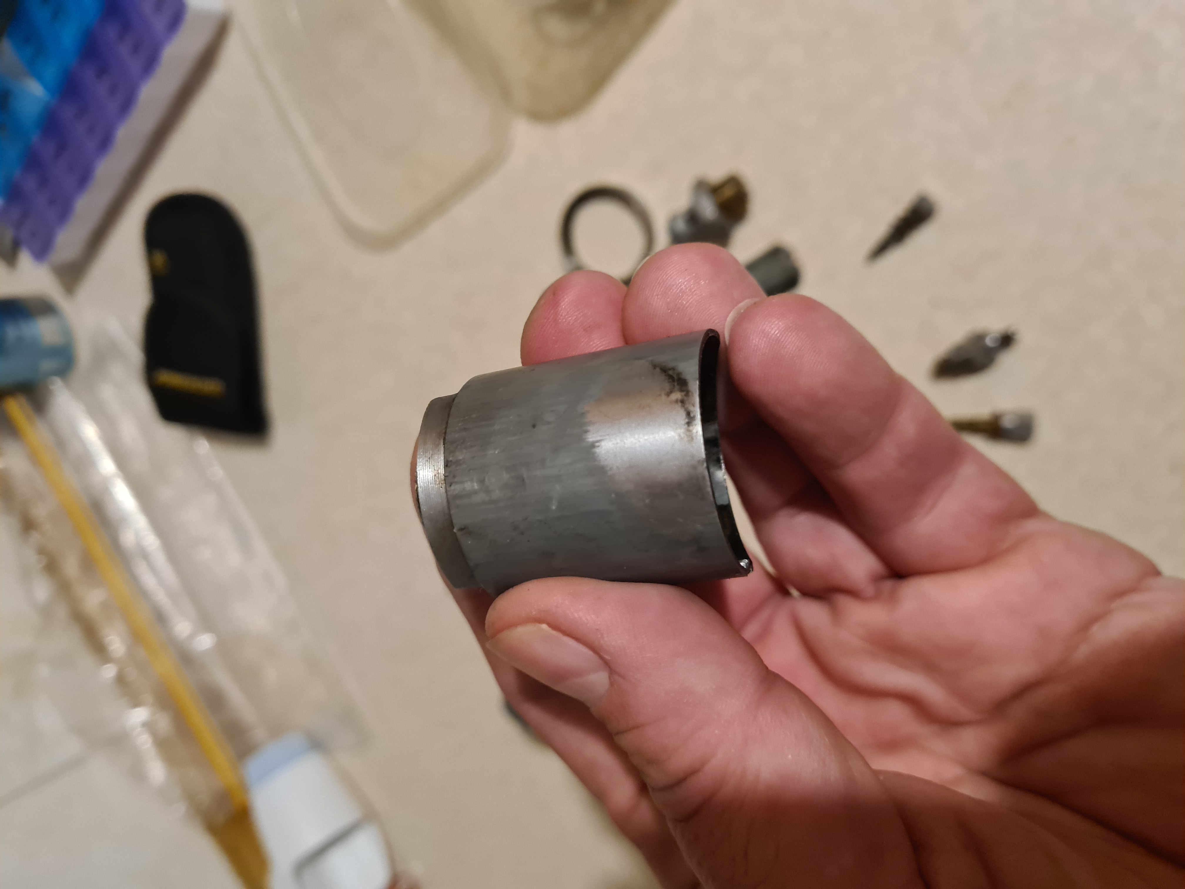

The throttle valve has some wear on the one side, I was thinking of rubbing this with some very fine emery cloth but thought I would consult you guys first.
The part the throttle valve sits over (Could not find the name on the Amal drawing number 31) was jammed in tight and took a few light taps to pop out.

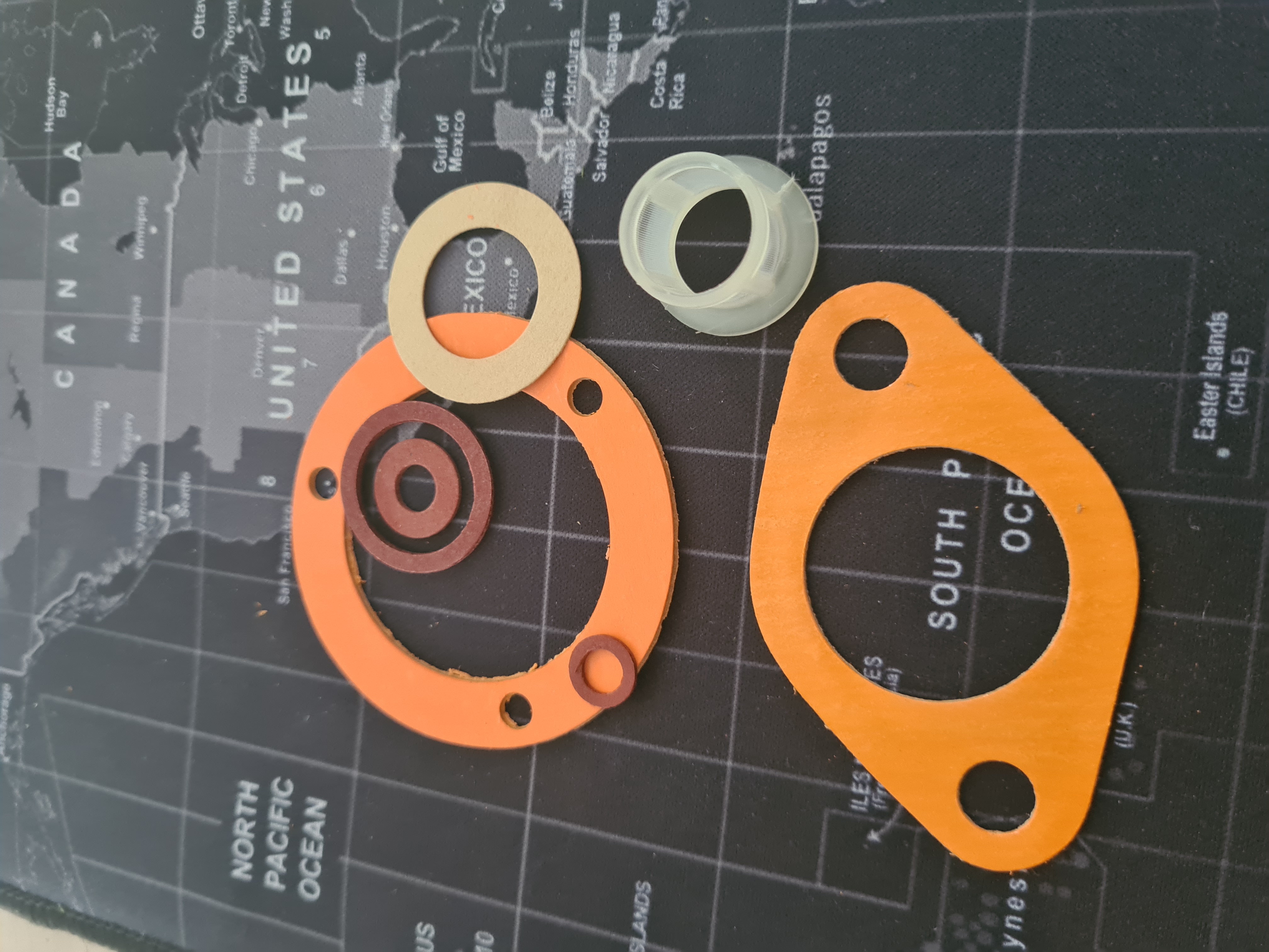

Everything else is in the bath for a clean an I will inspect further. The parts required so far from Amal come to around £35

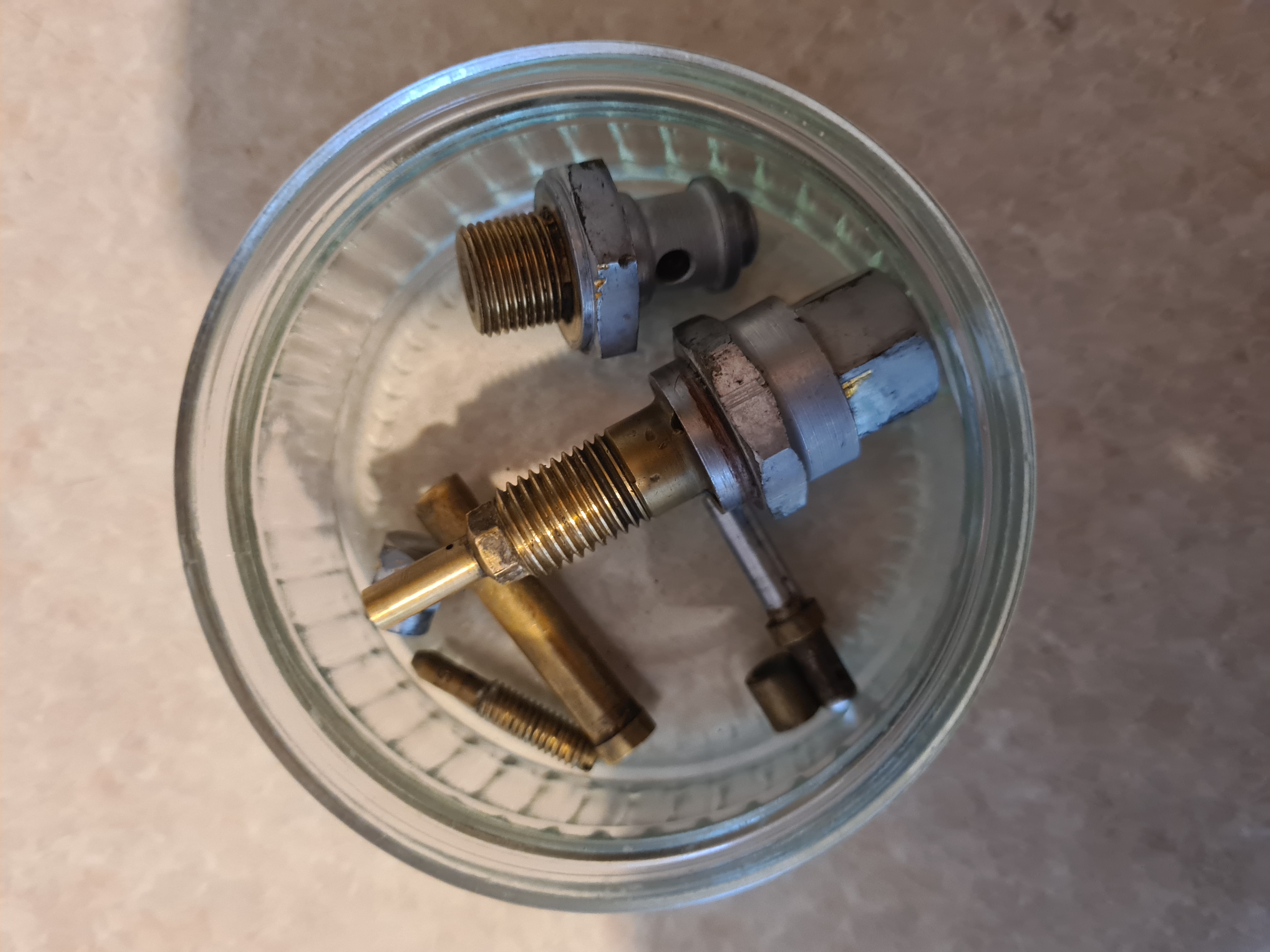

Once they have been through…
Once they have been through the sonic bath I will do them again in some fresh carb cleaning solution in the sonic bath.
All the brass I was going to give a swim in distilled vinegar and clean with fresh water and blow ot with the airline.

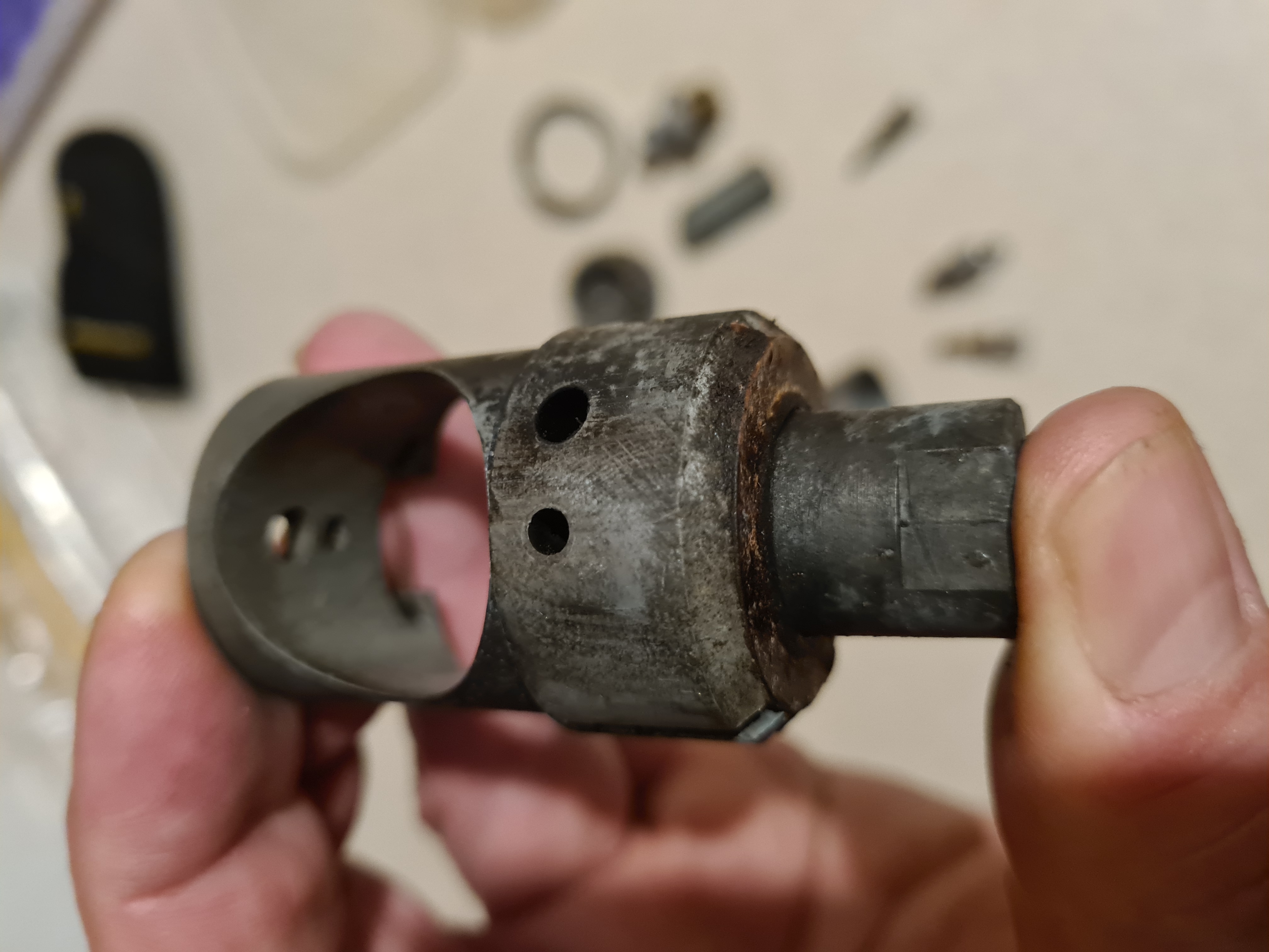

number 31 is a jet block it…
number 31 is a jet block it has gasket on the base and is a tight fit, ME myself would sonic clean the lot. no emery tape . polish the slide and bore with solvol autosol . and try it on the bike. it easy to add new bit . you may fit new now to find the body is worn out.. the most you need is a gasket
washer kit PS you can use a very fine wet and dry paper
Parts Starting to arrive

Throttle slide
You have certainly made a difference to the parts. The throttle slide should fall down by its own weight, with no help from the spring or cable attached. Under the circumstances (all nice and clean) I would think any resistance would be distortion somewhere. I wouldn't apply any oil, it will either be washed off or gather dust if not.
Thank you Stan I don't think…
Thank you Stan I don't think its quite at that stage but I will perceiver with it. At the moment I am just polishing a bit at a time as its easy to take away material but not so easy to put it on lol.
Maybe a new throttle slide…
Maybe a new throttle slide required I can't see any distortion by eye but it wouldn't take much.
A new one is around £40 so not the end of the world but annoying.
Distortion
Any distortion jamming the slide will likely be in the carb body not the slide itself, usually from overtightening the flange nuts. Have you tried the flange on a dead flat surface to see whether it is bowed at all? Sometimes they can be carefully persuaded back into shape as simply fileing the flange flat again won't take out the distortion in the carb body bore. Your slide does look a bit scored though.
Best regards, Al.
When the flange bows it…
When the flange bows it pulls the body out of round and slides stop sliding, Better to press it all back to the orriginal shape. I have however persuaded oval bodies back into use with gentle sqeezing with an adjustable grip while checking with a vernier caliper . I also think the problem can be caused by years of heat cycles and missing/poor insulating spacers.removing metal is usually fatal to slides .Slides can also go out of round and benefit from a squeeze.

You say:- The part the…
You say:-
It should be jammed in tight. Normally gentle application of heat to the body would be required to remove it, and the same to re-fit.
Good to know it took a few…
Good to know it took a few light taps. I will heat it when it goes together. And also remember the gasket

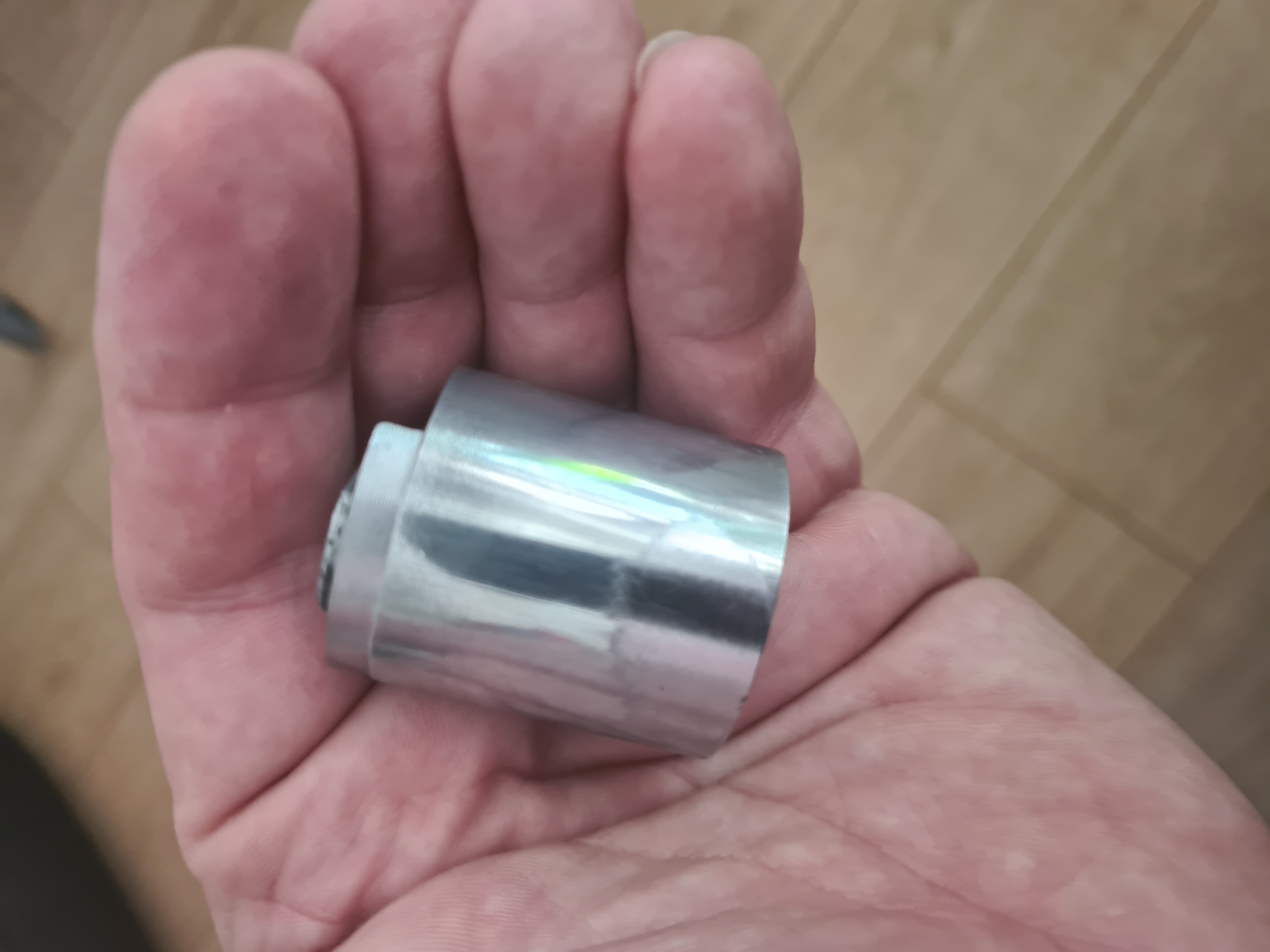

Started to dry fit the carb…
Started to dry fit the carb and put the return spring in. The carb opens smoothly and snaps shut like a clam. Looks like the refurb has been successful.

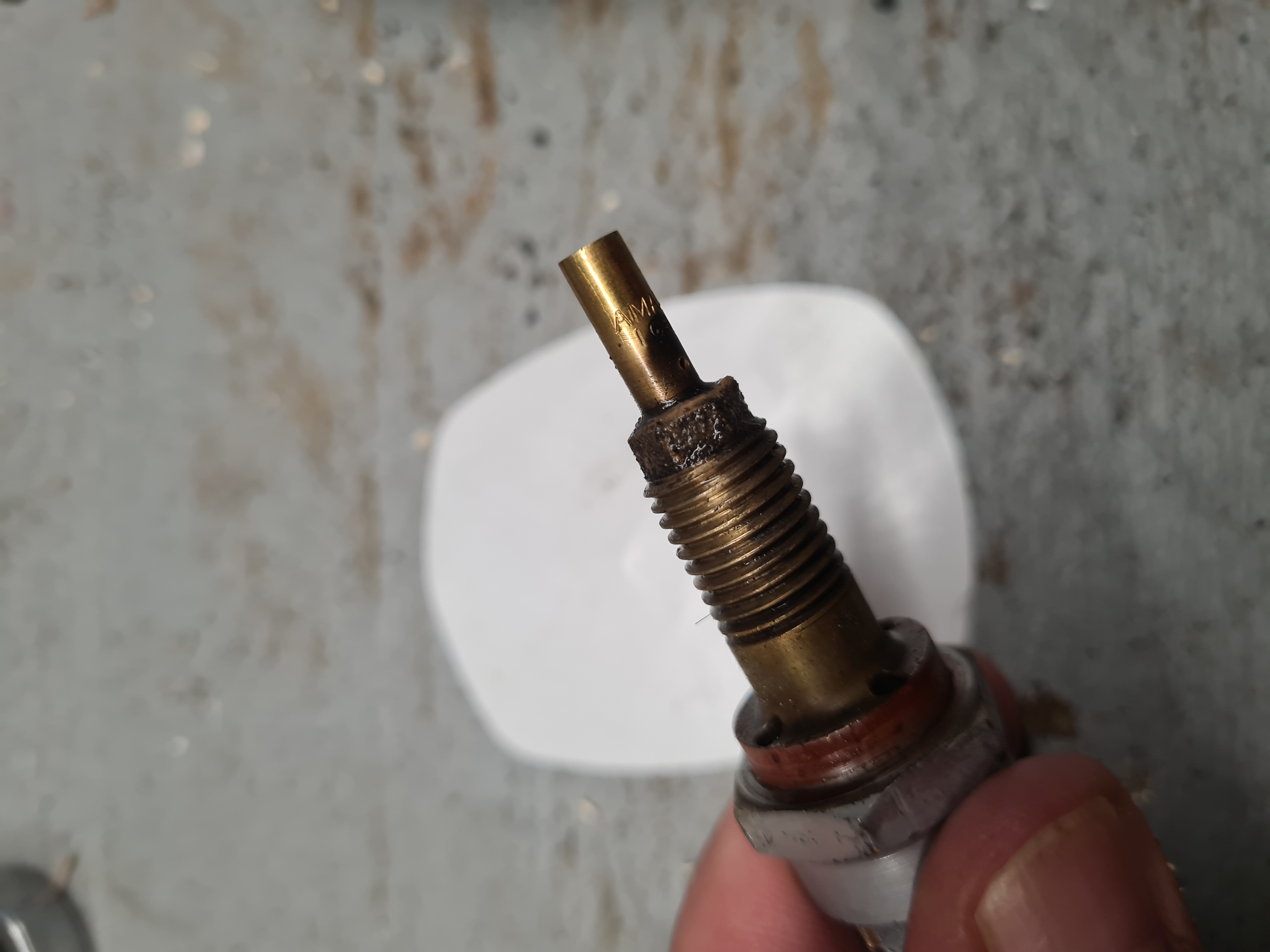

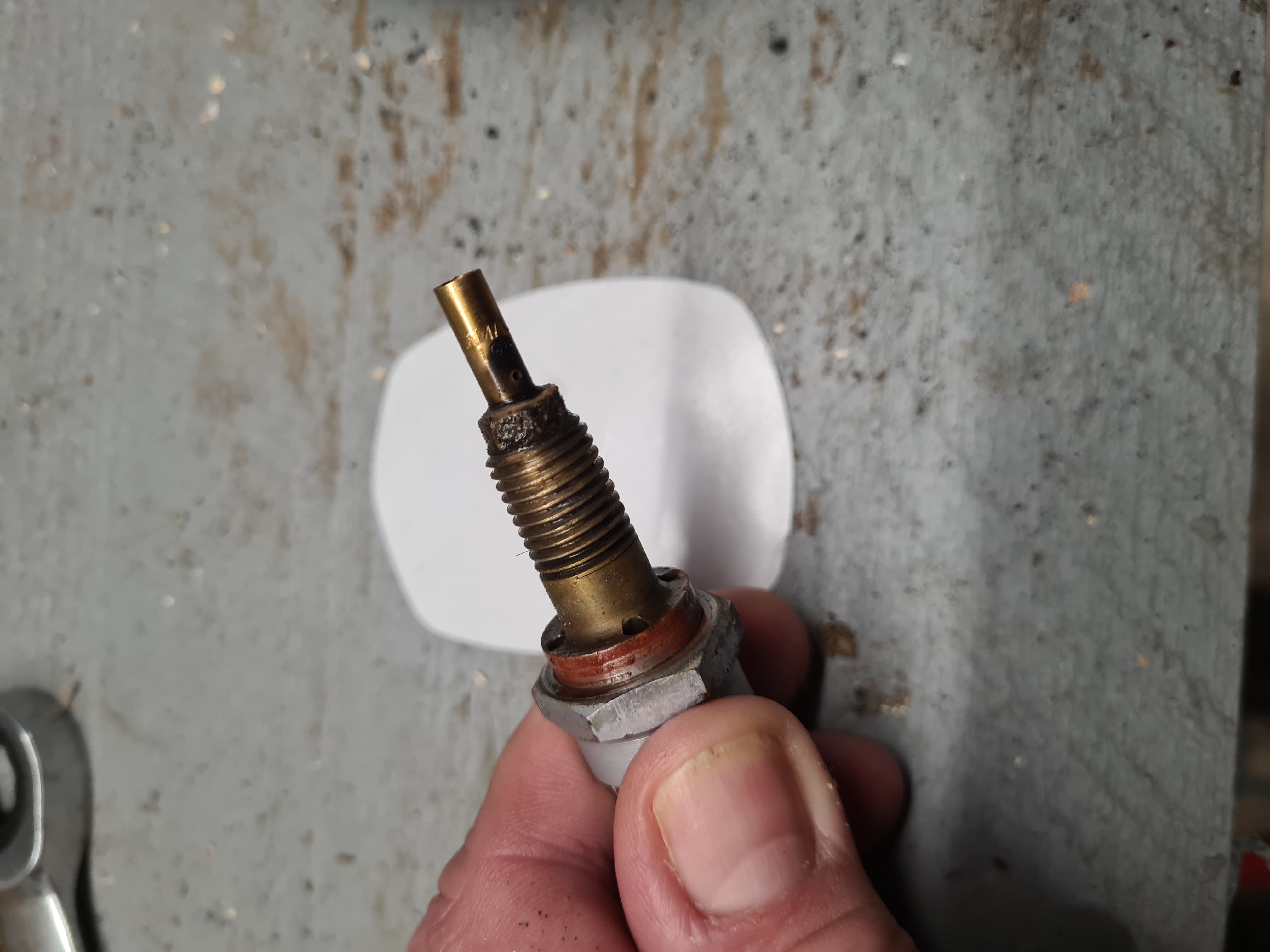

There is a tiny compensator hole
just downstream of the spray tube. Depending on the amount of throttle opening it may pass air or fuel - but being very tiny indeed it is prone to blockage with dried fuel. The most obvious symptom is a slight stumble as you begin to open the throttle from idle as you pull away. To clear it I use one short strand from a bicycle control cable, a pair of tweezers and a magnifying glass so I can see that I am doing. Just gently poke it in that little hole.

The compensator hole
is very tiny, and I suspect that a sonic bath may fail to clear it if blocked.
