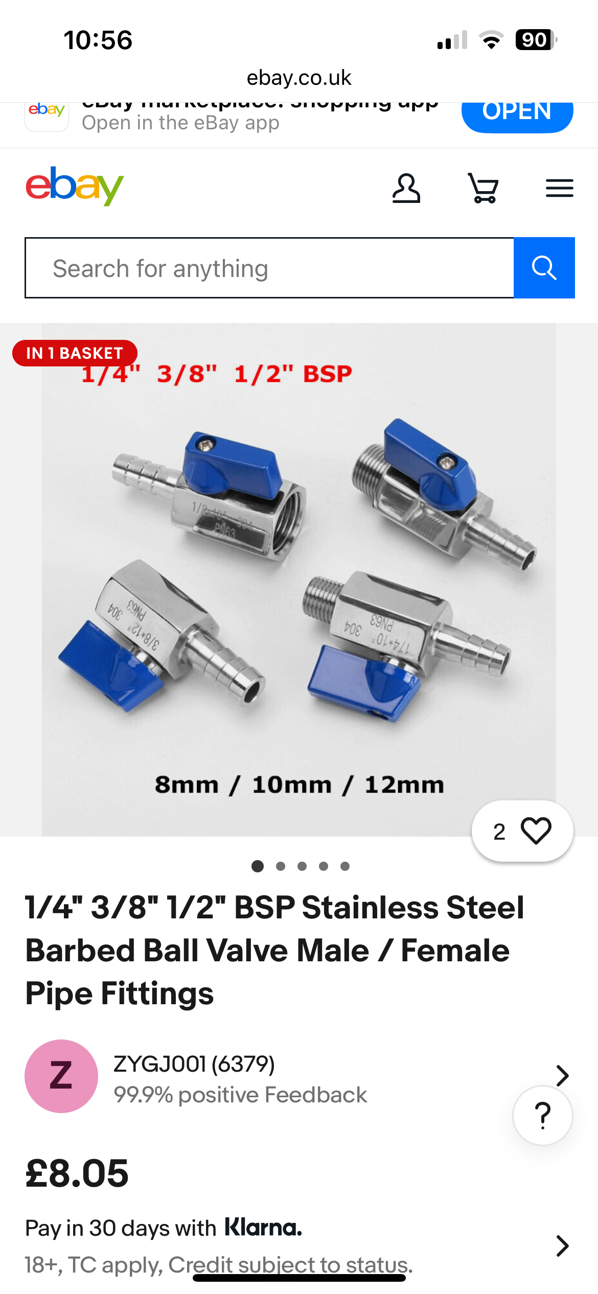

Spherical valves meant for…
Spherical valves meant for LPG and various industrial applications flow well, don't leak and last a long time. Also are cheap.
They don't look like British bike parts and don't have a reserve, if that matters to you.
