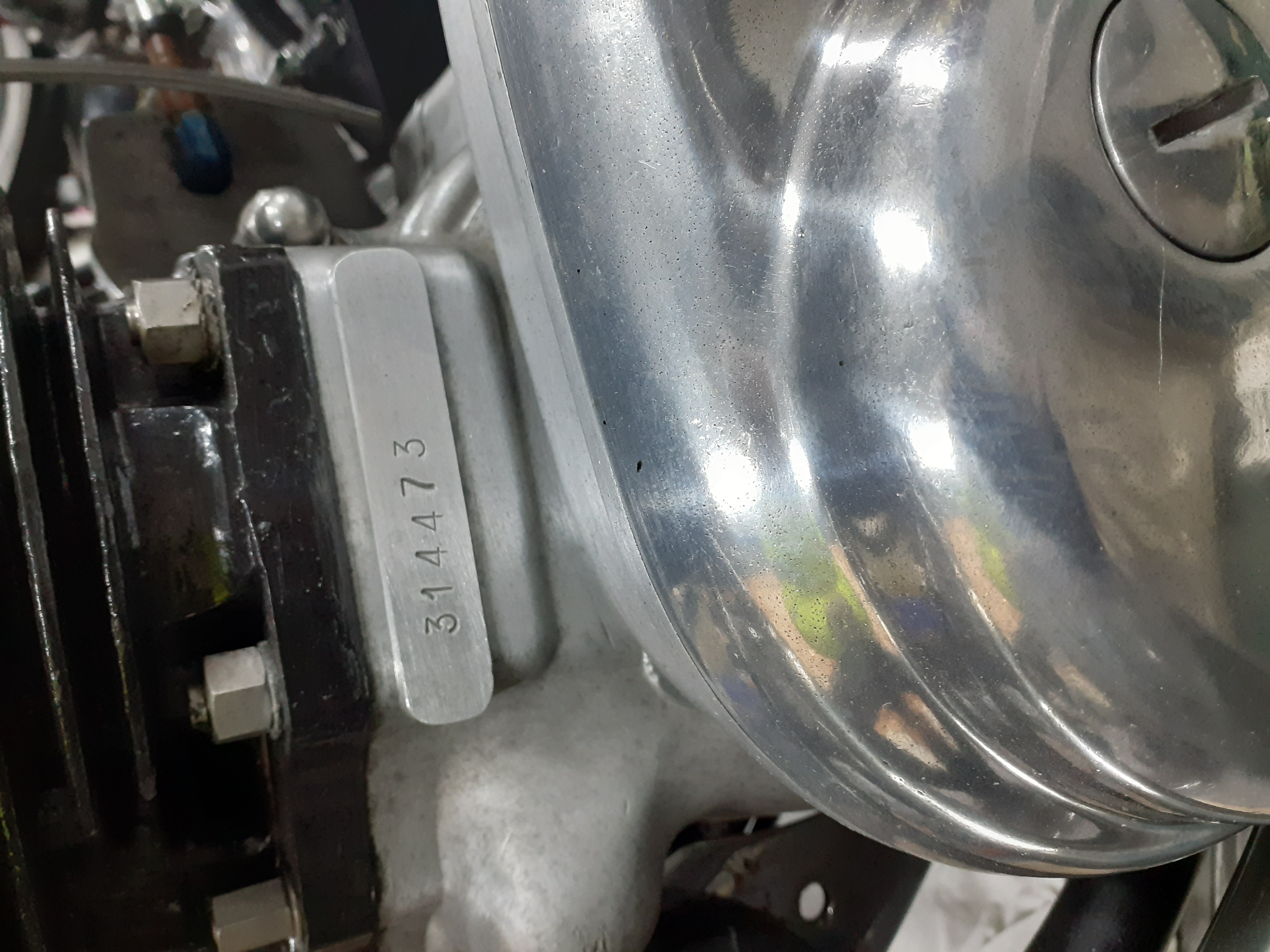

I have a Commando which I need to register with the DVLA for a V5 and age related plate. I contacted the club for information about the engine and frame number and it seems the engine number is documented as an 850, the barrels have the base nuts showing which I assumed made it a 750. The numbers are stamped into un molested casting not showing any signs of tampering. Can anyone shed any light on what may have happened, is it possible 750 barrels are fitted on the 850 crankcase?

Your number is for a 1974 850. This should have an RH10 head. This would have 30mm intake ports.

I'm not convinced that engine number has not been re-stamped. The numbers are a bit uneven. There is a fair amount of metal on the cases where the number goes and have often thought you could file off old numbers & stamp new ones on.
Or it could be a 750 top end on 850 cases. I think you can do that.
Those are not factory stamps, by that time for an 850 there would be unique round stamps with horizontal lines before and after the numbers to stop tampering and they are missing. Those cases have been stamped later and 850 numbers have been applied to 750 cases.
Definitely not a factory font style. Do the cases have a large sump plug ? If not then they're late 750...the large sump plug returned for the 850s.
It's difficult to say whether the casings are restamped or a new unstamped pair of cases have been used to replace damaged items.
Normally there are light milling marks visible on the raised pad.
The engine number is incorrect, the breather is also in the wrong place, cases appear to be late 750. See attached for number and breather position.850 Commando engine number

If the engine number matches the number stamped on the red plate on the headstock then the number is not stolen, and if the cases were stolen then their real identify is lost. Most likely the frame number is the same, in the past the 850 cases exploded also taking the barrel and a 750 engine was substituted. 750 number machined off and the 850 numbers stamped on to keep the bike numbers matching. Just a likely guess.
