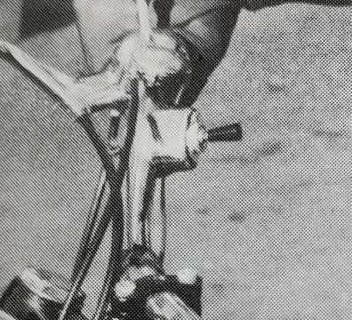

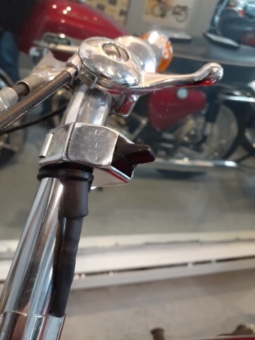

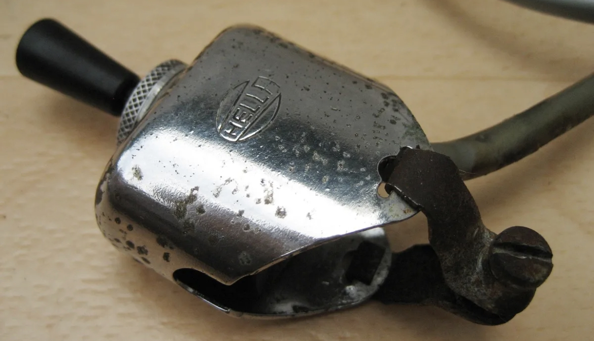

I think the indicator switch is from the German firm Hella .They also made the bar end blinkers.
Also used on Hercules motorbikes
Hella switch
Thanks Ulrich!  that's just the info I needed.  The switch is probably relatively difficult to find in the US but I'll keep an eye out at the swap meets.  If anyone has one they'd be willing to part with for a reasonable price, please let me know. ;)

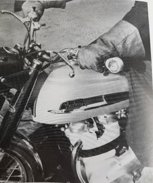

...from Electra Switch 3 above. It shows the choke lever nearer the right thumb that the indicator switch. So the machine hasn't been ridden any distance or the rider would work out the indicators get used far more often that the choke control. Some people do some funny things, as Peter H mentioned above. Original is one thing, ride-ability is another. Very often they aren't the same thing.

1) Uli - your picture is the correct item - branded "Hella".  https://www.nortonownersclub.org/sites/default/files/inline-images/IMG_8188_0.jpeg

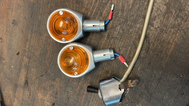

These are the original Hella indicators and switch for the Elctra.
I bought these for my 1965 Jubilee because for bikes build later than 1961 blinkers are mandatory here in Germany.
Hella stuff
