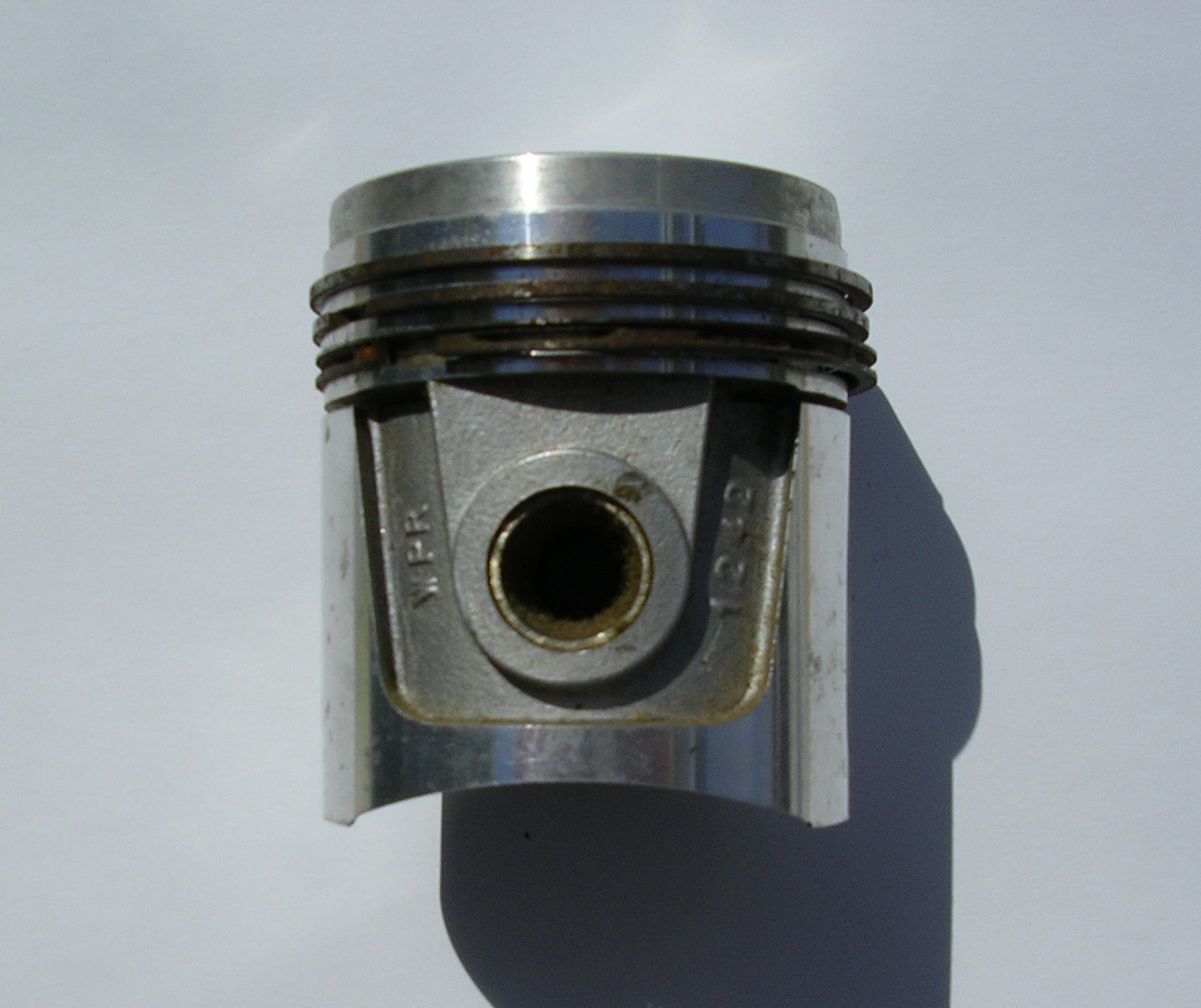

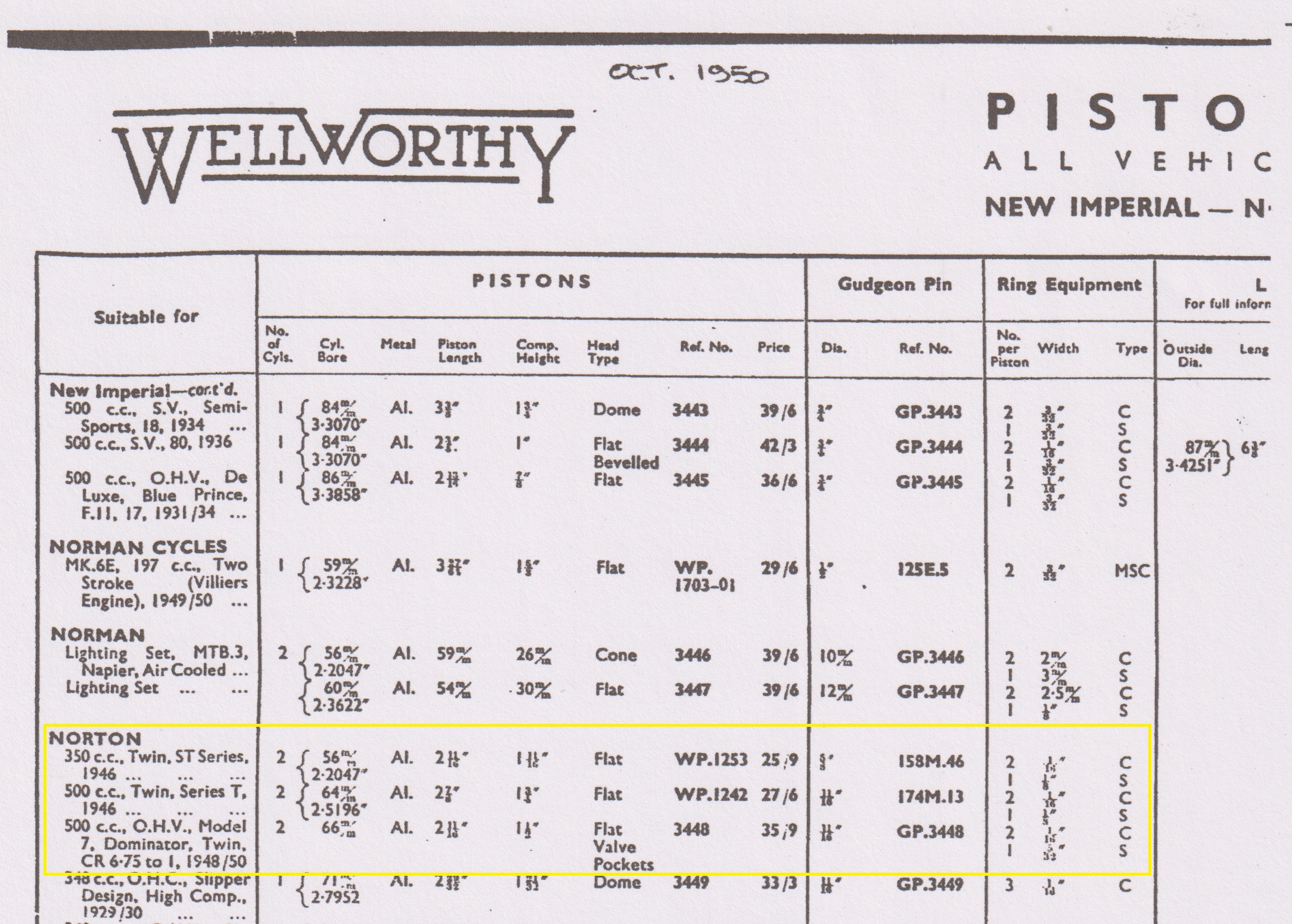

A look inside the 1950 Wellworthy Piston Catalogue shows replacement pistons for the Model 7 @ 66mm and the Norton 500cc Twin Model T @ 64mm.  Photograph below is of one such piston. The Norton 350cc Navigator also had a 64mm bore.
Wellworthy
Piston
