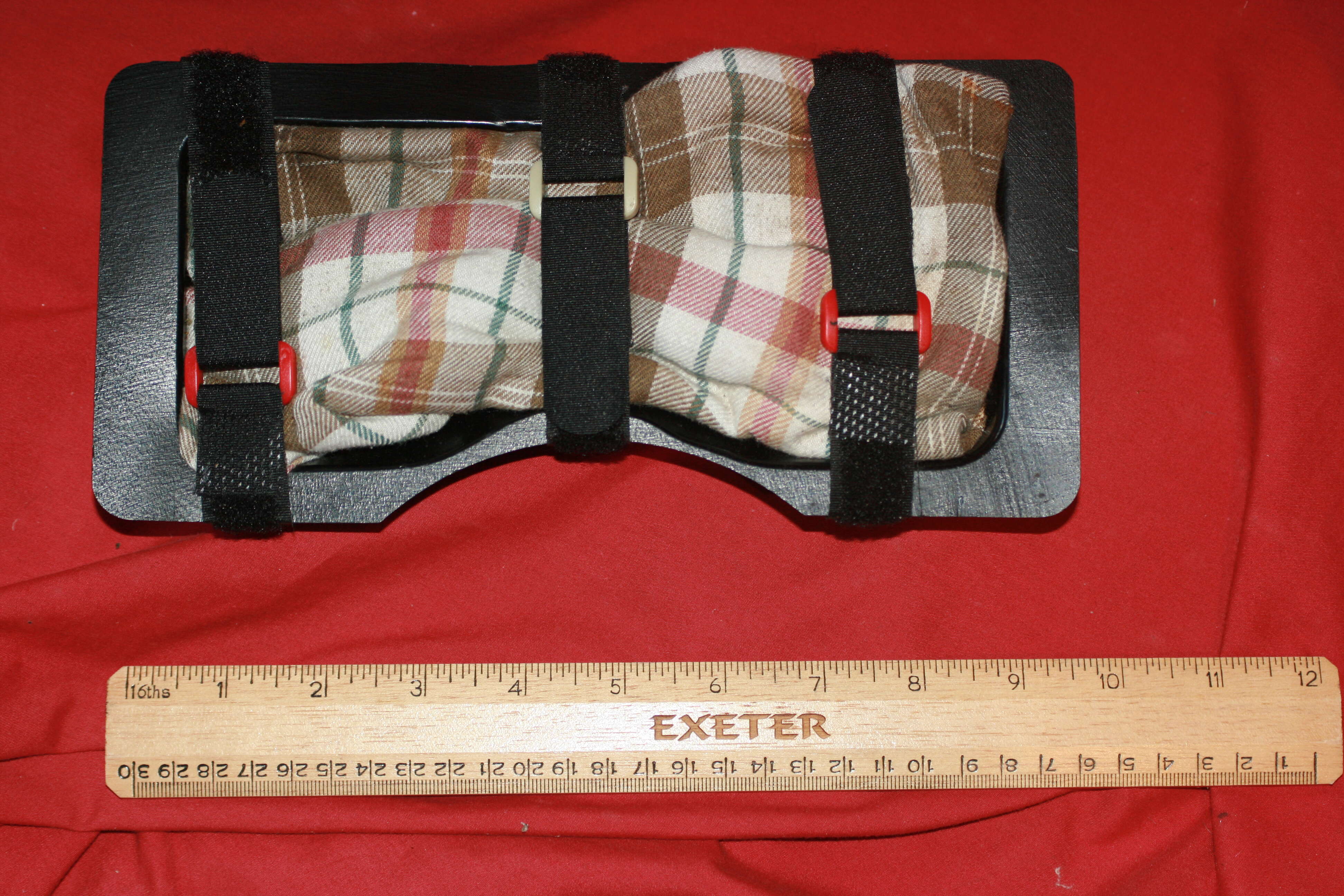

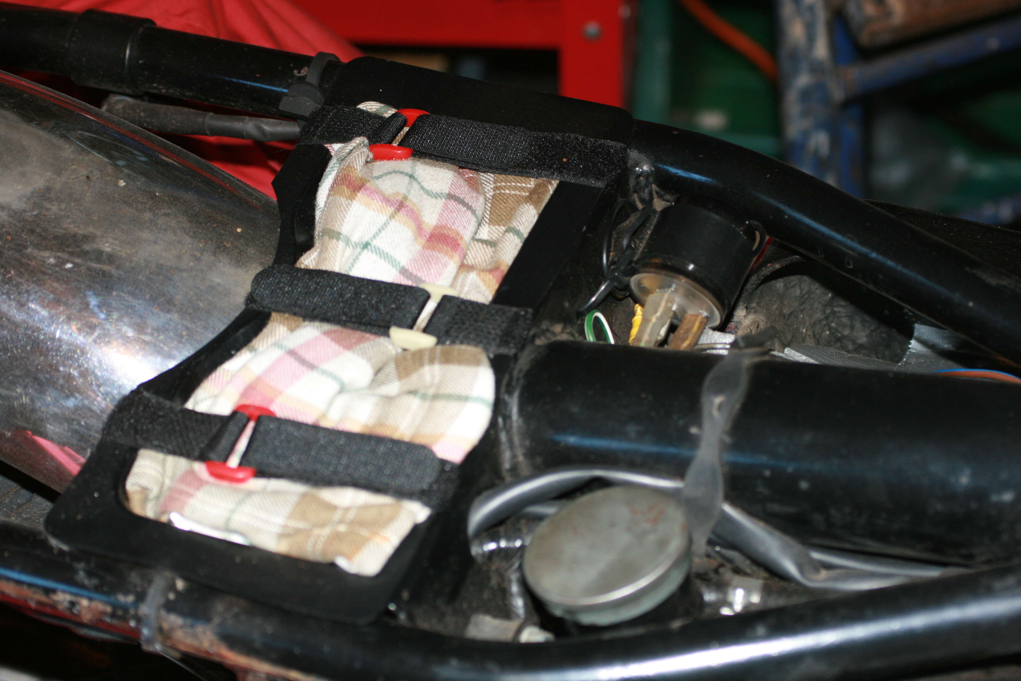

Had a little bit of spare time and took some pics of the tool tray to give an idea of how it fits and capacity.
I find this just gives enough additional capacity in combination with the side panel slot for the tools and spares I need to carry.
Andy
Excellent! a picture speaks…

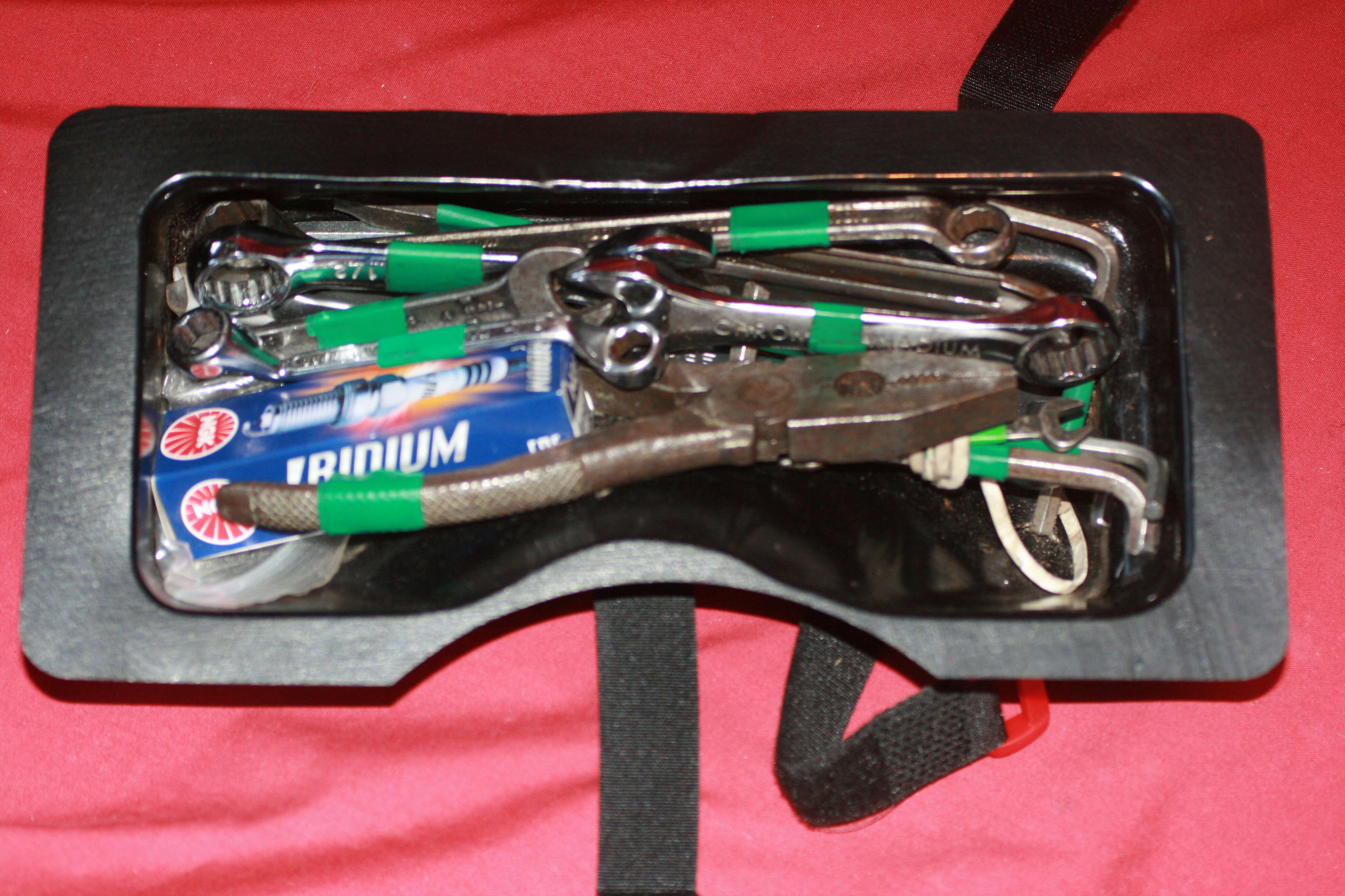

Andy, curious (nosey) as to why you have green tape on your tools? Nicked from a company colour coded tool kit?
Andy (Mac)
Tool tray contents
Andy (Mac)
No not nicked from a company toolkit!
The reason is sadly more prosaic. Or maybe just sad.
Green tape is simply there to remind me to return these items to the tool tray if I use any of them for working on the bike in the garage.
These are different from the items with red tape which are to remind me which are the bike tools in amoungst by general tools.
Yes I know...perhaps it's an age thing.
I also suffer from a mild case of Dartmoor garage pixies who occasionally hide tools and parts only for them to reappear later in plain sight.
Andy

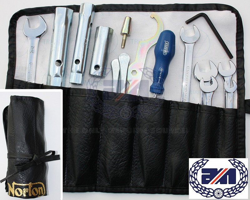

Since we're drifting onto what tools to carry, as opposed to how to carry them, the Andover Norton toolkit strikes me as good value for money (part number 06.7268; £79.90 + VAT).
The open-ended spanners in particular are very high quality.
