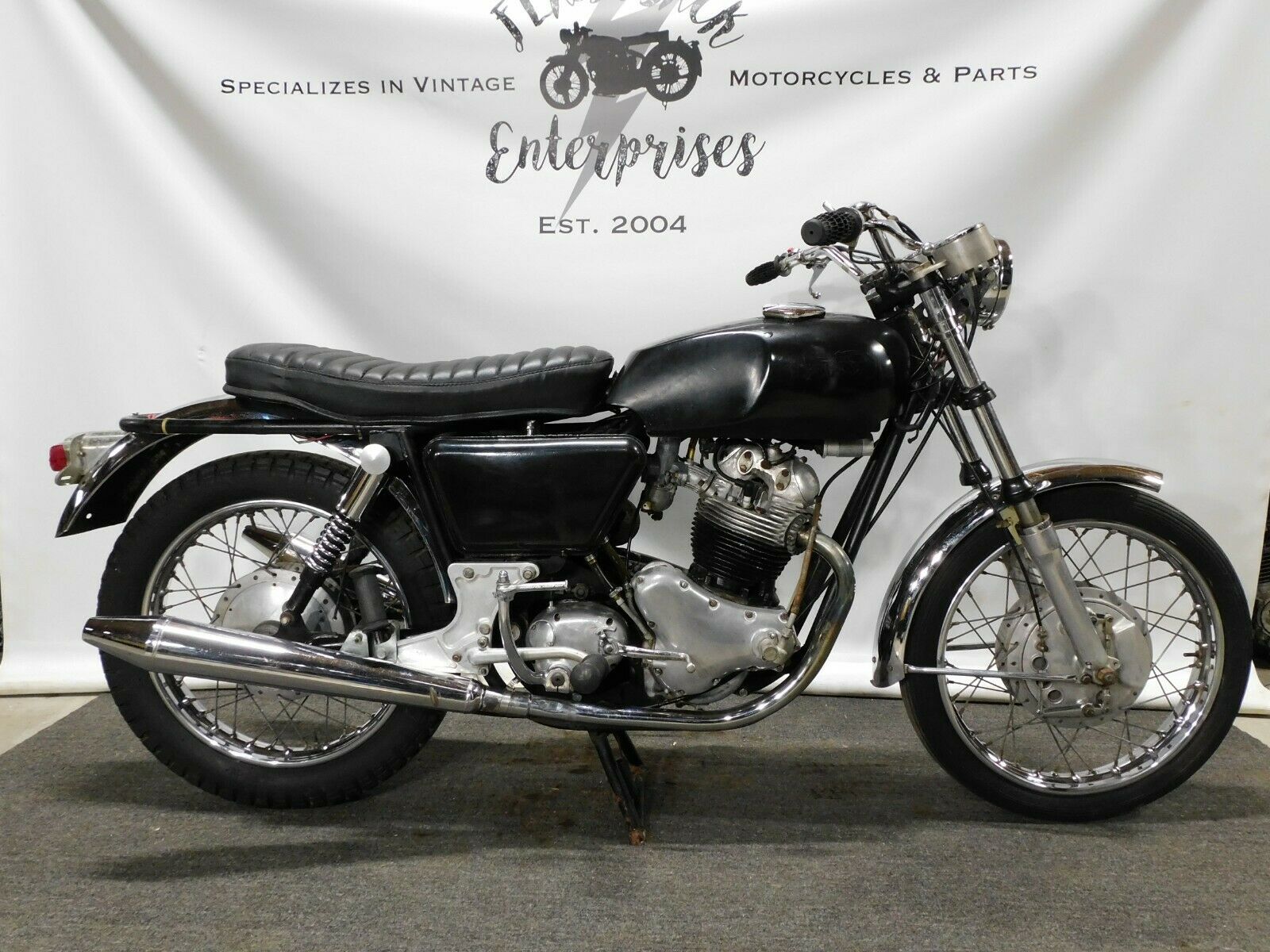

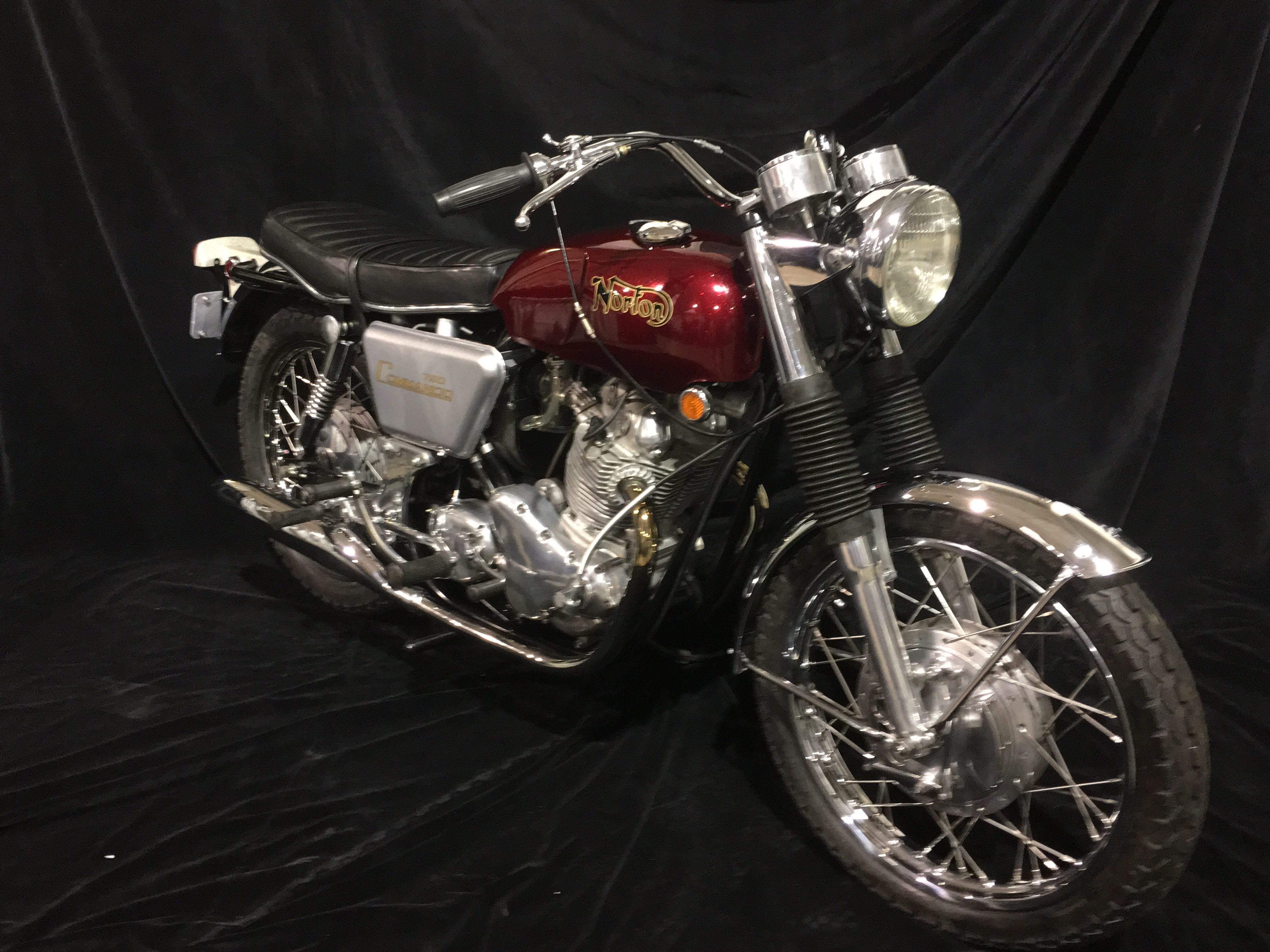

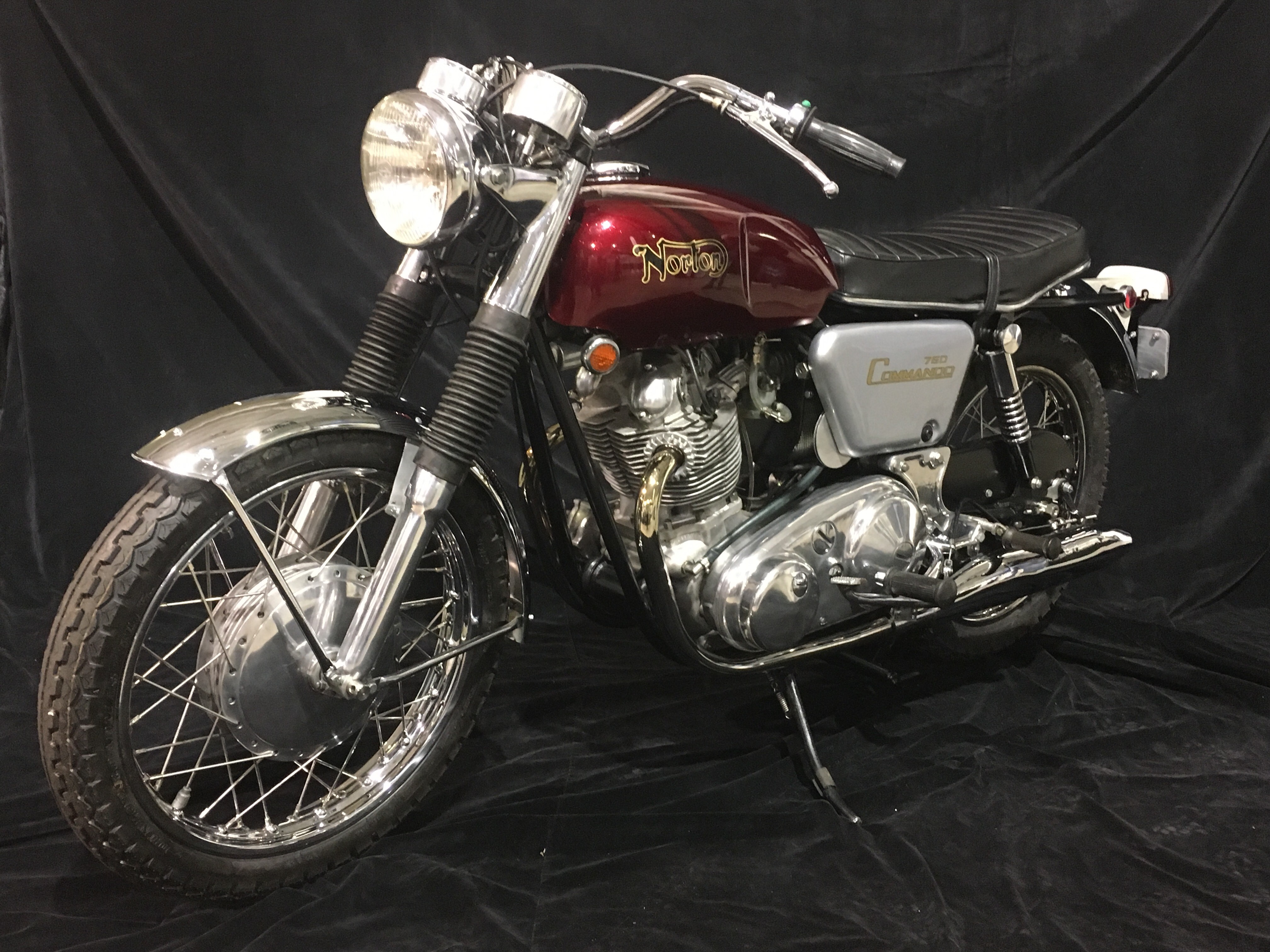

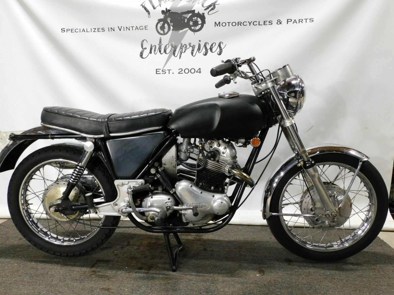

I hope someone can help. I imported a commando R. There is not much information on this particular model as only about 650 were made. I would like to try and get as much information as possible about the bike to make it correct when I restore it. Currently there is not much that is correct from the information I do have. Please have a look at the photos.

Looks great and pretty original to me.
Maybe it came from the same barn as mine?

looking at the background of…
looking at the background of your photo it came from the same people. I bought a combat off them as well. They said it was weeping oil behind the barrels. When I got the combat home it wasn't weeping behind the barrels, the crankcases had cracks in them. They also just dropped a MK3 seat on it to look good.
Never mind, having a tig welder for Christmas so i can weld the cases up.

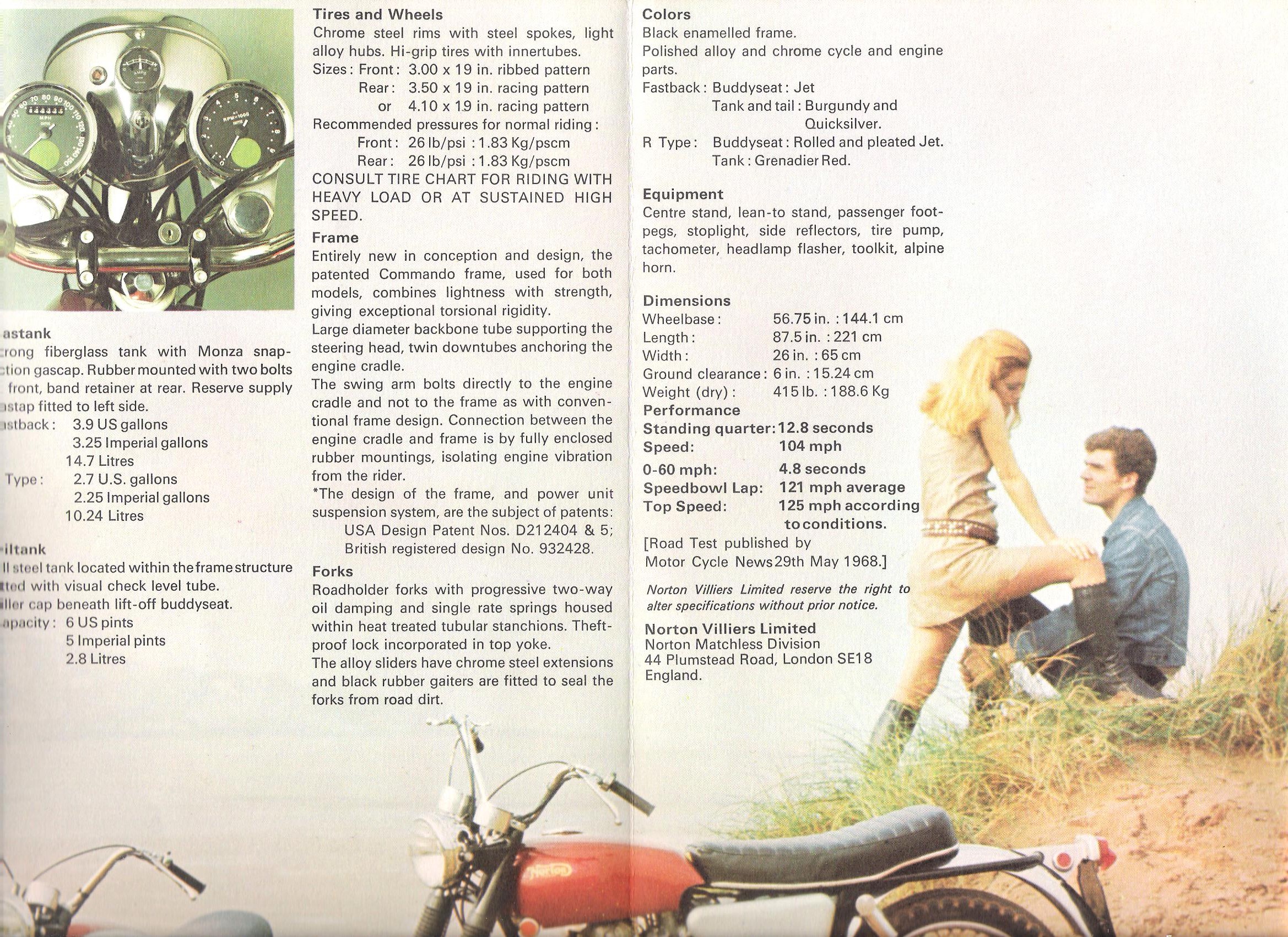

Late "R" Type
This is a picture from the 69 Norton sales brochure:
Do you mean this type, Ashley?
It differs from the early "R" Type by other side panels and has the central oil tank just like the "S" Type and the headlight "halo".
Brochure Illustrations.
The early version was pretty much a Fastback with Roadster tank and seat. A difficult large brochure for those of us with only an A4 scanner.
John, The attachments say…
John,
The attachments say it all, we know the R type was produced in 1970, we also now the Roadster appeared in 1970 as well. The second batch of R type looks like it was to back fill outstanding orders.
I suspect Berliner had a big input to the development at the time, the '70 fastback at that time arrived with upswept pipes with the peashooter silencers and I suspect their customers wanted a R type or S type with the later peashooter silencers which saw the demise of the low level silencers and the coming about of the Roadster. To avoid the 'it's a S type or R type with peashooters' tag or 'R type with large headlamp and low level exhausts' once the peashooters were wanted and fitted it made sense to call it the Roadster to distinguish it from what had gone before. The Decal for the Roadster 06.1699 was drawn and released to production in Nov 1969, so it seems the plans for the R type and the Roadster were running concurrently at the time.
Problem with the R Type despite its low numbers is that there were two versions. It was just Bitsa whilst Norton decided what they wanted to make it seems. The addendums in the parts books are the best places to look for the differences.
Personally, I think it is the better looking bike available from Norton at that time.
