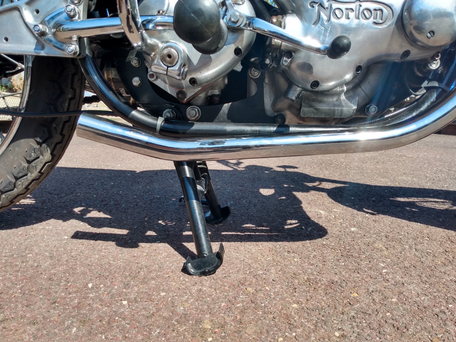

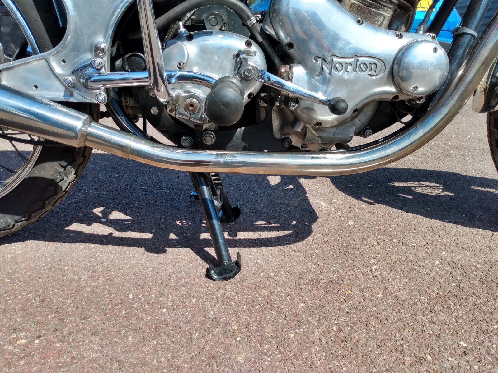

 - The ones i am replacing the lower part of the pipe prior to the 'kick up'run parralell to the frame rails whereas these new ones seem follow a downard trajectory when compared to the frame rail.

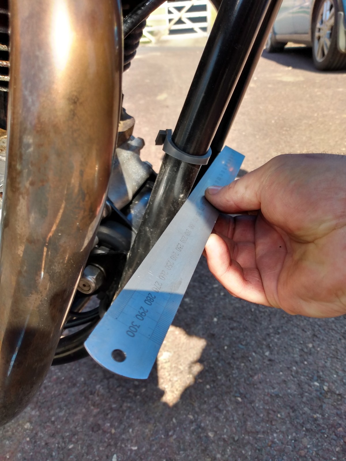

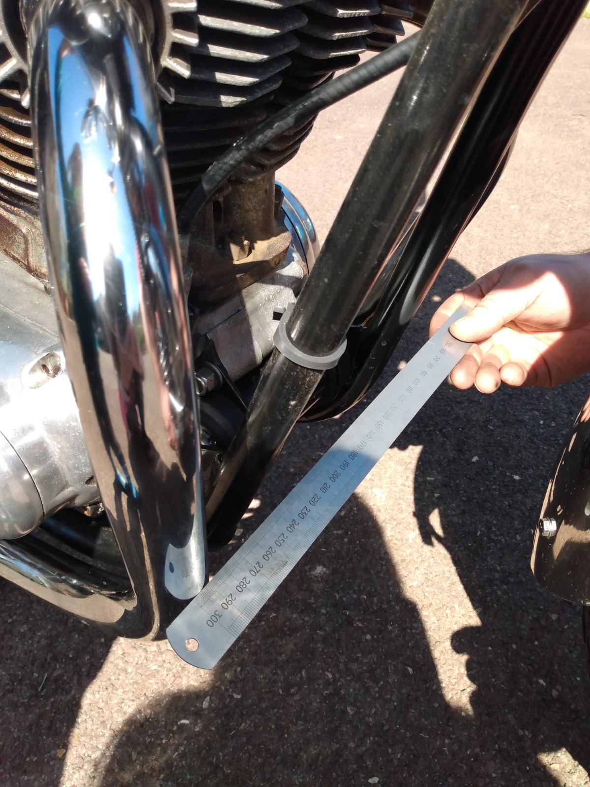

They are the welded type so with the rose tightened the only variability is rotation in the port.
I held a straight edge to the down tubes of the frame rails as per attached photos and they sit very differently (in front of down tubes vs. behind). The flange appears pependicular to the pipe so i can only summise there is not not enough bend in first direction change as it comes out of the port.

I got hold of an Andover pipe today and it fitted really well so hopefully I will be visitng the welder less!

There's a lot of variability between after-market exhausts and I have yet to find a set of pipes that fit as original. And some are just rubbish.
The lower run of the pipe should be more or less parallel to the lower frame tube and never hang down like your picture. Which suggests that your problem is at the cylinder head. Are these pipes flared at the end to fit using the steel cones (Mk3 style)? In which case you should be able to pull them up. If the ends are welded then compare the upper ends to the ones you've taken off. Is the end welded at the same angle? Is the tube bend the same?
To answer your question, 750 and 850 exhausts are interchangeable. 850 have the balance pipe. And some pipes are made for different silencers so one's for black-caps will make your reverse-cone silencers stickout sideways and ones for low-level silencers angle down again to run the silencer horizontal. But they *all* run more or less parallel to the lower frame tube.
