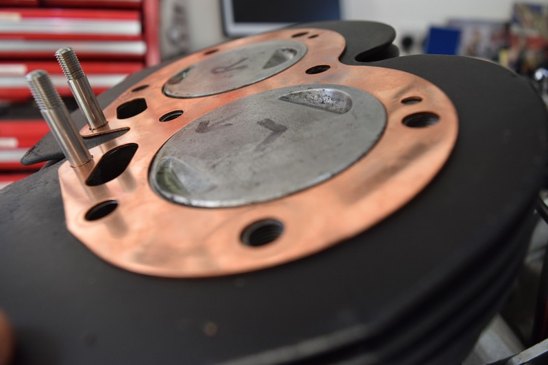

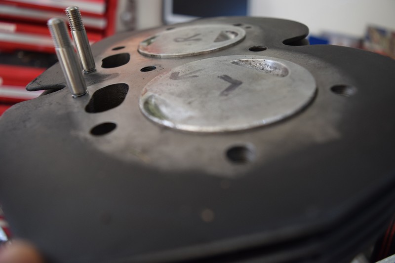

I would appreciate a confidence check please on my rebuild of a 1971 750 Combat import before I bolt the head down.  The pistons over extend from the barrel finished face by 1.7mm and a new copper head gasket is 1mm uncompressed leaving the pistons to occupy the recess of the head which is 1.6mm by about 0.7mm uncompressed.

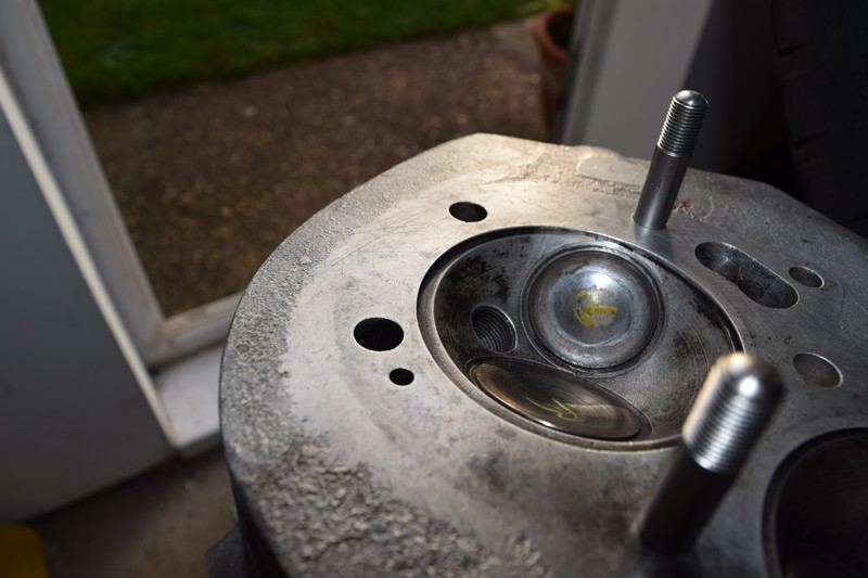

There has clearly been some historical skimming and I have compensated by using a metal base gasket to lower compression / reduce stroke.
As it is I am heavily reliant on the valve clearances being able to avoid contact with the pistons
Have I a reason to be concerned ?

So before I compress the head gasket I would have a squish of 1.6 - 7 = 0.9mm relative to the combustion chamber recess leaving only the piston indents to take the valve movement ?
As I have increased by adding a metal base gasket , is there an option of a thicker copper head gasket that you know of ?

With your figures above you would be gambling, a composite gasket compresses about 7%, not sure about a copper gasket.
You mention the head has been skimmed further, so check the depth of squish band around the chamber in the head. If the depth varies forward to aft and across the head, then you are not going to gain anything, so it makes sense to not worry about the squish band gap so increase it to sensible gap. Poorly skimmed heads which leave the recess with a variable depth defeat the idea of reducing squish.
Unless you have a shelf of spare engine parts, check the squish clearance by sacrificing a gasket or then anneal it, and check the valve to piston clearances.
I will assemble and tighten and check for valve to head  clearance
