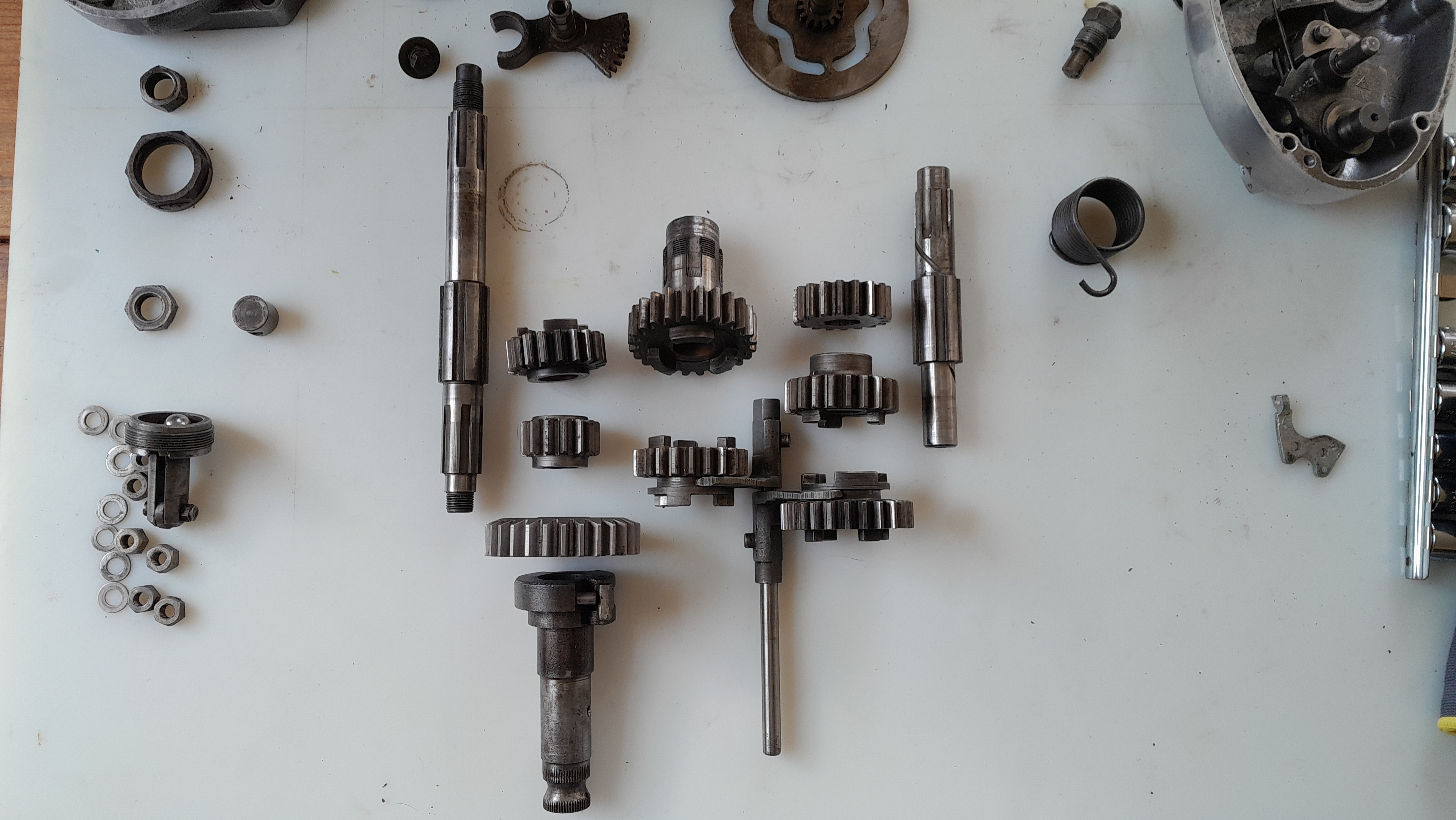

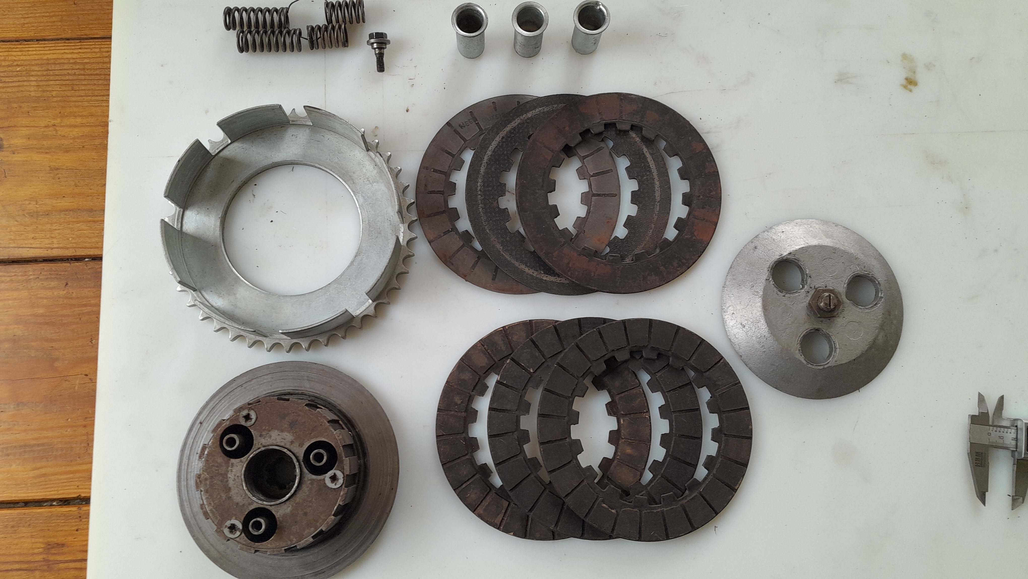

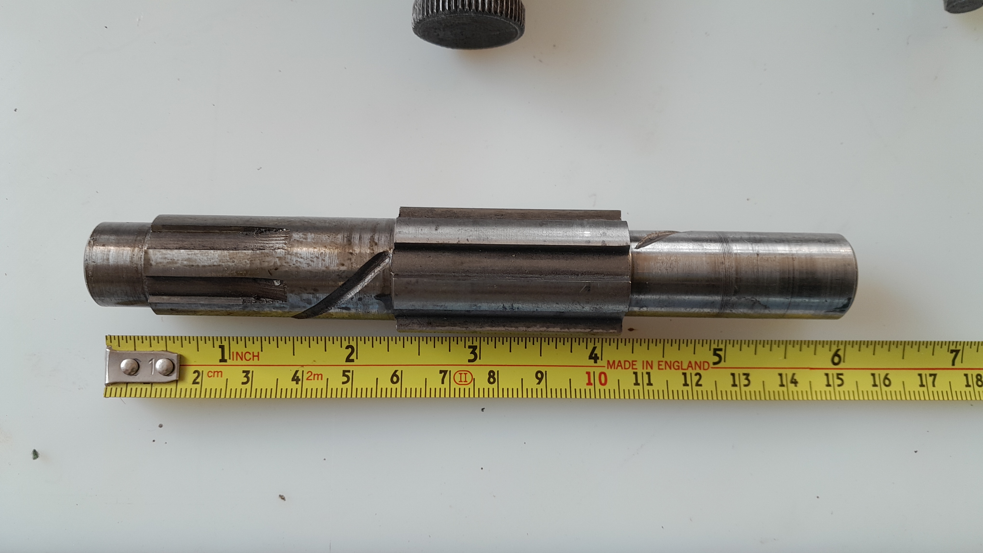

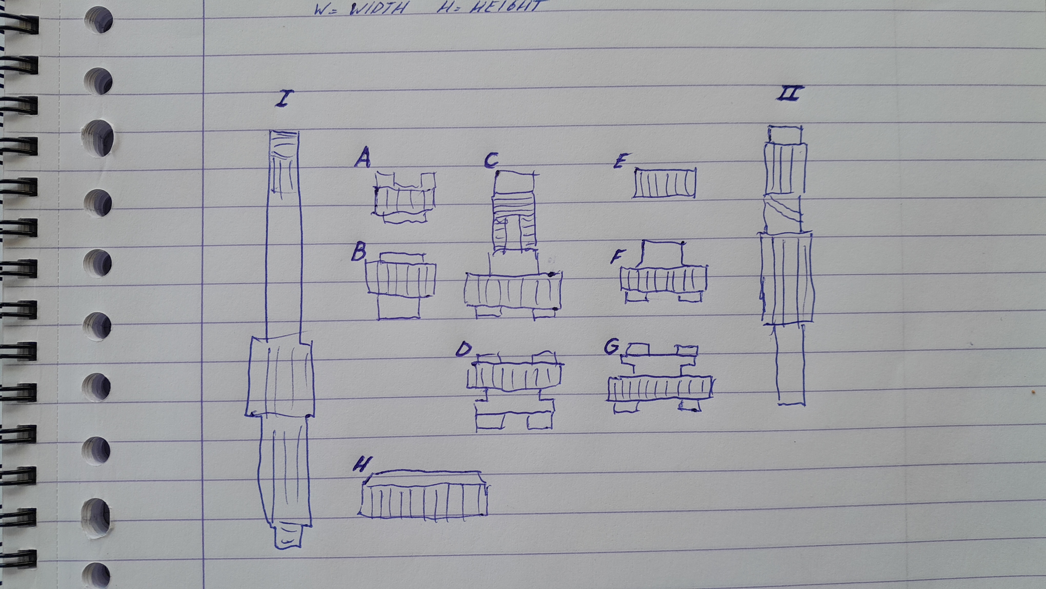

3. Measurements and photos. Lots of them!
Regarding the latter. To measure is to know and one photo could say more than a thousand words. I've added some examples below. Regarding measurements: be as complete as possible.
