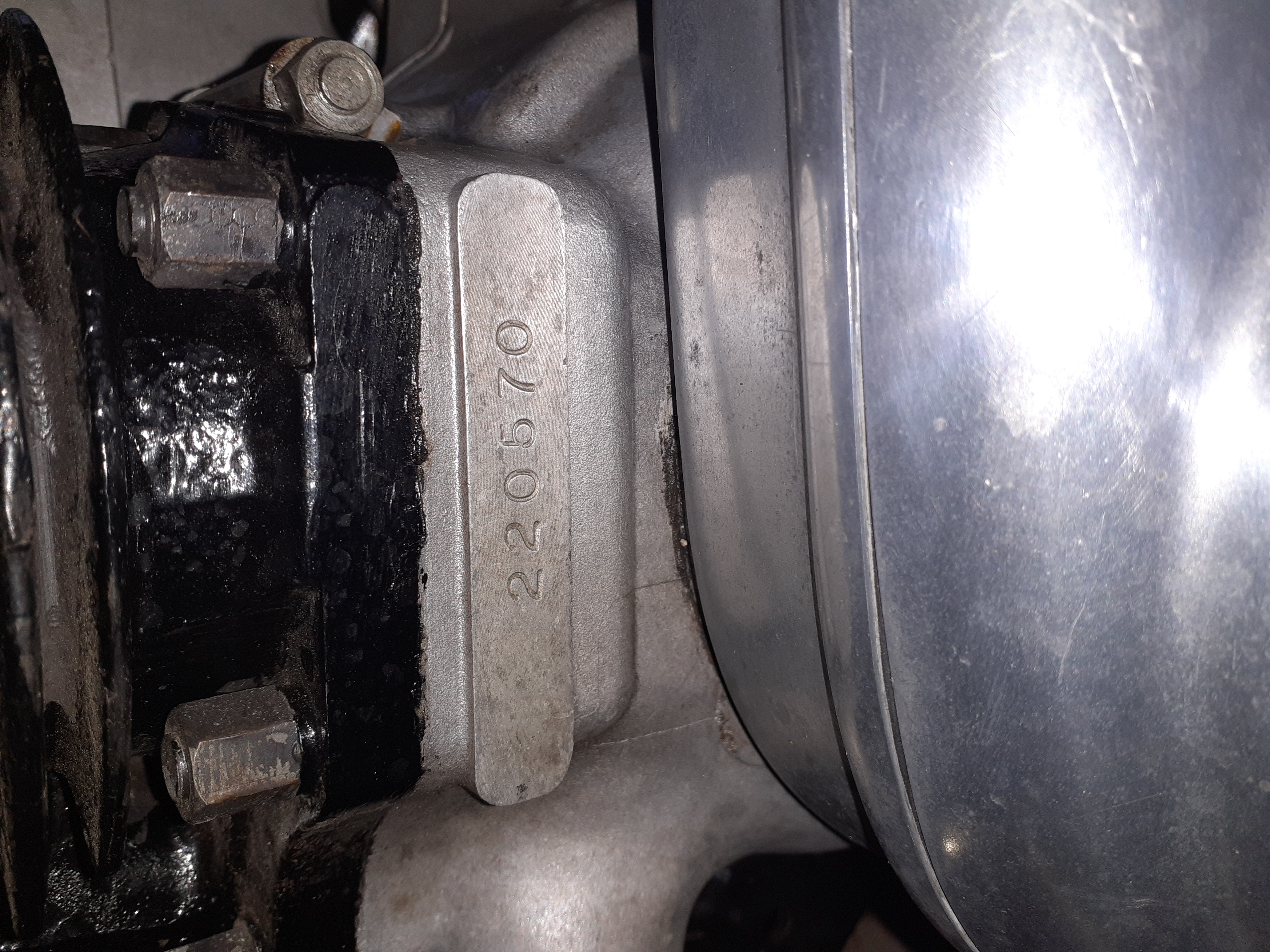

Hi all, I bought a 73 Commando, my 5th Norton, matching engine, frame and gearbox numbers 220570. It was brought back into this country in '83 from, I presume, the US. Black barrels, head has H 6 teaped into it. There might be something before this though. To cut to the point, there's a LOT of side play in the camshaft. Must be a good quarter inch at least.. Funny thing is, the engine runs as sweet as a nut. anyone any info on camshaft side play?
I've included a couple of photos. Cheers!

The H6 seems to have a very faint "R" to the left. RH6 is a semi high compression 32mm port head,
Squish band is about .100" deep (semi combat)
see here: http://atlanticgreen.com/nhth.htm
I have a 73  220xxx engine/head a few hundred after yours, with a "5" that does not have the RH but the number is in the same spot. full squish band .120" deep. is standard compression  32mm ports.
Your cam, no NHT, should have over about .030" (3/4mm) of end play. 1/4" no way, no how......
