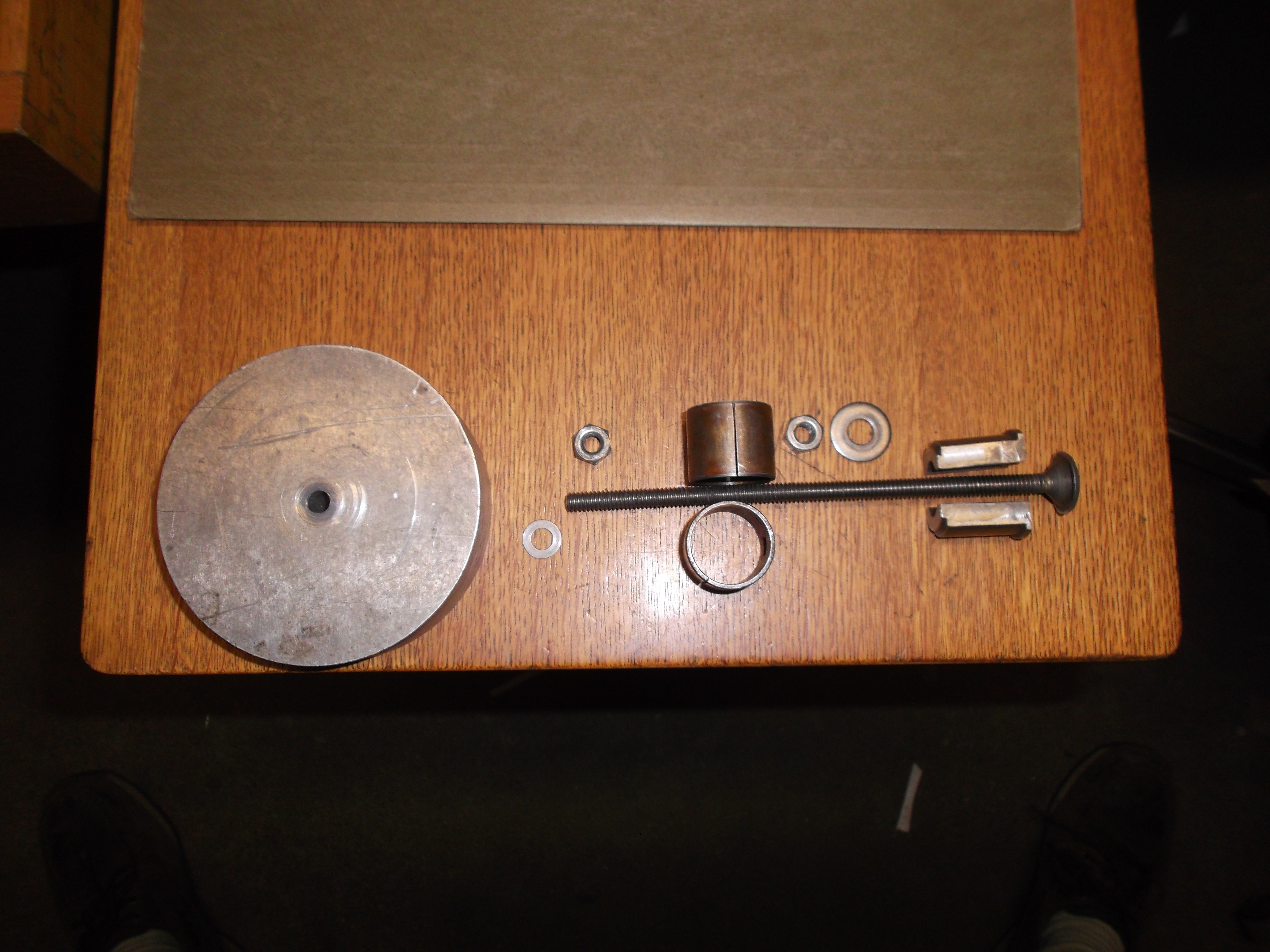

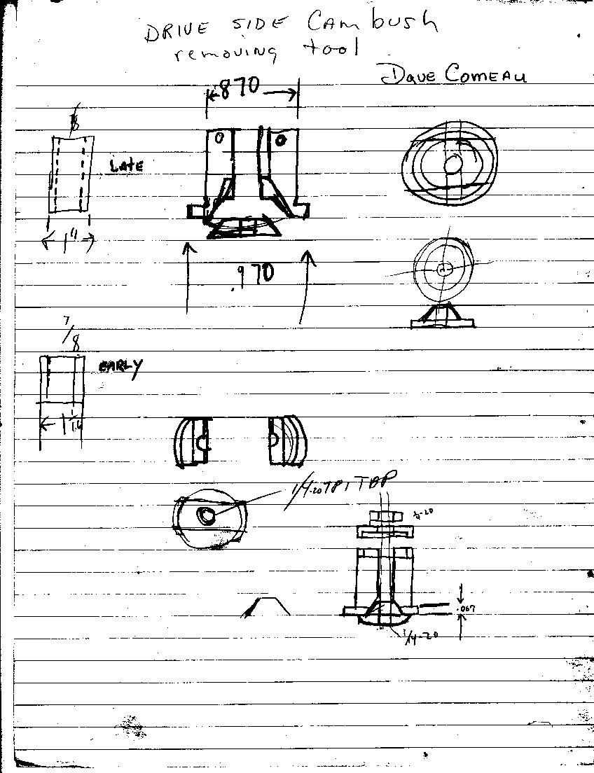

Here are pix of my cam bush tool. Significant time to design, make all components, but now a breeze to pull out a bush and it is not damaged. Works on both early, up to 20M3S, thick bushes and late, 200000 on, thin bushes. Been using this for well over 20 years.
