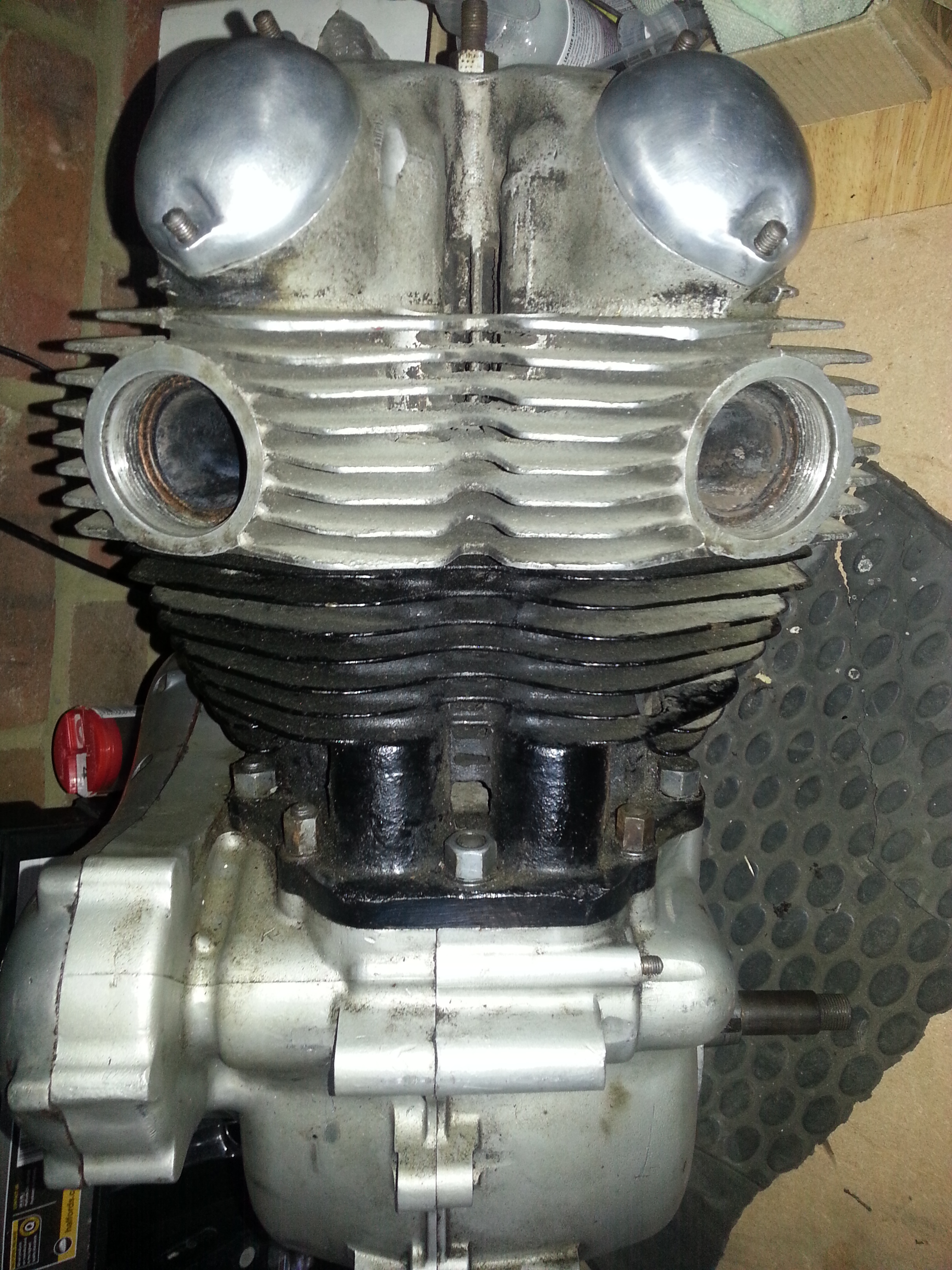

One fin on each barrel Atlas and Dominator is chipped where, or has anyone got some cast iron pieces for repairs?

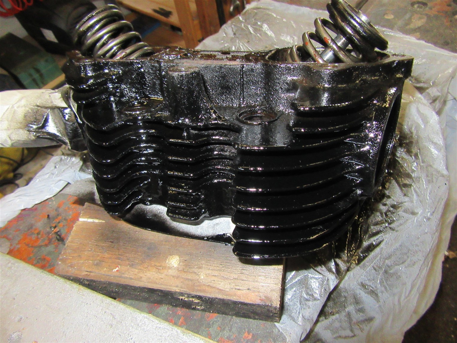

Going back to cast iron fins. I had great success repairing broken fins on three sets of barrels using Disimilar Metals welding rods with an Arc set. The only issue being the weld join material is really hard and not easy to file. See attachments but don't shout at me for leaving the followers in place.

The Fin is the second one up from the bottom of the barrel on the right-hand side looking from the front and difficult to get to, but not impossible, I suppose!
On the Atlas barrel it's the top fin!
