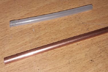

As I posted a while ago in the Heavy twins section, I have a 'BAP' type tap (From Hitchcocks, the Enfield people) on my Dommie, but it was effectively hidden behind the frame tube. My fix was to move the tap down using some plumbing fittings,. To provide the 'reserve' supply, I needed to extend the 'main' feed tube upwards. I bought some thin walled 4mm copper tube from a model shop and cut it 35mm longer than the original ‘main' feed pipe and with a light “tap” it was solidly in the fuel tap. I may have been lucky in that the Indian made tap I have used 4mm plastic tube, or maybe they all do?
pipes
